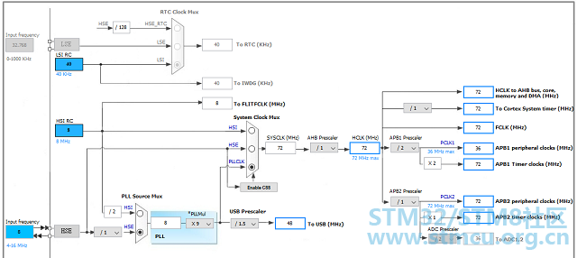

我有個類似的問題,也想請教.
我想知道在GPIO "Maximum output speed"的low,Medium,High 對於GPIO的輸出頻率,所以用STM32CubeMX,在main()的while()只加一行,Keil uVision5 Download後,GPIOA5可以量到輸出,但要再次download就出現"No targe connected"
int main(void)
  while (1)
HAL_GPIO_TogglePin(GPIOA,GPIO_PIN_5);
Clock Configuration
Clock Configuration
