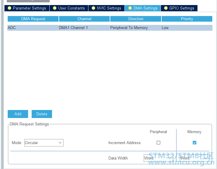

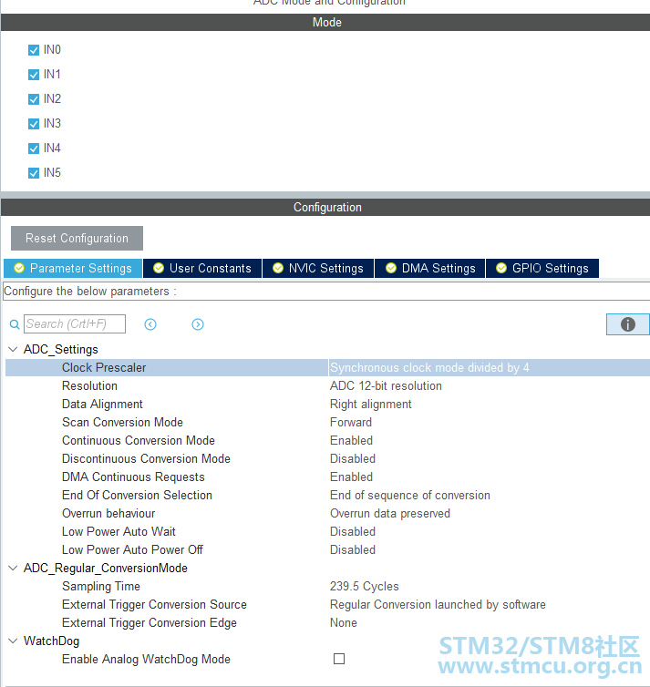

我用的是STM32F030使用多通道DMA采集,发现F0芯片使用cubemx配置跟F1一样的,但是就是读值全都不对,原来F1没有遇到过这种问题,有用过的大神看下配置上有什么需要改的吗?之前有个帖子说自己添加通道,我也添加过了读值还是不对,只配置一个通道设置跟多通道一模一样读值就正确的,应该就是多通道添加有问题。 void MX_ADC_Init(void) { ADC_ChannelConfTypeDef sConfig = {0}; /** Configure the global features of the ADC (Clock, Resolution, Data Alignment and number of conversion) */ hadc.Instance = ADC1; hadc.Init.ClockPrescaler = ADC_CLOCK_SYNC_PCLK_DIV4; hadc.Init.Resolution = ADC_RESOLUTION_12B; hadc.Init.DataAlign = ADC_DATAALIGN_RIGHT; hadc.Init.ScanConvMode = ADC_SCAN_DIRECTION_FORWARD; hadc.Init.EOCSelection = ADC_EOC_SEQ_CONV; hadc.Init.LowPowerAutoWait = DISABLE; hadc.Init.LowPowerAutoPowerOff = DISABLE; hadc.Init.ContinuousConvMode = ENABLE; hadc.Init.DiscontinuousConvMode = DISABLE; hadc.Init.ExternalTrigConv = ADC_SOFTWARE_START; hadc.Init.ExternalTrigConvEdge = ADC_EXTERNALTRIGCONVEDGE_NONE; hadc.Init.DMAContinuousRequests = ENABLE; hadc.Init.Overrun = ADC_OVR_DATA_PRESERVED; if (HAL_ADC_Init(&hadc) != HAL_OK) { Error_Handler(); } /** Configure for the selected ADC regular channel to be converted. */ sConfig.Channel = ADC_CHANNEL_0; sConfig.Rank = ADC_RANK_CHANNEL_NUMBER; sConfig.SamplingTime = ADC_SAMPLETIME_239CYCLES_5; if (HAL_ADC_ConfigChannel(&hadc, &sConfig) != HAL_OK) { Error_Handler(); } /** Configure for the selected ADC regular channel to be converted. */ sConfig.Channel = ADC_CHANNEL_1; if (HAL_ADC_ConfigChannel(&hadc, &sConfig) != HAL_OK) { Error_Handler(); } /** Configure for the selected ADC regular channel to be converted. */ sConfig.Channel = ADC_CHANNEL_2; if (HAL_ADC_ConfigChannel(&hadc, &sConfig) != HAL_OK) { Error_Handler(); } /** Configure for the selected ADC regular channel to be converted. */ sConfig.Channel = ADC_CHANNEL_3; if (HAL_ADC_ConfigChannel(&hadc, &sConfig) != HAL_OK) { Error_Handler(); } /** Configure for the selected ADC regular channel to be converted. */ sConfig.Channel = ADC_CHANNEL_4; if (HAL_ADC_ConfigChannel(&hadc, &sConfig) != HAL_OK) { Error_Handler(); } /** Configure for the selected ADC regular channel to be converted. */ sConfig.Channel = ADC_CHANNEL_5; if (HAL_ADC_ConfigChannel(&hadc, &sConfig) != HAL_OK) { Error_Handler(); } } 这个是添加通道设置 void init_ADCRank(void) { ADC_ChannelConfTypeDef sConfig; sConfig.Channel = ADC_CHANNEL_1; sConfig.Rank = ADC_RANK_CHANNEL_NUMBER; sConfig.SamplingTime = ADC_SAMPLETIME_239CYCLES_5; HAL_ADC_ConfigChannel(&hadc, &sConfig); sConfig.Channel = ADC_CHANNEL_2; sConfig.Rank = ADC_RANK_CHANNEL_NUMBER; sConfig.SamplingTime = ADC_SAMPLETIME_239CYCLES_5; HAL_ADC_ConfigChannel(&hadc, &sConfig); sConfig.Channel = ADC_CHANNEL_3; sConfig.Rank = ADC_RANK_CHANNEL_NUMBER; sConfig.SamplingTime = ADC_SAMPLETIME_239CYCLES_5; HAL_ADC_ConfigChannel(&hadc, &sConfig); sConfig.Channel = ADC_CHANNEL_4; sConfig.Rank = ADC_RANK_CHANNEL_NUMBER; sConfig.SamplingTime = ADC_SAMPLETIME_239CYCLES_5; HAL_ADC_ConfigChannel(&hadc, &sConfig); sConfig.Channel = ADC_CHANNEL_5; sConfig.Rank = ADC_RANK_CHANNEL_NUMBER; sConfig.SamplingTime = ADC_SAMPLETIME_239CYCLES_5; HAL_ADC_ConfigChannel(&hadc, &sConfig); } ![]() |

源端、目的端是否都是DMA可以访问到的
uint32_t AD_Value[N][M]; //用来存放ADC转换结果,也是DMA的目标地址,每通道采N次,M为通道数
HAL_ADC_Start_DMA(&hadc, *AD_Value, N);
带宽大小都一样的啊
用CubeMX生成的ADC初始化代码是:
如果所有通道转换速率相同,
则
于是下面紧跟的其他通道都默认上面的设置。
然后需要:
HAL_ADC_Start_DMA(&hadc1, (uint32_t *)&ADC_Value, ADC_Number*ADC_Channel);
才能启动ADC读数据。每次DMA传输的数据是转换次数×ADC通道数,保存在ADC_Value[]数组中。
谢谢大神,原来是转换次数×ADC通道数那个地方没设置对,太感谢了
是的就是这里的问题,应该是单通道采集次数*通道数
