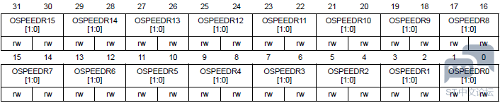

0 @1 }. _9 N( }* w! Y2.1 设置输出频率(OSPEEDR), V$ d+ r8 @  V6 S" B4 \
( H( R. I0 S, j. d5 |
* z) q4 ^# L$ `) G
! E& K$ `5 r. @8 o每2个位配置一个Pin。默认是2MHz。: q3 W  d+ a2 W% y# f- B7 \( S3 m
$ S  O. {. V. t7 B; b
0b00, 0b10: 2MHz
5 y( T- C7 s" d. h9 w. D9 b! ~8 b& @+ u" H& R* D) x
0b10: 10MHz) J- d% a+ K. F( z+ b7 p
  O9 i0 O8 O7 l' V$ {" K1 b0 v8 r1 }0b11: 50MHz* a4 f# {( Y6 v& r, l( c* n# F
5 f3 z8 D( {' H, K
  1. typedef enum
    1 b" I! N' A  g; G0 r3 M2 s9 Q
  2. {- @# g) t2 {0 N5 V4 Q: _8 M
  3.   GPIO_Speed_Level_1  = 0x00, /*!< I/O output speed: Low 2 MHz */6 N& ?0 f, @4 b( I7 g
  4.   GPIO_Speed_Level_2  = 0x01, /*!< I/O output speed: Medium 10 MHz */
    2 s) d/ [+ c9 F. U# [. H* P
  5.   GPIO_Speed_Level_3  = 0x03  /*!< I/O output speed: High 50 MHz */0 ?* D# t5 m8 e1 d1 v8 t/ u6 Y
  6. }GPIOSpeed_TypeDef;
    2 D& P8 H5 }/ |. s6 u$ d
  7. " h+ b: W8 h7 a* \7 J( d
  8. #define GPIO_Speed_2MHz  GPIO_Speed_Level_1   /*!< I/O output speed: Low 2 MHz  */
    ' _# C$ O/ I. z8 d  a
  9. #define GPIO_Speed_10MHz GPIO_Speed_Level_2   /*!< I/O output speed: Medium 10 MHz */
    ) r- q' `  q8 g! S% r7 M. p( R/ m; I, P
  10. #define GPIO_Speed_50MHz GPIO_Speed_Level_3   /*!< I/O output speed: High 50 MHz */
1 [# u: H* B1 q" m% i1 z8 M例如A9、A10都为50MHz:
" y% ^% L* Z4 Z# ]0 ?6 R  p/ \6 Q% f/ {7 H
  1. GPIOA->OSPEEDR |= (0x0000000F << (9 * 2));

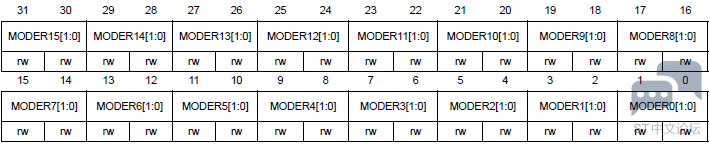

3 A( S6 I4 w+ C  a4 R3 t5 s4 \2.2 配置输入输出(MODER)
5 y( D5 ^* u/ [. ^4 u
6 Z0 I! ^5 a, s8 l
4 X: C% t( @) \- |0 R: S9 s
# w" E, O( P2 M( ^, E8 v2 i  f每2个位配置一个Pin。 默认Input(除了SWD的A13,A14)8 Q3 o7 K, B% ]" `! V
6 A! ?- F9 z7 r* k3 z, q
0b00: Input! O9 S$ r/ F% |, x4 P
0 q1 u* X/ H/ ^0 i. g0b01: Output
* t5 z; T  T# i3 R. @4 Z% Q( _! ]8 l) n1 Q: |! Z% r
0b10: AF
& |. @" D9 V( v! k" B1 @6 c2 n0 U4 t* z( H" w, @
0b11: Analog In/Out# o5 ?2 m  G, g
; H" S5 m4 k  `% n) U
  1. typedef enum3 k, e/ _4 x; }5 n5 c/ m% e
  2. {0 h8 e  ~4 m& l6 H' h5 {
  3.   GPIO_Mode_IN   = 0x00, /*!< GPIO Input Mode              */
    0 u/ W1 I: P/ ^& A
  4.   GPIO_Mode_OUT  = 0x01, /*!< GPIO Output Mode             */
    * u8 w# p% T) D" Z5 T( U6 ~
  5.   GPIO_Mode_AF   = 0x02, /*!< GPIO Alternate function Mode */
    8 \5 S: S7 f, W* [
  6.   GPIO_Mode_AN   = 0x03  /*!< GPIO Analog In/Out Mode      */
    - B# s" s+ Y- D8 }' N- L
  7. }GPIOMode_TypeDef;
% T6 _! y0 N5 b6 g) I
例如GPIOA9,GPIOA10为AF:0 M  V! o9 s4 n- f( n' m" |
  1. GPIOA->MODER |= ((uint32_t)GPIO_Mode_AF << (9 * 2)) | ((uint32_t)GPIO_Mode_AF << (10 * 2));
7 H$ _( E1 A- j& H( u  u& U

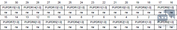

2.4 配置上下拉模式(PUPDR)4 h$ n/ K9 q! c" X/ e' v! s, q/ a
" B( |0 X$ e7 }
* b& M/ K7 ?+ E5 Y7 i) ]" C6 k8 h' v" C. h
每2个位表示上下拉模式。5 s/ y1 c; }( O. q/ b0 Y
  1. typedef enum
    ) ?. O% A* J6 r3 O
  2. {6 P1 V9 o; U- `+ G2 _% J+ W
  3.   GPIO_PuPd_NOPULL = 0x00,
    6 ], D* `7 e1 R6 C* Z! m) B
  4.   GPIO_PuPd_UP     = 0x01,9 H8 T9 z, d" \& X
  5.   GPIO_PuPd_DOWN   = 0x02
    ' f, x- A0 g) ~; ^; f% p
  6. }GPIOPuPd_TypeDef;
, C2 D& e5 ^4 o4 y) P! v+ G$ Z
例如:
, j9 b- Q; q5 N! b
  1. GPIOA->PUPDR &= ~((0x00000003 << (9 * 2)) | (0x00000003 << (10 * 2)));
