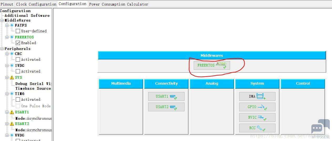

1.Pinout 中使能 FreeRTOS
2 \6 w6 f- V* ]) z: o1 }5 @& i7 h* l+ N4 a3 k
) y8 b! Y8 W. r9 Z

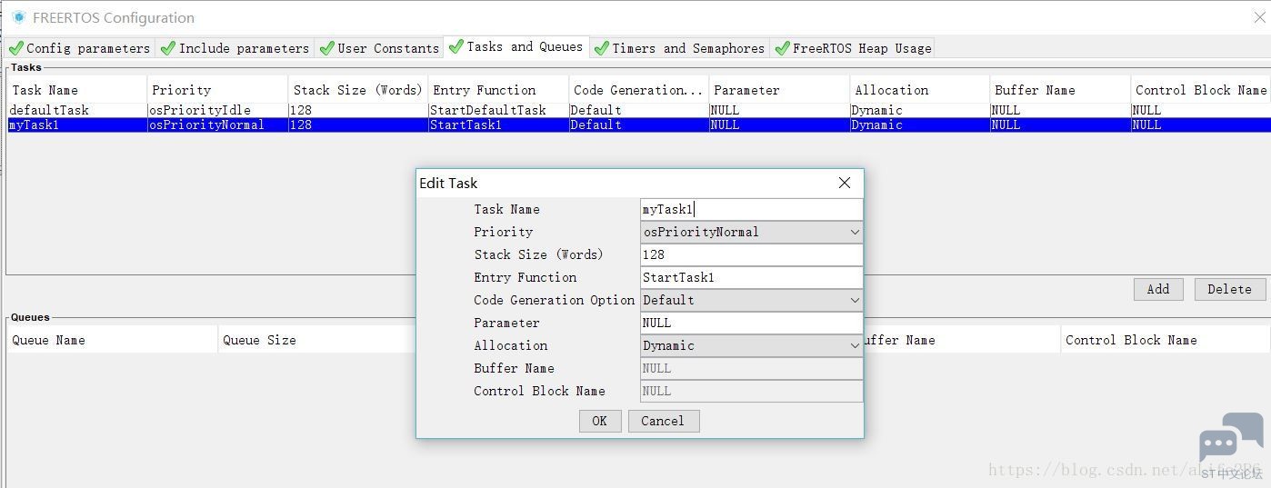

% Q2 S  \$ x# e# |, k8 C. }2.Configuration 中配置 FreeRTOS
- x9 m2 g1 p6 G! W4 W! J
1 A! y% m5 G5 D
6 w. @6 H# W/ v% H3.添加任务0 v% \. }4 ~  ^& [
1 B  [( u' T0 C1 w+ R% W( T! {' u% y8 C
+ J+ x5 S$ H$ z
( w+ \  I0 t4 X6 L4 R. J, I: i4.生成代码* C: s5 e3 P+ u- w# Z% e
# G4 A! ]3 P/ Y. e, N8 j

STM32CubeMX 定义的任务句柄
3 F5 g* t6 S2 R. Q. {! A* @
  1. osThreadId defaultTaskHandle;        /* 缺省的空闲任务句柄 */6 p8 g) Z6 {! Y
  2. osThreadId myTask1Handle;          /* 我需要的 myTask 1 任务句柄 */
0 o4 e+ i4 ~( J% Q
STM32CubeMX 声明的任务函数原型) N$ _' w+ _/ q/ l# Y( S
  1. void StartDefaultTask(void const * argument);' k) r# ~& Y1 k( V
  2. void StartTask1(void const * argument);
* A/ l& }3 h! m, t1 E) QSTM32CubeMX 定义和创建的任务$ Y, u( Y4 Z" K& H$ j
  1.   /* definition and creation of defaultTask */: I- |( z) v4 `
  2.   osThreadDef(defaultTask, StartDefaultTask, osPriorityIdle, 0, 128);   7 L8 Z: y! V9 s8 N2 X$ D
  3.   defaultTaskHandle = osThreadCreate(osThread(defaultTask), NULL);8 w: q) u) {. R7 I
  4. + }# |, b7 ]0 p/ s( Z
  5.   /* definition and creation of myTask1 */5 z: f# H  w5 o1 w2 O! C+ u
  6.   osThreadDef(myTask1, StartTask1, osPriorityNormal, 0, 128);8 `( z- A1 U+ L: l# F5 K
  7.   myTask1Handle = osThreadCreate(osThread(myTask1), NULL);. D  o5 I& z  O) L! F
  s# S& C/ k" B; N2 ?7 Q

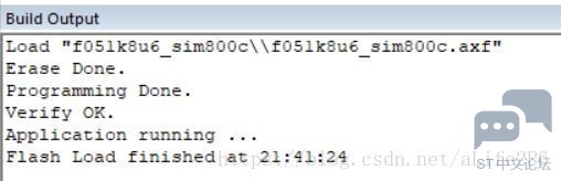

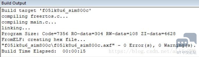

编译链接 Project/Build Target
" U! r/ V/ N8 U" L4 U# o% ^, A& |+ z& L6 G# f8 A
4 W# g2 t$ K* `$ o+ M. M/ q
- J" n/ M; U% N6 {+ l4 o烧录程序 Flash/Download. G. F* n; H' L* u7 c$ e+ L
6 i! Y* O; k4 j, }* @
; t9 |4 M( _, W: w
8 N1 E5 j3 D& b- `) r9 B2 v: d

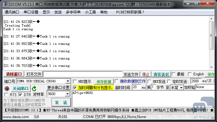

运行效果! Z) K* L  v/ h. Q# {7 Q+ h6 ?* x
7 g0 X- \4 `) z. {* o
$ ~# l' F& I/ p5 A( m9 _1 x4 O
. C7 i' Z' H9 Z0 `# n; Z9 ~
3 u3 Q3 X; [5 r) N0 l
