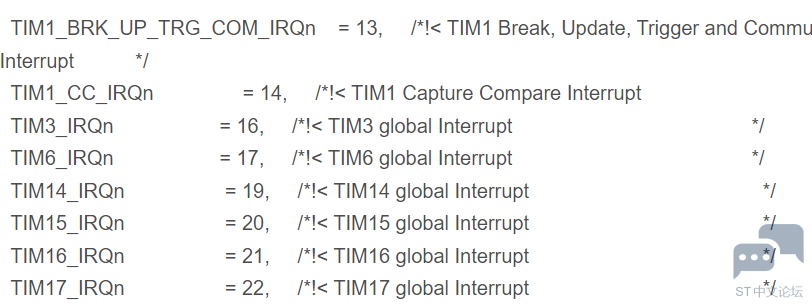

1)STM32F0有多个定时器,对应多个IRQn
1 ]( W+ l5 a. O1 L  A- c' @8 y0 t
  1. TIM1_BRK_UP_TRG_COM_IRQn    = 13,     /*!< TIM1 Break, Update, Trigger and Commutation Interrupt           */% P* u( H: b& e# V$ Z! t1 C
  2.   TIM1_CC_IRQn                = 14,     /*!< TIM1 Capture Compare Interrupt                                  */
    0 j4 q9 q( V9 ~) N- o2 ~
  3.   TIM3_IRQn                   = 16,     /*!< TIM3 global Interrupt                                           */
    0 [. z1 \! @- G1 X4 N
  4.   TIM6_IRQn                   = 17,     /*!< TIM6 global Interrupt                                           */8 m( ?: N8 c- q
  5.   TIM14_IRQn                  = 19,     /*!< TIM14 global Interrupt                                          */: v" ~, I0 }  g  e
  6.   TIM15_IRQn                  = 20,     /*!< TIM15 global Interrupt                                          */
    & v  s0 p$ \7 O5 k; ?  y3 f) Z
  7.   TIM16_IRQn                  = 21,     /*!< TIM16 global Interrupt                                          */
    , c" n- N1 h) N' j/ a
  8.   TIM17_IRQn                  = 22,     /*!< TIM17 global Interrupt                                          */
) W6 E( M# C0 B% _: c% k  a
