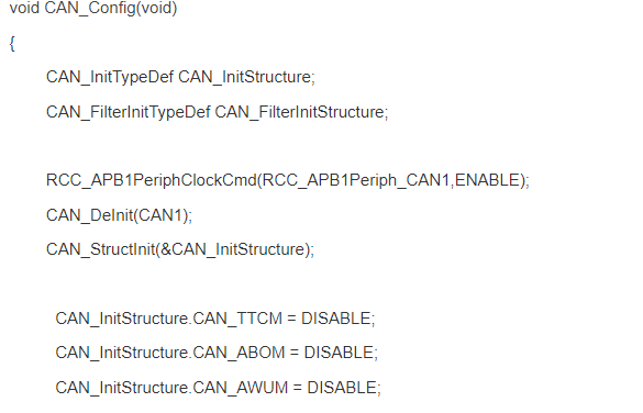

CAN通信是STM32中比较复杂的东西之一,它 的初始化主要分为两个部分,一个是CAN的初始化,一个是过滤器的初始化。自发自收只需要一个器件,CAN的模式选择回环(Loopback)模式,这种模式下发出的数据也会被CAN本身接收回来,只需要检查接收到的数据和发送的数据是否一样,就能测试发送是否成功。: e' t6 g. v: T# L7 l9 W' j
代码:
  q8 H# I  q, @( w7 u8 g
  1. void CAN_Config(void)
    7 @& G# h2 v0 @8 \- S& X
  2. {' D; x4 S! p) ^
  3.         CAN_InitTypeDef CAN_InitStructure;
    4 h( `8 x. F; e
  4.         CAN_FilterInitTypeDef CAN_FilterInitStructure;
    ! D$ u' G/ x1 C" [, R6 p
  5. 5 k; G1 r: A. s" ^, |; O$ T) h. O: U/ z
  6.         RCC_APB1PeriphClockCmd(RCC_APB1Periph_CAN1,ENABLE);7 g1 S) V6 E: c3 ]9 {
  7.         CAN_DeInit(CAN1);
    # B8 E" j" K# g2 @; t( ~8 _0 |
  8.         CAN_StructInit(&CAN_InitStructure);
      ^6 m: b; k; N' X. `0 {& g
  9. % K0 G. U  y+ U' Z- t
  10.           CAN_InitStructure.CAN_TTCM = DISABLE;
    ) M- H  }* v" r
  11.           CAN_InitStructure.CAN_ABOM = DISABLE;2 E7 U" R, T3 H, s+ I' R- q: }
  12.           CAN_InitStructure.CAN_AWUM = DISABLE;" `- K  s) y' t; T8 j0 |5 k
  13.           CAN_InitStructure.CAN_NART = DISABLE;; g& v; {- G# F' E
  14.           CAN_InitStructure.CAN_RFLM = DISABLE;
    / m9 {5 u, c" Q- [3 o' G( o2 [
  15.           CAN_InitStructure.CAN_TXFP = DISABLE;
    ' \. k( _. C3 k" N# ^. }; u
  16.         CAN_InitStructure.CAN_Mode=CAN_Mode_LoopBack;//回环模式5 T& F  ?6 R2 T0 x6 B0 Y7 M' E  M6 ~7 m6 K
  17.         CAN_InitStructure.CAN_SJW=CAN_SJW_1tq;//1
    $ z: Z! D4 v3 c$ L9 _
  18.         CAN_InitStructure.CAN_BS1=CAN_BS1_9tq;//9" |% d' t, }& w( v% w8 x5 t
  19.         CAN_InitStructure.CAN_BS2=CAN_BS2_8tq;//8; t4 P% Q! ]4 c5 K9 V% i. x
  20.         CAN_InitStructure.CAN_Prescaler=16;//16分频/ \: q/ Y2 x* [+ j; h9 C
  21.         CAN_Init(CAN1,&CAN_InitStructure);
    3 m, u' G5 E. a! O
  22. 9 n+ C3 T3 z, i) m/ Q( C9 a. `
  23.         CAN_FilterInitStructure.CAN_FilterNumber=0;& X. ^( I- m% n6 T1 ?) C
  24.         CAN_FilterInitStructure.CAN_FilterMode=CAN_FilterMode_IdMask;//屏蔽模式  d; P) `- H/ }4 b( Z/ _
  25.         CAN_FilterInitStructure.CAN_FilterScale=CAN_FilterScale_32bit;, b1 Z1 ]0 y  A
  26.           CAN_FilterInitStructure.CAN_FilterIdHigh = 0x0000;
    * D+ Y9 d- C7 B) K$ d. Q, b
  27.           CAN_FilterInitStructure.CAN_FilterIdLow = 0x0000;
    9 b; n# T8 o4 Z, P( u% _
  28.           CAN_FilterInitStructure.CAN_FilterMaskIdHigh = 0x0000;, x9 j8 E" N8 h4 t8 c+ Z  u1 Z
  29.           CAN_FilterInitStructure.CAN_FilterMaskIdLow = 0x0000;
      |# {8 ^7 a, b5 G7 I. p6 m
  30.           CAN_FilterInitStructure.CAN_FilterFIFOAssignment = CAN_FilterFIFO0;3 `1 G9 A! @$ D3 j+ j
  31.           CAN_FilterInitStructure.CAN_FilterActivation=ENABLE;
    # x/ D0 Q3 n( g+ f/ ^+ ]9 h5 r
  32.           CAN_FilterInit(&CAN_FilterInitStructure);
    " A& n+ o4 }' M. z6 N$ I6 r" \
  33. }
