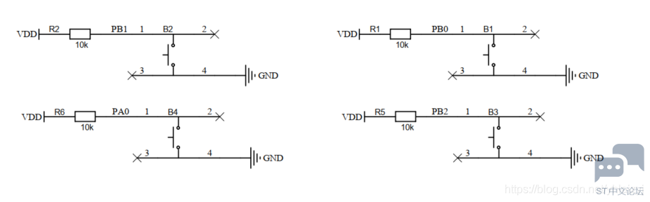

1.按键电路原理图
2 X) ]# ?: g3 G" t
; z6 Q& N% {6 X, v3 x- r
9 `$ Y# I$ Z7 {+ M8 W- u# d$ Y  p/ r7 R6 J8 Y- q' `
