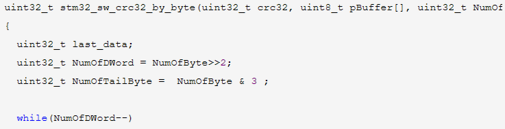

  56. uint32_t stm32_sw_crc32_by_bit(uint32_t crc32, uint8_t pBuffer[], uint32_t NumOfByte)
    7 s, q( [, ]4 C" a/ i
  57. {) e  }+ W8 r( j" `6 D
  58.   uint32_t last_data;
    ( C% Y. P0 l0 b) d  e
  59.   uint32_t NumOfDWord = NumOfByte>>2;
    5 w, c5 @+ B& c6 W! C( ^
  60.   uint32_t NumOfTailByte =  NumOfByte & 3 ;2 q9 \4 M7 O+ f# r$ p7 @! u
  61.   3 O: k7 u8 w* J* I9 S7 j, G: T
  62.   while(NumOfDWord--)  ~$ x8 l& r) b  N, n
  63.   {
    % U' I, s8 N$ v, }1 A
  64.     crc32 = crc32 ^ *((unsigned long *)pBuffer);
    1 n$ @: m- A0 ^6 e  _% K1 j  Y% ?
  65.     pBuffer += 4;
    . B! I$ I& l: E0 P' G
  66. 4 L4 W; e9 {8 t* |6 l  M) K; o
  67.     for(int i=0; i<32; i++)
    ) h* `2 J% G4 Y9 P( H
  68.     {) K1 d5 R! P3 b1 Z+ X7 I/ l  G
  69.       if (crc32 & 0x80000000)
    , t: p; [6 E2 o- u# S
  70.         crc32 = (crc32 << 1) ^ POLY_USED_IN_STM32;
    # _8 E) p/ x7 `8 V9 V/ d
  71.       else; Y: m. q9 }2 S  B* V0 {
  72.         crc32 = (crc32 << 1);
    / v6 }9 A! ~9 e5 i
  73.     }
    5 V9 d4 A/ N5 E6 N/ L; U- w$ B
  74.   }  ~* c8 o- K0 r4 _
  75.   : x6 I$ R1 m0 L' j1 @
  76.   switch ( NumOfTailByte )
    4 O$ V1 q; _9 Y" R
  77.   {
    ; J$ ?/ f; u" ]. e- k' f% F) G' ~# n
  78.     case 0:  o( [, n+ a/ c3 |
  79.       return crc32;
    3 _, z# V. q9 r2 ~8 ~# B
  80.     case 1:
    - E8 K; \9 R9 A7 C6 @+ [
  81.       last_data = pBuffer[0] << 24;
    ; C4 @5 G" W5 v; m7 m7 |
  82.       break;7 D3 l0 i4 u' r" A5 `
  83.     case 2:
    " {. u3 o* y% C& J$ O' o- s& j7 N
  84.       last_data = *( (uint16_t *)(&pBuffer[0]) );2 x, E0 E* T( d( ~
  85.       last_data <<= 16;2 |5 n; F- T' r5 ~, c+ ~
  86.       8 s( V% E' f2 h) T2 g9 Q) w
  87.       break;
    - A$ O1 p' M3 X
  88.     case 3:! F- G& h  L" c+ O* C6 S6 e% E) ~
  89.       last_data = *( (uint16_t *)(&pBuffer[0]) );
    ' l5 o& q, t$ a* t0 A, |
  90.       last_data <<= 8;
    . D, m( N6 ~( i( a# {
  91.       last_data += pBuffer[2]<<24;
    # G8 Z0 |; y$ F' K) D6 P& B
  92.       break;# H7 u: V* d/ Q3 \! b
  93.   }
    ! N6 J+ Q. ^8 e) ~# V! [
  94.   crc32 = stm32_sw_crc32_by_bit( crc32, (uint8_t *)&last_data, 4);, e7 s2 N% L! s8 I: E/ {
  95.   return crc32;. ^, n" j0 e! n2 \+ M& u
  96. }) c4 Z+ H# I$ C1 c- u6 ]
  97. % |; H; A3 N! ]. d7 j  p
  98. * `- ]" l4 i' A9 D$ ~3 F  z' Y
  99. // Nibble lookup table for 0x04C11DB7 polynomial
    8 l. u( W) s. u6 c4 Z+ n  w
  100. const unsigned long sw_crc32_by_nibble_table[16] = {: W: c2 a! n5 e( W# A7 \/ U
  101.   0x00000000,0x04C11DB7,0x09823B6E,0x0D4326D9,

  217. uint32_t stm32_sw_crc32_by_byte(uint32_t crc32, uint8_t pBuffer[], uint32_t NumOfByte)  ( B+ d) b# b, u1 v
  218. {
    % `' [2 Y; P, {& z% ^
  219.   uint32_t last_data;
    $ B2 t# u. n* |# J+ R) t" d: ?
  220.   uint32_t NumOfDWord = NumOfByte>>2;
    ! d5 g3 i, k) j$ Z: l; U. m
  221.   uint32_t NumOfTailByte =  NumOfByte & 3 ;# s$ Y0 d; F8 a* Q% y$ z& p. _
  222.
    , w2 U1 j0 H& L3 N& H' f
  223.   while(NumOfDWord--)
    ' _, V( |  G! x* D3 C( v3 @6 \
  224.   {# j0 r, R4 V1 e, M: b
  225.     crc32 = crc32 ^ *((unsigned long *)pBuffer);
    8 z. b% v& }2 n, Z
  226.     pBuffer += 4;  F' F  w- I2 n' s
  227.     crc32 = (crc32 << 8) ^ sw_crc32_by_byte_table[crc32 >> 24];
    " m& y: `9 T0 Z9 \3 a
  228.     crc32 = (crc32 << 8) ^ sw_crc32_by_byte_table[crc32 >> 24];, |& {! U" t1 S" _  }" z+ T3 A3 w
  229.     crc32 = (crc32 << 8) ^ sw_crc32_by_byte_table[crc32 >> 24];2 }8 h) f; P0 B6 ^* m1 c
  230.     crc32 = (crc32 << 8) ^ sw_crc32_by_byte_table[crc32 >> 24];
    % h: w# E6 N' Y2 H+ L) o& }  M
  231.   }
    + q: K  D1 x. \0 C1 ]+ Y5 G  t
  232.   9 I6 M5 W0 M& H
  233.   switch ( NumOfTailByte )
    0 [( N- I( c+ q" V% e
  234.   {
    1 S7 @( h6 E7 e+ H- r/ {
  235.     case 0:
    * h0 u6 n8 P5 L& q& c
  236.       return crc32;     1 i4 B( |( N, w  C
  237.     case 1:
    . Y6 {. D% W* L+ D: z
  238.       last_data = pBuffer[0] << 24;
    - G0 `0 a/ d' b# z' P* A8 x
  239.       break;5 i4 U/ M0 L  I, r8 C4 g3 n) [6 Y
  240.     case 2:
    - R% H$ `2 z2 l: q! S0 F
  241.       last_data = *( (uint16_t *)(&pBuffer[0]) );
    ( Z. l0 `- ?- u! [% o* v0 H
  242.       last_data <<= 16;* J; t. u6 R! Z/ B9 R5 g/ {
  243.
    9 Q3 F! T% S3 N' B
  244.       break;
    9 Y% j$ a9 l0 A/ h
  245.     case 3:
    + T3 }3 W- E1 J! v# L
  246.       last_data = *( (uint16_t *)(&pBuffer[0]) );
    " G. H# S8 x9 b+ p
  247.       last_data <<= 8;
    ) W: I5 W" u$ q3 J' b6 B
  248.       last_data += pBuffer[2]<<24;+ ^" p7 Z! K# _5 D
  249.       break;; ^1 \8 A  i& q& {3 Q& Q
  250.   }
    1 }+ e1 S. O5 k, P. S0 w, d
  251.   crc32 = stm32_sw_crc32_by_byte( crc32, (uint8_t *)&last_data, 4);  q* ]2 n7 W% W. W
  252.   return crc32;
    8 {7 y* [  s" A
  253. }
