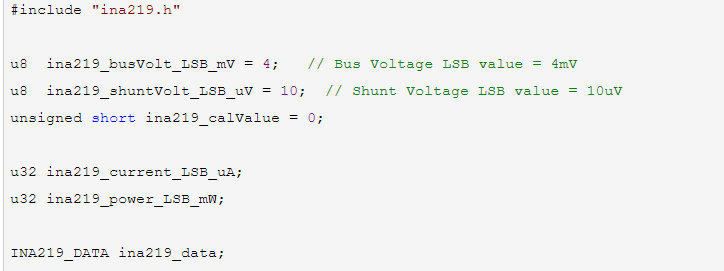

之前要做一个电量计,采用INA219电流检测芯片,参考了网上大神的代码后发现在STM32上可用,移植到STM8后不可用,后来找到了官方的示例demo,综合网上大神代码调试后成功驱动,测电流、电压、功率,精确度很高。
现在分享出来供大家参考,直接贴代码:

ina219.c
  1. #include "ina219.h"
    4 g: ~- ?1 O% n8 {
  2. 0 M, x; Z& n0 B+ j2 p) }' `5 Z
  3. u8  ina219_busVolt_LSB_mV = 4;   // Bus Voltage LSB value = 4mV1 p9 [/ d) P! r: u$ K
  4. u8  ina219_shuntVolt_LSB_uV = 10;  // Shunt Voltage LSB value = 10uV# \0 a: w) Y8 h" O
  5. unsigned short ina219_calValue = 0;6 Q( v# ]* \$ Z5 m8 ~% V* I
  6. 4 c# ~- a( M, b3 U. J, i7 `
  7. u32 ina219_current_LSB_uA;  ]& s2 s. G, `
  8. u32 ina219_power_LSB_mW;
    3 |  I4 _5 L* d/ n$ x1 q) P# W8 f; _
  9. 0 |2 b0 M( s' e9 q
  10. INA219_DATA ina219_data;# J, m7 x0 {5 D% {% L' {# T
  11. 9 K% j# N+ M7 q: L

    * p8 [4 h- l+ n7 Y1 J9 a% M
  438.   // reset the cal register, meaning CURRENT and POWER will
    1 H, O" \; r$ k7 _4 B7 B- w# {
  439.   // not be available ... avoid this by always setting a cal' t3 d6 h* q" |& S) X& T
  440.   // value even if it's an unfortunate extra step
    5 l/ ]# h3 |8 {) V/ J2 B' I$ k
  441.   ina219_Write_Register(INA219_REG_CALIBRATION, ina219_calValue);' Z5 b, q% Q- g
  442.   , C, s" g& \2 Y* n
  443.   // Now we can safely read the CURRENT register!; u- Z/ _' y$ J4 j' }
  444.   ina219_Read_Register(INA219_REG_CURRENT, ®);4 O$ R' x, [& b8 P) f
  445.
      f, W' [& g8 k: R  L- T! b& j
  446.   val = (s32)reg * ina219_current_LSB_uA;
    ; @" D* D/ p/ |* ]. q* e
  447.   ! l& N+ R* e0 [6 S* C
  448.   return (val);% \3 y1 H3 ]  v2 o% e9 u) R
  449. }
    4 [4 h3 c, B& H
  450. - e5 D# D# X6 j# L# G
  451. s32 ina219_GetPower_mW(void)
    ) T" \' A* i" b+ f6 C3 o
  452. {1 H3 e% A) [2 p* ?% d0 M
  453.   s32 val;
    7 q* p" j9 U5 t  n( e, `
  454.   s16 reg;# J3 l- Z- i3 K, u( `
  455.   5 o# g; w- n" x* k* X' a& R2 [
  456.   // Sometimes a sharp load will reset the INA219, which will) b  z6 p- u& k9 G2 s. N# f8 L' o
  457.   // reset the cal register, meaning CURRENT and POWER will4 F, c4 l4 x' u$ ~$ N& w- ?
  458.   // not be available ... avoid this by always setting a cal
    . K$ _% h* ~' w9 z7 E4 Z
  459.   // value even if it's an unfortunate extra step. k% @# z& }. x  |; U7 O/ L; P( R
  460.   ina219_Write_Register(INA219_REG_CALIBRATION, ina219_calValue);
    0 U/ Z5 [! z0 n9 |) u
  461.   , B; J; i( \* m/ c) K- v  t( A
  462.   // Now we can safely read the POWER register!9 o7 M  g. `" [, x8 |- s) W) z. N3 \5 A
  463.   ina219_Read_Register(INA219_REG_POWER, ®);
    / g3 Y+ q, l0 w) k8 Q
  464.
    + h( |5 a4 l7 _8 x
  465.   val = (s32)reg * ina219_power_LSB_mW;8 d" O8 M. b8 G/ E& Y9 w; N0 {
  466.   6 q' l4 L8 }: E/ W. h8 ~
  467.   return (val);
    ( U% n& `) ^5 s) N
  468. }8 b2 P7 {# |; A' g) g
  469. 2 M$ W- ^( L. y; \! I5 m. W- j/ x
  470. void INA_Process(void)
    0 g7 B! s: y- P/ r( ~
  471. {
    8 x$ L4 y) @, Z: f* h+ c3 [
  472.     if(INA219process_flag == Open)' N$ A3 y0 s8 T
  473.     {) E; J+ e. I3 ]8 ~$ r/ C* d: f
  474.         INA219process_flag = Close;
    ( X# r: D% x  ^. z
  475.         # J9 [: q' H/ Y3 w
  476.         ina219_data.voltage_ina219 = ina219_GetBusVoltage_mV();+ v( f$ P: \# ~; v! o$ S
  477.         printf("voltage_ina219 is %d\r\n",ina219_data.voltage_ina219);
    5 s5 u" Y. P) T5 ^
  478.
    0 v) q$ ~0 @' s, ^
  479.         ina219_data.shunt_ina219 = ina219_GetShuntVoltage_uV();
      W- H5 [2 I6 X" n
  480.         printf("shunt_ina219 is %ld\r\n",ina219_data.shunt_ina219);  P1 R$ L8 B- D2 ~+ ^$ d0 k% z. u3 ^
  481.
    " c1 t9 o" M' m6 o' y
  482.
    4 {0 [  j6 B1 F. z, B( p, q7 c, G
  483.         ina219_data.current_ina219 = ina219_GetCurrent_uA();, L9 [; n9 ^/ i
  484.         printf("current_ina219 is %ld\r\n",ina219_data.current_ina219);
    * n. {: J# Z) g  ^- V! O
  485.         1 O  I8 k0 e& l; ^9 m( J
  486.         ina219_data.power_ina219 = ina219_GetPower_mW();
    5 y4 B8 j6 Q1 Z* Y, n) }8 e
  487.         printf("power_ina219 is %ld\r\n",ina219_data.power_ina219);4 y, c- A* v. y( Y! z+ F" u; Y# M
  488.     }+ x; M& i0 }* O# F$ g( f
  489. }
: f, v/ _3 _9 z# L% q. a" [( B
ina219.h
  1. #ifndef __INA219_H! m. V2 Y  l- X1 ?2 l5 L
  2. #define __INA219_H
    & j6 k, d: G% y0 E  {
  3. #include "main.h"
    2 J/ s, D: H! I0 M2 f; N* I8 E
  4. " B/ k+ @5 \6 J7 s
  5. #define INA219_I2C_PORT                        GPIOB
    " d  A/ A: o3 x
  6. #define INA219_I2C_GPIO_CLOCK            RCC_APB2Periph_GPIOB
    $ ?& M* h$ }$ O* F& ]3 L
  7. #define INA219_I2C_SCL_PIN                GPIO_Pin_12/ v" \2 y2 J  m
  8. #define INA219_I2C_SDA_PIN                GPIO_Pin_14
    0 j% y+ w3 o8 {7 b
  9. & f( i& {& @: P  x# K; G& s
  10. #define INA_SCL_SET     GPIO_SetBits(INA219_I2C_PORT,INA219_I2C_SCL_PIN)! v7 z  V9 t+ Z: w% U! b
  11. #define INA_SDA_SET     GPIO_SetBits(INA219_I2C_PORT, INA219_I2C_SDA_PIN)& Z2 v# V* I/ B' l
  12. + w( I1 g" l/ R" p3 O4 e' p
  13. #define INA_SCL_CLR     GPIO_ResetBits(INA219_I2C_PORT,INA219_I2C_SCL_PIN)  ~& f8 J$ x3 x, R( ~
  14. #define INA_SDA_CLR     GPIO_ResetBits(INA219_I2C_PORT,INA219_I2C_SDA_PIN)
    . V) ~, w& g! o2 R% j
  15.   a& v! O1 u9 l1 A: C( |2 ]/ p& {
  16. #define INA_SDA_TST     GPIO_ReadInputDataBit(INA219_I2C_PORT,INA219_I2C_SDA_PIN)" p" u: n# [; j5 F. a+ h8 X  A$ l
  17. 3 `* l7 r* V* j4 f
  18. /*----------------------------------------------------------------------------*/9 {0 d  L5 u8 y
  19. // I2C Address Options9 X  i1 _& {% j; I' K
  20. #define INA219_I2C_ADDRESS_CONF_0               (u8)(0x40 << 1)     // A0 = GND, A1 = GND
    ! A- n0 {2 |# v# F3 R
  21. #define INA219_I2C_ADDRESS_CONF_1               (u8)(0x41 << 1)     // A0 = VS+, A1 = GND
    0 F  q4 L9 r& I8 Y. Y
  22. #define INA219_I2C_ADDRESS_CONF_2               (u8)(0x42 << 1)     // A0 = SDA, A1 = GND
      B5 j, }5 l1 x
  23. #define INA219_I2C_ADDRESS_CONF_3               (u8)(0x43 << 1)     // A0 = SCL, A1 = GND/ k3 u. f8 R5 `' U1 M
  24. #define INA219_I2C_ADDRESS_CONF_4               (u8)(0x44 << 1)     // A0 = GND, A1 = VS+- X/ k- o( p7 ]! R$ J
  25. #define INA219_I2C_ADDRESS_CONF_5               (u8)(0x45 << 1)     // A0 = VS+, A1 = VS+
    2 b! y& V( \) C, X/ |
  26. #define INA219_I2C_ADDRESS_CONF_6               (u8)(0x46 << 1)     // A0 = SDA, A1 = VS+
    4 h  q3 @+ N3 ^5 K* j
  27. #define INA219_I2C_ADDRESS_CONF_7               (u8)(0x47 << 1)     // A0 = SCL, A1 = VS+  R  U9 m0 @5 w( h6 \
  28. #define INA219_I2C_ADDRESS_CONF_8               (u8)(0x48 << 1)     // A0 = GND, A1 = SDA
    , O/ W. Z! U' ^  K/ S* ]
  29. #define INA219_I2C_ADDRESS_CONF_9               (u8)(0x49 << 1)     // A0 = VS+, A1 = SDA3 ^$ |3 X0 C- L  B
  30. #define INA219_I2C_ADDRESS_CONF_A               (u8)(0x4A << 1)     // A0 = SDA, A1 = SDA9 s# q. e9 N, Y9 U7 i9 M
  31. #define INA219_I2C_ADDRESS_CONF_B               (u8)(0x4B << 1)     // A0 = SCL, A1 = SDA
    ( {- F: w5 y& \1 }8 M4 C
  32. #define INA219_I2C_ADDRESS_CONF_C               (u8)(0x4C << 1)     // A0 = GND, A1 = SCL9 V/ {& P: z% q  w0 g
  33. #define INA219_I2C_ADDRESS_CONF_D               (u8)(0x4D << 1)     // A0 = VS+, A1 = SCL/ m2 i8 {. z& r7 v5 E
  34. #define INA219_I2C_ADDRESS_CONF_E               (u8)(0x4E << 1)     // A0 = SDA, A1 = SCL
    : `  {+ F& ~  [0 r* E9 u& b. O
  35. #define INA219_I2C_ADDRESS_CONF_F               (u8)(0x4F << 1)     // A0 = SCL, A1 = SCL
    5 w3 I2 ~, X5 q0 Q( E; W+ l
  36. #define INA219_I2C_ADDRESS                      INA219_I2C_ADDRESS_CONF_0
    ) C1 ~8 T1 l$ m6 }9 e3 z0 W
  37. , j" G+ {4 g4 P9 D' ~$ _
  38. : K5 O0 i+ H3 f# f+ Z& @. Q
  39. /*----------------------------------------------------------------------------*/, y1 |$ d" w- a5 U  a; @
  40. // Register Addresses0 m, _* R# g! B1 x
  41. #define INA219_REG_CONFIG                       (u8)(0x00)      // CONFIG REGISTER (R/W)
    ! X  W7 q2 x9 K
  42. #define INA219_REG_SHUNTVOLTAGE                 (u8)(0x01)      // SHUNT VOLTAGE REGISTER (R)# m7 r3 n. }/ r! Y+ g
  43. #define INA219_REG_BUSVOLTAGE                   (u8)(0x02)      // BUS VOLTAGE REGISTER (R)
    , `' f; G  T$ X4 q) Q0 T
  44. #define INA219_REG_POWER                        (u8)(0x03)      // POWER REGISTER (R)
    1 E3 V% P: l$ x% G9 |" o3 J0 p
  45. #define INA219_REG_CURRENT                      (u8)(0x04)      // CURRENT REGISTER (R)1 J, K$ V, Y8 `7 K( ]0 [% x8 n" n
  46. #define INA219_REG_CALIBRATION                  (u8)(0x05)      // CALIBRATION REGISTER (R/W)! }1 P4 |1 F; y+ c1 ]
  47. + `5 x, w5 c# x- g5 Y5 F. D% \' O
  48. $ M3 L/ `/ [7 N" ~
  49. /*----------------------------------------------------------------------------*/
    & {. g3 W# S' v
  50. // Macros for assigning config bits# u: r! K& D8 @( |6 o  N
  51. #define INA219_CFGB_RESET(x)                    (u16)((x & 0x01) << 15)     // Reset Bit( {/ Y8 u! V8 l* v4 j0 g
  52. #define INA219_CFGB_BUSV_RANGE(x)               (u16)((x & 0x01) << 13)     // Bus Voltage Range0 m! W3 R0 d4 j# k2 c
  53. #define INA219_CFGB_PGA_RANGE(x)                (u16)((x & 0x03) << 11)     // Shunt Voltage Range
    ' x$ g/ N' v* t% B
  54. #define INA219_CFGB_BADC_RES_AVG(x)             (u16)((x & 0x0F) << 7)      // Bus ADC Resolution/Averaging
    ) n5 O- R% H8 C* _9 i  P' K
  55. #define INA219_CFGB_SADC_RES_AVG(x)             (u16)((x & 0x0F) << 3)      // Shunt ADC Resolution/Averaging
    4 e3 x  @5 j( X- l& q9 n
  56. #define INA219_CFGB_MODE(x)                     (u16) (x & 0x07)            // Operating Mode2 h, \6 K2 S+ A' L4 c9 U' Y
  57. & O( P6 }. N1 ^. N
  58. 9 k# U3 [, b, p
  59. /*----------------------------------------------------------------------------*/3 A2 `+ [; U. d: K2 c. x
  60. // Configuration Register* k4 S7 k/ B. m2 d! ~' `0 h
  61. #define INA219_CFG_RESET                        INA219_CFGB_RESET(1)            // Reset Bit
    , G# ?6 ?8 G6 h
  62. $ p8 V2 `; {# j. Q* D* k% q
  63. #define INA219_CFG_BVOLT_RANGE_MASK             INA219_CFGB_BUSV_RANGE(1)       // Bus Voltage Range Mask
    3 G7 P! }$ s+ z  t. D
  64. #define INA219_CFG_BVOLT_RANGE_16V              INA219_CFGB_BUSV_RANGE(0)       // 0-16V Range
    % A/ Z8 K" c- y8 S3 a
  65. #define INA219_CFG_BVOLT_RANGE_32V              INA219_CFGB_BUSV_RANGE(1)       // 0-32V Range (default)- r% {8 h4 J  S  Q( b2 [( g
  66. ! @7 G6 Y7 T4 L. z! A. x
  67. #define INA219_CFG_SVOLT_RANGE_MASK             INA219_CFGB_PGA_RANGE(3)        // Shunt Voltage Range Mask' F% m8 y. W% B' t9 ]# a) K, {, a3 l
  68. #define INA219_CFG_SVOLT_RANGE_40MV             INA219_CFGB_PGA_RANGE(0)        // Gain 1, 40mV Range* T0 q) n$ Q# Z" a. ]
  69. #define INA219_CFG_SVOLT_RANGE_80MV             INA219_CFGB_PGA_RANGE(1)        // Gain 2, 80mV Range
    & x7 Z" l2 [+ O! {% S# {
  70. #define INA219_CFG_SVOLT_RANGE_160MV            INA219_CFGB_PGA_RANGE(2)        // Gain 4, 160mV Range) N, f# X& G- e
  71. #define INA219_CFG_SVOLT_RANGE_320MV            INA219_CFGB_PGA_RANGE(3)        // Gain 8, 320mV Range (default)& N( G# s. h" _9 i& W& y
  72. , ^7 S$ K8 F1 [' w6 k, m0 Y
  73. #define INA219_CFG_BADCRES_MASK                 INA219_CFGB_BADC_RES_AVG(15)    // Bus ADC Resolution and Averaging Mask
    % v. }+ q- u0 U- g1 f1 L+ q
  74. #define INA219_CFG_BADCRES_9BIT_1S_84US         INA219_CFGB_BADC_RES_AVG(0)     // 1 x 9-bit Bus sample
    " P  M" l! k. N
  75. #define INA219_CFG_BADCRES_10BIT_1S_148US       INA219_CFGB_BADC_RES_AVG(1)     // 1 x 10-bit Bus sample& a+ g+ N+ s' k; L/ [. w
  76. #define INA219_CFG_BADCRES_11BIT_1S_276US       INA219_CFGB_BADC_RES_AVG(2)     // 1 x 11-bit Bus sample% F' T# W7 q4 ~9 X9 C
  77. #define INA219_CFG_BADCRES_12BIT_1S_532US       INA219_CFGB_BADC_RES_AVG(3)     // 1 x 12-bit Bus sample (default)
    & g- E$ @! _) F( ?" r7 J5 x( \
  78. #define INA219_CFG_BADCRES_12BIT_2S_1MS         INA219_CFGB_BADC_RES_AVG(9)     // 2 x 12-bit Bus samples averaged together
    ' W- W$ I. T7 D8 N
  79. #define INA219_CFG_BADCRES_12BIT_4S_2MS         INA219_CFGB_BADC_RES_AVG(10)    // 4 x 12-bit Bus samples averaged together
    $ Q# f8 o, z& v' C- ^
  80. #define INA219_CFG_BADCRES_12BIT_8S_4MS         INA219_CFGB_BADC_RES_AVG(11)    // 8 x 12-bit Bus samples averaged together
    ! P2 N( o8 k; s5 J* ~4 w+ `
  81. #define INA219_CFG_BADCRES_12BIT_16S_8MS        INA219_CFGB_BADC_RES_AVG(12)    // 16 x 12-bit Bus samples averaged together% I; ~: ]4 s. c% B
  82. #define INA219_CFG_BADCRES_12BIT_32S_17MS       INA219_CFGB_BADC_RES_AVG(13)    // 32 x 12-bit Bus samples averaged together
    # y7 p3 @9 ~8 h. p4 b# a
  83. #define INA219_CFG_BADCRES_12BIT_64S_34MS       INA219_CFGB_BADC_RES_AVG(14)    // 64 x 12-bit Bus samples averaged together
    0 |5 H) T9 {, O6 [" F" Q1 i+ O
  84. #define INA219_CFG_BADCRES_12BIT_128S_68MS      INA219_CFGB_BADC_RES_AVG(15)    // 128 x 12-bit Bus samples averaged together
    0 X$ A3 V+ _) n; D' p
  85. 7 g- v3 b9 ]. c
  86. #define INA219_CFG_SADCRES_MASK                 INA219_CFGB_SADC_RES_AVG(15)    // Shunt ADC Resolution and Averaging Mask& g4 T- i3 T. q* W0 f1 K
  87. #define INA219_CFG_SADCRES_9BIT_1S_84US         INA219_CFGB_SADC_RES_AVG(0)     // 1 x 9-bit Shunt sample
    , ^) |3 m2 r# K# L  U' O/ ?
  88. #define INA219_CFG_SADCRES_10BIT_1S_148US       INA219_CFGB_SADC_RES_AVG(1)     // 1 x 10-bit Shunt sample
    5 L  i) Q1 B- H  O9 B5 `
  89. #define INA219_CFG_SADCRES_11BIT_1S_276US       INA219_CFGB_SADC_RES_AVG(2)     // 1 x 11-bit Shunt sample
    4 r8 n$ G2 S: J4 v2 \2 j% \
  90. #define INA219_CFG_SADCRES_12BIT_1S_532US       INA219_CFGB_SADC_RES_AVG(3)     // 1 x 12-bit Shunt sample (default)) P6 _" }+ V* O$ Z
  91. #define INA219_CFG_SADCRES_12BIT_2S_1MS         INA219_CFGB_SADC_RES_AVG(9)     // 2 x 12-bit Shunt samples averaged together
    3 ~3 z+ d5 P3 v5 F* @
  92. #define INA219_CFG_SADCRES_12BIT_4S_2MS         INA219_CFGB_SADC_RES_AVG(10)    // 4 x 12-bit Shunt samples averaged together
    , x$ u8 J( Q0 U! G& k% ]$ S- d
  93. #define INA219_CFG_SADCRES_12BIT_8S_4MS         INA219_CFGB_SADC_RES_AVG(11)    // 8 x 12-bit Shunt samples averaged together$ c5 x' B. n9 t! N3 t8 y
  94. #define INA219_CFG_SADCRES_12BIT_16S_8MS        INA219_CFGB_SADC_RES_AVG(12)    // 16 x 12-bit Shunt samples averaged together
    * n- t' e: `0 p3 T5 @
  95. #define INA219_CFG_SADCRES_12BIT_32S_17MS       INA219_CFGB_SADC_RES_AVG(13)    // 32 x 12-bit Shunt samples averaged together! l+ d7 ]4 v3 b( ^: o: Z3 w! K0 J
  96. #define INA219_CFG_SADCRES_12BIT_64S_34MS       INA219_CFGB_SADC_RES_AVG(14)    // 64 x 12-bit Shunt samples averaged together
    . ?  d" y' k6 a
  97. #define INA219_CFG_SADCRES_12BIT_128S_68MS      INA219_CFGB_SADC_RES_AVG(15)    // 128 x 12-bit Shunt samples averaged together
    9 L: l' U' A% u4 `3 `' }, b
  98. 0 k" @7 j% K* v. D6 w9 n- A
  99. #define INA219_CFG_MODE_MASK                    INA219_CFGB_MODE(7)             // Operating Mode Mask
    % q2 q" P8 g: T6 s, b
  100. #define INA219_CFG_MODE_POWERDOWN               INA219_CFGB_MODE(0)             // Power-Down) B) ~! A- p7 {* i, v; ]
  101. #define INA219_CFG_MODE_SVOLT_TRIGGERED         INA219_CFGB_MODE(1)             // Shunt Voltage, Triggered
    $ O0 I. e( m$ l
  102. #define INA219_CFG_MODE_BVOLT_TRIGGERED         INA219_CFGB_MODE(2)             // Bus Voltage, Triggered) f5 v8 z6 |! C1 r$ G/ _
  103. #define INA219_CFG_MODE_SANDBVOLT_TRIGGERED     INA219_CFGB_MODE(3)             // Shunt and Bus, Triggered4 v" ^. F, c, `! o
  104. #define INA219_CFG_MODE_ADCOFF                  INA219_CFGB_MODE(4)             // ADC Off (disabled)
    : m0 r; U% F. \. D
  105. #define INA219_CFG_MODE_SVOLT_CONTINUOUS        INA219_CFGB_MODE(5)             // Shunt Voltage, Continuous
    $ N# N" \3 P, c" T* a- [7 I. K7 {
  106. #define INA219_CFG_MODE_BVOLT_CONTINUOUS        INA219_CFGB_MODE(6)             // Bus Voltage, Continuous
    4 }/ g$ E2 O0 F0 ]* q) @' c
  107. #define INA219_CFG_MODE_SANDBVOLT_CONTINUOUS    INA219_CFGB_MODE(7)             // Shunt and Bus, Continuous (default). W* t3 Y; ^% d# B( t0 t2 ?3 d5 }
  108. 1 e" p: K/ i" f8 S9 r3 n( A
  109. 3 u! u3 N4 M' }7 W: r
  110. /*----------------------------------------------------------------------------*/% G  g! f' K  s! H$ c& f
  111. // Bus Voltage Register% q# I: H$ v9 H* H& V7 o, }' A
  112. #define INA219_BVOLT_CNVR                       (u16)(0x0002)       // Conversion Ready
    . Q' A: {# f4 a2 w) J
  113. #define INA219_BVOLT_OVF                        (u16)(0x0001)       // Math Overflow Flag4 y8 B/ o! X" Y5 ]/ N7 G8 ]. ^
  114. ) w  w. m5 q- v. _
  115. typedef struct1 ]& G6 Z  x( M0 G% J
  116. {
    7 `8 ^7 M. m4 S- [
  117.   signed short voltage_ina219;+ s+ o4 g# f+ V$ t$ z
  118.   signed long shunt_ina219;8 A- I6 G9 d' {* ~6 J2 S5 C
  119.   signed long current_ina219;! N5 L- p! r1 n
  120.   signed long power_ina219;
    1 d! \7 V/ R1 h2 D* o7 s
  121. }INA219_DATA;. X5 d$ @# u4 Z( g
  122.   ~, _8 i  f' T7 P/ ]
  123. : K" s8 f" D* P$ X. u$ m
  124. extern u8  ina219_busVolt_LSB_mV;
    8 h. }; ^0 @8 C7 ^
  125. extern u8  ina219_shuntVolt_LSB_uV;( ^1 y$ U3 ^- w
  126. extern unsigned short ina219_calValue;+ i" n# u) m/ w; H; {* G
  127. 5 [1 ^8 E' G- X4 x- X, H- w9 i
  128. extern u32 ina219_current_LSB_uA;0 G3 m# J8 E! y' K  i
  129. extern u32 ina219_power_LSB_mW;
    ; r. T. X" k! A8 `6 [: n
  130. / C' l3 A' M3 Q" f6 J. ?
  131. extern void ina219_init(void);/ t" H2 d) l4 N7 e) g! ?$ Y+ z
  132. extern void INA_Process(void);/ }# i  b6 p* T' n* _1 _% z
  133. extern signed short ina219_GetBusVoltage_raw(void);
    5 x" G0 V+ S% A- w
  134. extern signed short ina219_GetCurrent_raw(void);* I7 f% x2 y1 ~# t3 \) z" R7 e
  135. extern signed short ina219_GetBusVoltage_mV(void);3 P8 E( p- w- S8 T- B" ^& y
  136. extern s32 ina219_GetShuntVoltage_uV(void);) j+ L& r, c6 R7 ]" J4 F
  137. extern s32 ina219_GetCurrent_uA(void);2 r# M( y- k! b% q  V# x* ~$ Z
  138. extern s32 ina219_GetPower_mW(void);
    % O& S: Y- R: a
  139. 1 Y" E$ _- o! T6 X
  140. #endif
/ R2 Q7 O- Z# v0 Z7 U8 Y% U7 M* B9 ~5 c9 Y" {6 V
驱动写好有一段时间,记不太清了,这里就不对代码进行解释了,以免误导别人。官方驱动的代码中有着很详细的注释,此处依然保留。
不同的采样电阻有不同的设定值,校准寄存器具体的计算方法手册中写的很清楚。
: m# i8 H# A" z* L7 B9 ]. _
赞 收藏 评论0 发布时间:2022-2-8 21:06
