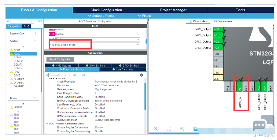

1.模块引脚
0 ~/ m6 @2 i% O使用PA5接上AKEY
. @. m  K; g% O8 F

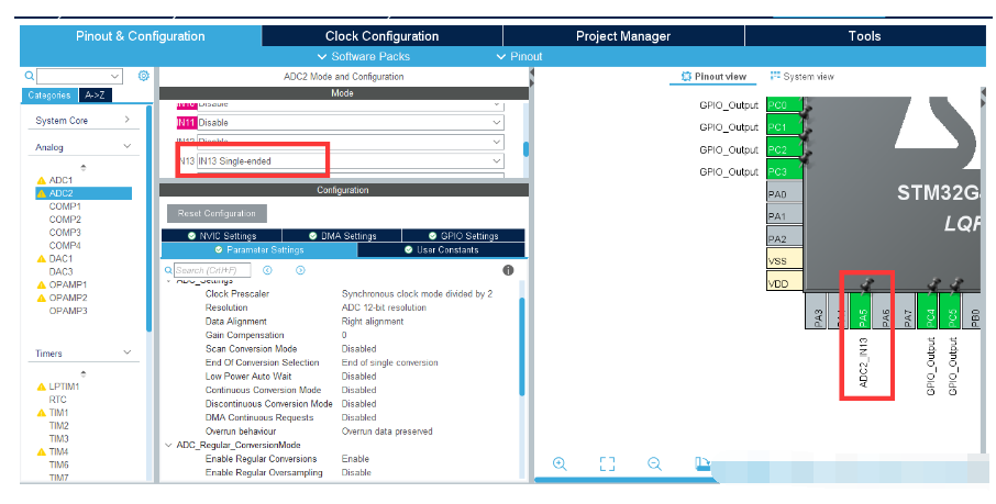

- b) C, K3 K: l/ I/ n2.Cubemx实现的配置
. r$ P  p8 h% w  o2 p+ }
& W& K/ d  w" @& Z7 e

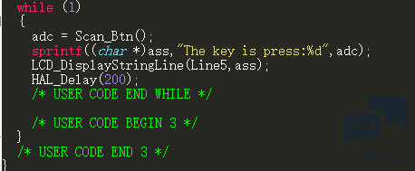

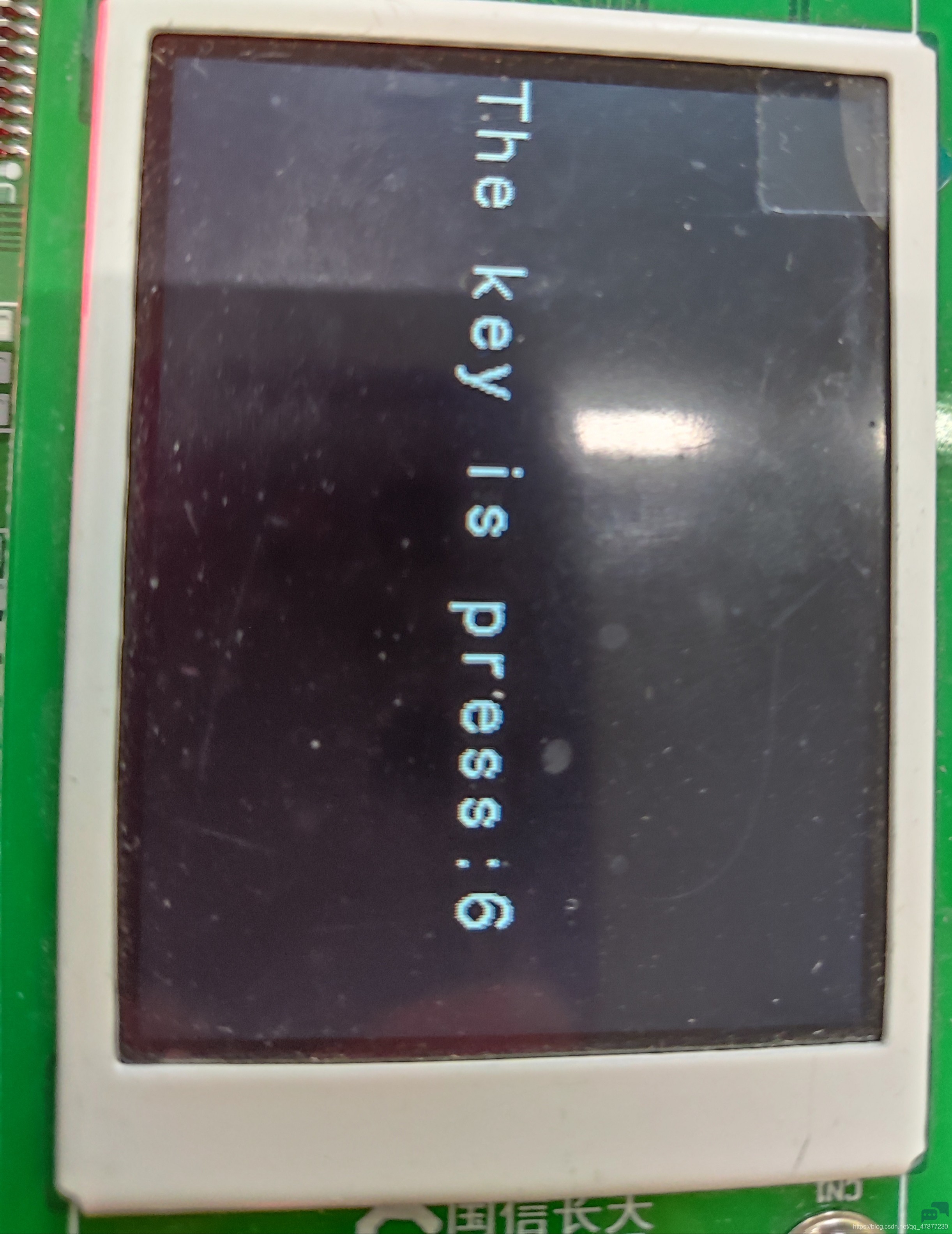

2 q7 R" W5 R5 n0 e  V4.按键控制
4 ^9 f) w* r8 ~) F4 P/ Y
5 D# h- B' ?  p' `" A: P& B
20210604155033898.png 5 r. \* L  p$ T; F$ e
8 S. A# n5 `$ X5 ^  N
  1.                 adc = Scan_Btn();
    " V( V3 d8 E6 _1 @  h3 R* d
  2.                 sprintf((char *)ass,"The key is press:%d",adc);
    3 t3 L! R; i7 e- k8 w  M# z* L
  3.                 LCD_DisplayStringLine(Line5,ass);
    8 O) [) R1 S1 \# v" _! V8 G% F3 X
  4.                 HAL_Delay(200);
$ F; `  I2 g" R; Y
