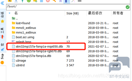

1.修改内核设备树
4 A4 ~7 t3 T! N+ ^( O8 D
' F, @+ ]- t. |( d2 G% {- t5 m0 \* [
& h) t  m) s; I  }$ J$ Z8 _+ |7 i0 C# l% S

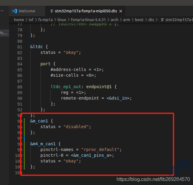

确认IO口没被占用,修改m4_can
% O. \- A& v, B- ?+ ~8 B  t3 }! `& B" Q% i$ |7 u# |  i
( I5 Z: P, M9 P+ w9 R7 U1 _
' C. O+ X: B' O" S3 [
  1. &m_can1 {' f+ ~( b0 ?) X- g* w% M0 H2 f/ A; h
  2.     status = "disabled";% h3 c. t) y" [, S! Q
  3. };
    . e$ q  I) T& U' d0 c
  4. # X4 ~9 H' R5 |: N+ X, m% E1 a
  5. &m4_m_can1 {8 j) Y5 t+ c* [: ~9 F
  6.     pinctrl-names = "rproc_default";
    + K( j) |  \/ R2 ~- H. I5 y
  7.     pinctrl-0 = <&m_can1_pins_a>;
    " c$ w# n7 E% b; ^$ A& @
  8.     status = "okay";" m8 _8 v+ g/ y# ~
  9. };

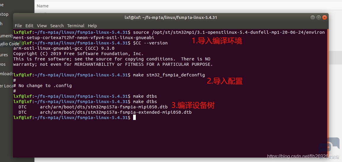

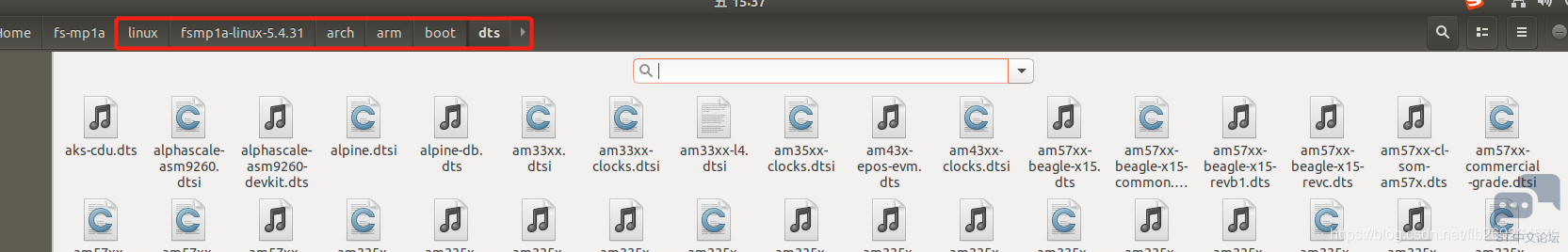

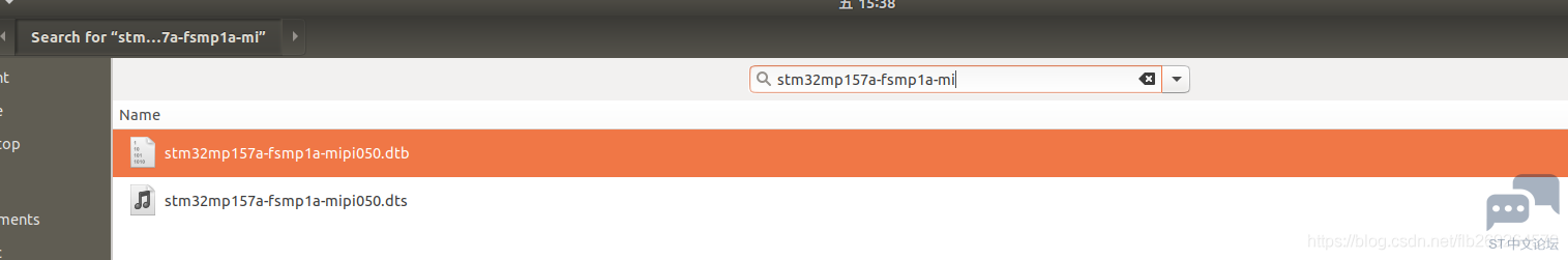

编译设备树:
% c: b' @2 Z2 `  t: F1 T) ^6 y7 Q; i6 ~; B
在内核目录下打开终端
( Y2 H1 g$ L* q. P& a  }( X
3 q6 T9 {6 `  _* q' d: e1 H0 Z1 c( r% G: P/ y, w  x, O2 e
20210423154341574.png $ N. V5 y$ F# F; [4 P- A- y
' `3 Z; R. Z) C, E9 Z  N% S7 P

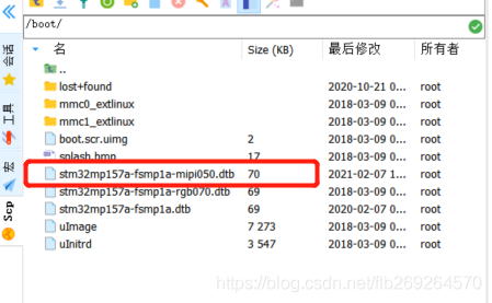

将生成设备树文件复制到板上的boot目录下" X/ O! K5 b/ ]; e1 y8 m
( V  o3 K/ u; g! E2 |
20210423154425211.png # }' U$ ^; [, g2 E. `

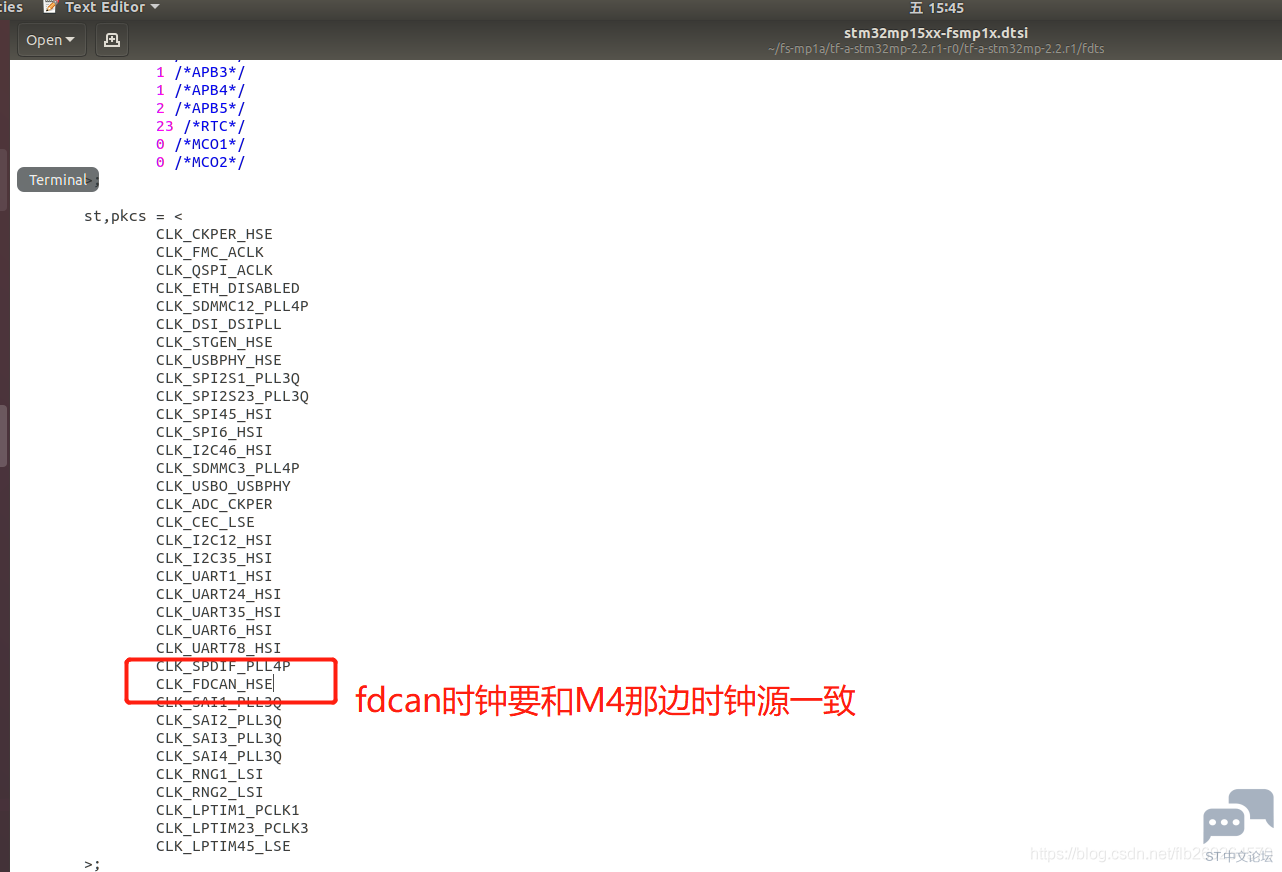

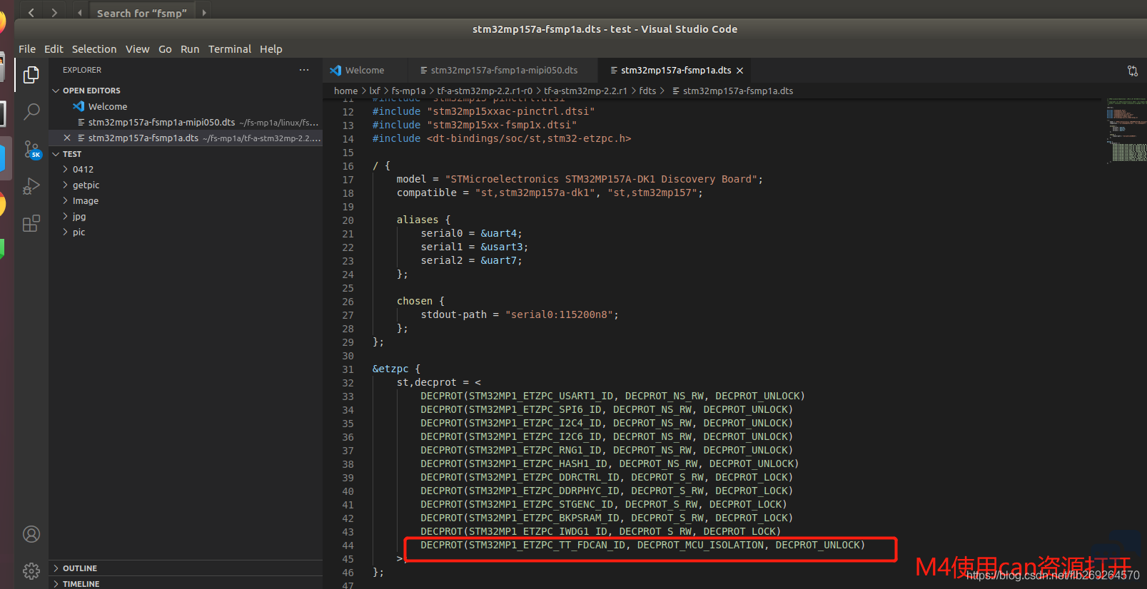

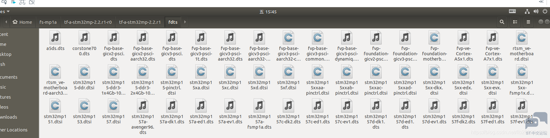

8 x% r6 ?+ W' w. L; y+ N% \2.修改tf-a设备树# u) F# w+ A+ @% C+ k; E
5 B9 ]" J: B8 _( M: }' [" m- H3 v+ d
0 Z5 K) d$ \# ]2 J5 g( o; `. S2 f6 E# w$ o6 `6 L1 n. o
6 d3 R9 I+ w3 p" v! n- r5 G( I6 K9 c5 z8 j
20210423154659581.png 2 Z( m" C7 q- i9 Y4 H( j

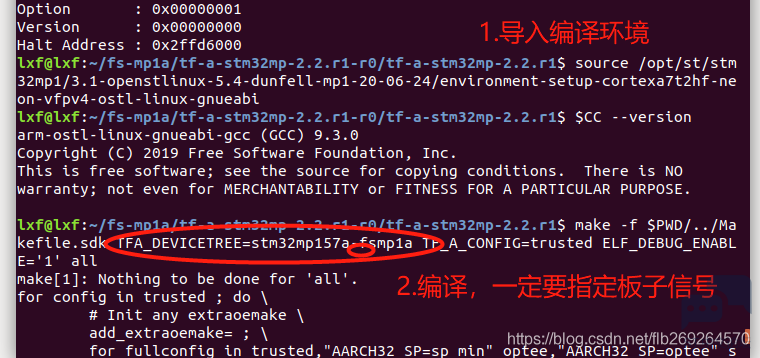

2 n4 Z6 G( M: j( c4 x, t编译设备树文件:5 g: U! l- ^" s$ Z9 w4 R  ]
4 T  i' t. x3 D. s0 k# X
20210423154939871.png 7 k, S. g4 B: t
1 X3 {2 F6 C* j# j6 O" u
  1. make -f $PWD/../Makefile.sdk TFA_DEVICETREE=stm32mp157a-fsmp1a
    / U/ s) c6 d( i3 @
  2. TF_A_CONFIG=trusted ELF_DEBUG_ENABLE='1' all
: \" D( p( g- ^- U复制build目录下的tf-a-stm32mp157a-fsmp1a-trusted.stm32到MP1的/home/root文件夹下面4 @/ z) w! T8 O5 h) [0 f: B
