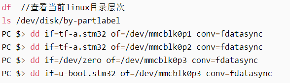

一.Update SD card# \2 n* p: D: [$ n
3 B3 |' I6 }0 s7 o( P0 m5 @1.In linux console
3 C7 T& A3 d3 c* z- Q) x
( [0 d- ~, \+ b, {# f4 i
  1. df  //查看当前linux目录层次
    ( x& f, p  |8 A* M: M% I3 V: [
  2. ls /dev/disk/by-partlabel# G0 w  [, P" g2 R
  3. PC gt; dd if=tf-a.stm32 of=/dev/mmcblk0p1 conv=fdatasync  N, G2 k, ~; O) d6 c$ t0 F6 k
  4. PC gt; dd if=tf-a.stm32 of=/dev/mmcblk0p2 conv=fdatasync
    3 u! Y% U6 s5 g
  5. PC gt; dd if=/dev/zero of=/dev/mmcblk0p3 conv=fdatasync1 d' L6 m$ t( {3 y5 [
  6. PC gt; dd if=u-boot.stm32 of=/dev/mmcblk0p3 conv=fdatasync
