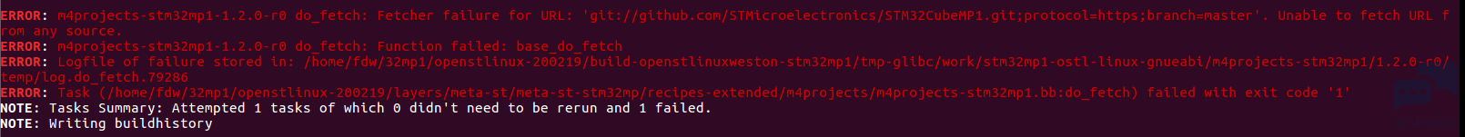

  1. ERROR: m4projects-stm32mp1-1.2.0-r0 do_fetch: Fetcher failure for URL: 'git://github.com/STMicroelectronics/STM32CubeMP1.git;protocol=https;branch=master'. Unable to fetch URL from any source./ u2 V4 [& x! a. Q' E: w
  2. ERROR: m4projects-stm32mp1-1.2.0-r0 do_fetch: Function failed: base_do_fetch
    ; T2 g& {- u" D! @) f) f
  3. ERROR: Logfile of failure stored in: /home/fdw/32mp1/openstlinux-200219/build-openstlinuxweston-stm32mp1/tmp-glibc/work/stm32mp1-ostl-linux-gnueabi/m4projects-stm32mp1/1.2.0-r0/temp/log.do_fetch.80517
    6 w9 p  Z; g/ |) x) V
  4. ERROR: Task (/home/fdw/32mp1/openstlinux-200219/layers/meta-st/meta-st-stm32mp/recipes-extended/m4projects/m4projects-stm32mp1.bb:do_fetch) failed with exit code '1'
    5 C! d& j3 k1 u7 O. l
  5. NOTE: Tasks Summary: Attempted 1 tasks of which 0 didn't need to be rerun and 1 failed.
    . E/ a9 s3 ^9 T& k4 S0 o
  6. NOTE: Writing buildhistory
: _0 C& Q5 c9 f9 f' ]8 G
