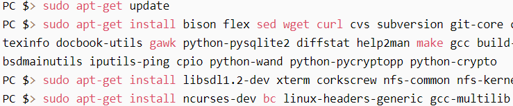

1.必须的依赖包* r* m. G2 I8 k% b# Q7 A8 N2 ^
4 [3 D& c5 m. M8 _" I3 J
  1. PC gt; sudo apt-get update
    0 k9 H/ J( d3 L+ b
  2. PC gt; sudo apt-get install bison flex sed wget curl cvs subversion git-core coreutils unzip texi2html
    4 Z3 y2 c6 J' L' p$ L' `% d
  3. texinfo docbook-utils gawk python-pysqlite2 diffstat help2man make gcc build-essential g++ desktop-file-utils chrpath libxml2-utils xmlto docbook
    1 f' Z& F% B, k/ S) w$ |. _0 o
  4. bsdmainutils iputils-ping cpio python-wand python-pycryptopp python-crypto) W) c. c3 |+ u8 J% b% y
  5. PC gt; sudo apt-get install libsdl1.2-dev xterm corkscrew nfs-common nfs-kernel-server device-tree-compiler mercurial u-boot-tools libarchive-zip-perl
    4 q6 r- M- _( n, [
  6. PC gt; sudo apt-get install ncurses-dev bc linux-headers-generic gcc-multilib libncurses5-dev libncursesw5-dev lrzsz dos2unix lib32ncurses5 repo libssl-dev
) f, S- _% r) F2 g/ R
