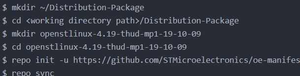

从github同步OpenSTLinux distribution9 d7 y/ |; P+ _" A1 l! c$ r
  1. $ mkdir ~/Distribution-Package
    ! w. }$ T8 C; N8 o& r
  2. $ cd <working directory path>/Distribution-Package
    ) L7 U) N- B4 A/ z! R) B. Y
  3. $ mkdir openstlinux-4.19-thud-mp1-19-10-09 3 _+ x& ~' c8 P" B
  4. $ cd openstlinux-4.19-thud-mp1-19-10-098 e- a1 t7 M; p. ~$ s- a
  5. $ repo init -u  -b refs/tags/openstlinux-4.19-thud-mp1-19-10-09
    0 @0 L! g* P) h2 f3 S- Z% \( u
  6. $ repo sync
