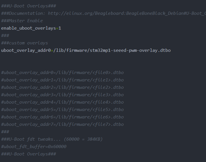

Seeed在出厂烧录的固件中挂载的设备树为stm32mp1-seeed-npi-base.dtb,默认情况下此设备树是不支持Wi-Fi的,如需使用Wifi功能就需要挂载stm32mp1-seeed-npi-full.dtb这个设备树。' w5 m$ W% R' T8 s- }( A$ T
& O" f. a; c% x& Y1 l" u0 j直接修改uEnv.txt文件,此文件会在uboot引导Linux内核的时候主动去加载/boot/dtbs/4.19.9-stm32-r1目录下指定的设备树文件。
1 O: y, X9 ~$ K* |' u
. q7 b! ^' p. z* J6 d$ M4 B1.打开uEnv.txt- `8 ]$ ]6 m2 ^* H/ Y' Q' C) @
vim /boot/uEnv.txt- q8 u# l& h2 g6 y$ a% ]. ^
( N! V. ]# }4 u" o; L( m2 i2.编辑uEnv.txt文件将dtb修改为stm32mp1-seeed-npi-full.dtb0 a, V8 `8 h2 Q( P% x9 u6 t
5 U1 @% K! {/ g/ F; z
  1. uname_r=4.19.9-stm32-r1# b6 p% \$ j8 i% m: I  i
  2. #uuid=- U  _7 m3 ^2 ?7 e" _
  3. dtb=stm32mp1-seeed-npi-full.dtb                ##修改此处
    $ M- x/ g1 t  M: `5 Z7 P5 {
  4. & u) E% c) A7 Y# V
  5. ###U-Boot Overlays###8 d+ l% l& K3 q2 L9 s! [! Z
  6. 8 y1 Z' J- L' `9 J
  7. ###Master Enable1 n" U. A* O& Z( k  H
  8. enable_uboot_overlays=1
    8 A: O" ^& m3 h6 L; u; f; g& |
  9. ###" F; H2 A- s% _3 O! Q
  10. ###custom overlays1 N# m' V7 V" f6 T$ o! L% X' P( M
  11. uboot_overlay_addr0=/lib/firmware/stm32mp1-seeed-pwm-overlay.dtbo' [( k" P6 b9 a2 J
  12. ! _" m; I: O% A+ R
  13. / }; c3 o( w( ~  Y8 u; [; v- L) R6 _
  14. #uboot_overlay_addr0=/lib/firmware/<file0>.dtbo
    * l" i7 Z  }6 Z! C* W) r
  15. #uboot_overlay_addr1=/lib/firmware/<file1>.dtbo
    ' t: @# Q( K. Q+ N$ C
  16. #uboot_overlay_addr2=/lib/firmware/<file2>.dtbo; ^2 N1 I0 F: Q& W' m% c
  17. #uboot_overlay_addr3=/lib/firmware/<file3>.dtbo5 c2 m0 ]6 ~% G7 y$ U2 S
  18. #uboot_overlay_addr4=/lib/firmware/<file4>.dtbo
    + e& m; @5 Y  b8 n, K) a
  19. #uboot_overlay_addr5=/lib/firmware/<file5>.dtbo
    0 \0 a- o  N( c& p/ a
  20. #uboot_overlay_addr6=/lib/firmware/<file6>.dtbo
    5 D3 u8 Y- B, j$ u
  21. #uboot_overlay_addr7=/lib/firmware/<file7>.dtbo! X' N, i/ N+ V8 P  o5 J
  22. ###+ J4 W; Q! Q/ U! c
  23. ###U-Boot fdt tweaks... (60000 = 384KB)
    ) B! c  R) B& a, d; J3 ?
  24. #uboot_fdt_buffer=0x60000" o1 y, Q. s7 k/ ]4 ~# {
  25. ###U-Boot Overlays###
    ' n. g% k/ y6 U- l9 D# t3 x
  26. " W; P1 W5 s0 w1 O! y- J+ ~
  27. cmdline=coherent_pool=1M net.ifnames=0 quiet
