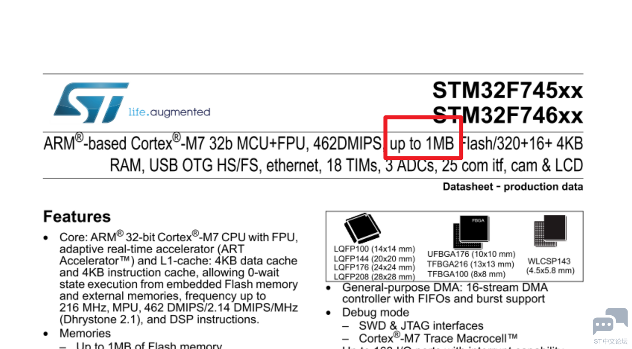

您好,我的应用程序大于1MB后,勾选IROM2后,下载失败,提示:Load linking...Program Size: Code=225528 RO-data=866252 RW-data=188 ZI-data=223420 ".\Objects\lv_f746.axf" - 0 Error(s), 0 Warning(s). Build Time Elapsed: 00:00:07 Load "D:\\workspace\\STM32\\STM\\lv_port_stm32f746_disco\\ide\\Objects\\lv_f746.axf" Full Chip Erase Done. Programming Done. Contents mismatch at: 00200001H (Flash=60H Required=F0H) ! Contents mismatch at: 00200002H (Flash=01H Required=09H) ! Contents mismatch at: 00200003H (Flash=20H Required=FBH) ! Contents mismatch at: 00200004H (Flash=01H Required=11H) ! Contents mismatch at: 00200005H (Flash=02H Required=46H) ! Contents mismatch at: 00200006H (Flash=00H Required=18H) ! Contents mismatch at: 00200007H (Flash=00H Required=F0H) ! Contents mismatch at: 00200008H (Flash=01H Required=0BH) ! Contents mismatch at: 00200009H (Flash=13H Required=FBH) ! Contents mismatch at: 0020000AH (Flash=00H Required=14H) ! Contents mismatch at: 0020000BH (Flash=00H Required=F0H) ! Contents mismatch at: 0020000CH (Flash=81H Required=B5H) ! Contents mismatch at: 0020000DH (Flash=11H Required=FFH) ! Contents mismatch at: 0020000EH (Flash=00H Required=18H) ! Contents mismatch at: 0020000FH (Flash=00H Required=F0H) ! Contents mismatch at: 00200010H (Flash=00H Required=0CH) ! Contents mismatch at: 00200011H (Flash=1BH Required=FBH) ! Contents mismatch at: 00200012H (Flash=00H Required=03H) ! Contents mismatch at: 00200013H (Flash=00H Required=B4H) ! Contents mismatch at: 00200015H (Flash=00H Required=F0H) ! Contents mismatch at: 00200016H (Flash=00H Required=0EH) ! Contents mismatch at: 00200017H (Flash=00H Required=FBH) ! Contents mismatch at: 00200018H (Flash=01H Required=03H) ! Contents mismatch at: 00200019H (Flash=1CH Required=BCH) ! Contents mismatch at: 0020001AH (Flash=00H Required=18H) ! Contents mismatch at: 0020001BH (Flash=00H Required=F0H) ! Contents mismatch at: 0020001CH (Flash=00H Required=10H) ! Contents mismatch at: 0020001DH (Flash=00H Required=FBH) ! Contents mismatch at: 0020001EH (Flash=00H Required=53H) ! Contents mismatch at: 0020001FH (Flash=00H Required=EAH) ! Contents mismatch at: 00200020H (Flash=00H Required=02H) ! Contents mismatch at: 00200021H (Flash=00H Required=0CH) ! Contents mismatch at: 00200023H (Flash=00H Required=F0H) ! Contents mismatch at: 00200024H (Flash=00H Required=69H) ! Contents mismatch at: 00200025H (Flash=00H Required=80H) ! Contents mismatch at: 00200026H (Flash=00H Required=2DH) ! Contents mismatch at: 00200027H (Flash=00H Required=E9H) ! Contents mismatch at: 00200028H (Flash=00H Required=F0H) ! Contents mismatch at: 00200029H (Flash=00H Required=4BH) ! Contents mismatch at: 0020002AH (Flash=00H Required=4FH) ! Contents mismatch at: 0020002BH (Flash=00H Required=F0H) ! Contents mismatch at: 0020002DH (Flash=02H Required=06H) ! Contents mismatch at: 0020002FH (Flash=00H Required=2BH) ! Contents mismatch at: 00200030H (Flash=19H Required=1FH) ! Contents mismatch at: 00200031H (Flash=06H Required=BFH) ! Contents mismatch at: 00200032H (Flash=00H Required=B3H) ! Contents mismatch at: 00200033H (Flash=08H Required=FAH) ! Contents mismatch at: 00200034H (Flash=00H Required=83H) ! Contents mismatch at: 00200035H (Flash=00H Required=F5H) ! Contents mismatch at: 00200036H (Flash=00H Required=03H) ! Contents mismatch at: 00200037H (Flash=00H Required=FAH) ! Contents mismatch at: 00200038H (Flash=01H Required=05H) ! Contents mismatch at: 00200039H (Flash=10H Required=F4H) ! Contents mismatch at: 0020003AH (Flash=20H Required=24H) ! Contents mismatch at: 0020003BH (Flash=00H Required=FAH) ! Contents mismatch at: 0020003CH (Flash=01H Required=05H) ! Contents mismatch at: 0020003DH (Flash=12H Required=F6H) ! Contents mismatch at: 0020003EH (Flash=00H Required=5EH) ! Contents mismatch at: 0020003FH (Flash=00H Required=40H) ! Contents mismatch at: 00200040H (Flash=02H Required=12H) ! Contents mismatch at: 00200041H (Flash=02H Required=BFH) ! Contents mismatch at: 00200042H (Flash=00H Required=16H) ! Contents mismatch at: 00200043H (Flash=00H Required=43H) ! Contents mismatch at: 00200044H (Flash=22H Required=B2H) ! Contents mismatch at: 00200045H (Flash=02H Required=FAH) ! Contents mismatch at: 00200046H (Flash=00H Required=82H) ! Contents mismatch at: 00200047H (Flash=00H Required=F5H) ! Contents mismatch at: 00200049H (Flash=02H Required=FAH) ! Contents mismatch at: 0020004AH (Flash=00H Required=05H) ! Contents mismatch at: 0020004BH (Flash=00H Required=F4H) ! Contents mismatch at: 0020004CH (Flash=41H Required=C5H) ! Contents mismatch at: 0020004DH (Flash=00H Required=F1H) ! Contents mismatch at: 0020004EH (Flash=00H Required=20H) ! Contents mismatch at: 0020004FH (Flash=00H Required=05H) ! Contents mismatch at: 00200050H (Flash=02H Required=1EH) ! Contents mismatch at: 00200051H (Flash=02H Required=BFH) ! Contents mismatch at: 00200052H (Flash=00H Required=22H) ! Contents mismatch at: 00200053H (Flash=08H Required=FAH) ! Contents mismatch at: 00200054H (Flash=01H Required=05H) ! Contents mismatch at: 00200055H (Flash=00H Required=FCH) ! Contents mismatch at: 00200056H (Flash=00H Required=44H) ! Contents mismatch at: 00200057H (Flash=08H Required=EAH) ! Contents mismatch at: 00200058H (Flash=00H Required=0CH) ! Contents mismatch at: 00200059H (Flash=00H Required=04H) ! Contents mismatch at: 0020005AH (Flash=00H Required=20H) ! Contents mismatch at: 0020005BH (Flash=00H Required=35H) ! Contents mismatch at: 0020005CH (Flash=42H Required=56H) ! Contents mismatch at: 0020005DH (Flash=02H Required=EAH) ! Contents mismatch at: 0020005EH (Flash=00H Required=04H) ! Contents mismatch at: 0020005FH (Flash=08H Required=4CH) ! Contents mismatch at: 00200060H (Flash=43H Required=4FH) ! Contents mismatch at: 00200061H (Flash=02H Required=EAH) ! Contents mismatch at: 00200062H (Flash=00H Required=14H) ! Contents mismatch at: 00200063H (Flash=00H Required=44H) ! Contents mismatch at: 00200064H (Flash=00H Required=18H) ! Contents mismatch at: 00200065H (Flash=02H Required=BFH) ! Contents mismatch at: 00200066H (Flash=00H Required=64H) ! Contents mismatch at: 00200067H (Flash=08H Required=1CH) ! Contents mismatch at: 00200068H (Flash=43H Required=4FH) ! Contents mismatch at: 00200069H (Flash=00H Required=F0H) ! Too many errors to display ! Error: Flash Download failed - "Cortex-M7" Flash Load finished at 12:40:31 我的配置: |
手册上看STM32F746最大的容量是1M哦,所以代码超过该型号容量,编译器会限制的。
