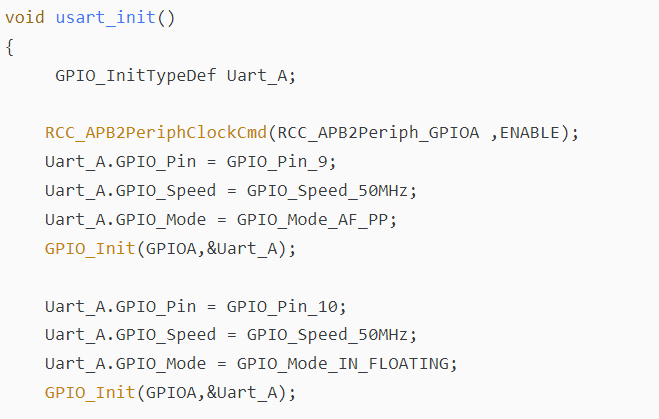

1,串口的初始化:) B  Q3 {, ]# z  c+ _$ @3 A
  1. void usart_init()' D( |: N$ @* X+ G) C- \' I; n
  2. {
    7 W7 e8 g6 v( k
  3.          GPIO_InitTypeDef Uart_A;  + P" w" G: ^  {; j3 Z
  4.       % C2 N8 a& X5 T, |# r1 t$ @
  5.     RCC_APB2PeriphClockCmd(RCC_APB2Periph_GPIOA ,ENABLE);  0 Y. c3 K# q! o1 B/ {
  6.     Uart_A.GPIO_Pin = GPIO_Pin_9;  5 Z" `' N. P# B4 e! a
  7.     Uart_A.GPIO_Speed = GPIO_Speed_50MHz;    W) H; s) |5 k) o$ N3 {
  8.     Uart_A.GPIO_Mode = GPIO_Mode_AF_PP;  6 N" L  k6 t4 x+ w8 m' u
  9.     GPIO_Init(GPIOA,&Uart_A);  ; M' i6 v: d- M- j1 w, u
  10.       9 \# d$ g& L  z( e; i) T
  11.     Uart_A.GPIO_Pin = GPIO_Pin_10;
    ; d6 ]  Q2 z' Z, S8 J/ G( s
  12.     Uart_A.GPIO_Speed = GPIO_Speed_50MHz;  ; Z) S  V% `# o
  13.     Uart_A.GPIO_Mode = GPIO_Mode_IN_FLOATING;
    3 Q& m3 y) \! a% S2 ~
  14.     GPIO_Init(GPIOA,&Uart_A);
    ! _( z  K+ _  |! L: V. h
  15.
    1 m  a; M4 y# y) s
  16.         USART_InitTypeDef Uart;
    . |$ q, I6 E0 l& W0 r
  17.
    - g- A  c  o& [9 R
  18.     RCC_APB2PeriphClockCmd(RCC_APB2Periph_USART1,ENABLE);  3 _& H# K) n3 r! K0 R% j. B  s% {0 c
  19.     Uart.USART_BaudRate = 115200;
    9 a2 F$ A4 V% v2 U, z) y
  20.     Uart.USART_HardwareFlowControl = USART_HardwareFlowControl_None;  7 u1 G, j( r4 t/ H+ a8 A! @% p) }
  21.     Uart.USART_Mode = USART_Mode_Tx;  8 e& l! C8 h! A' r+ W
  22.     Uart.USART_Parity = USART_Parity_No;
    ; s: N! x* J( v7 d8 @
  23.     Uart.USART_StopBits = USART_StopBits_1;  5 `; H% x0 g: [2 O; Q8 k/ M- d
  24.     Uart.USART_WordLength = USART_WordLength_8b;
    * b- M: B/ R5 K) |% M; Z! k
  25.     USART_Init(USART1,&Uart);    \0 \* L. n; a; j( n! E
  26.       9 x( O& ~& u, f* f+ {( A
  27.     USART_Cmd(USART1,ENABLE);  % c1 Q) I% ?1 ^' W, L8 l
  28.     USART_ClearFlag(USART1,USART_FLAG_TC);
    7 i! v* b& X' Z- i4 H, g7 [
  29. }
4 N% q6 N  z4 Q3 I% ]3 U
) D+ v; q7 ~' e0 K" {  g* p
