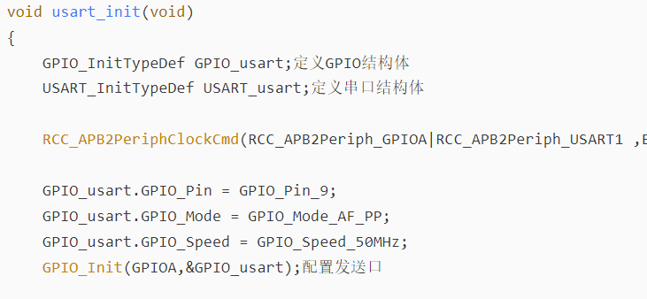

1,串口配置
' s* E* }5 J( z0 F6 M/ @
  1. void usart_init(void)8 f9 k! B. C- F! N& z* o
    5 A+ |$ E# S7 z
  3.         GPIO_InitTypeDef GPIO_usart;定义GPIO结构体
    ' y; l- O# c4 Y
  4.         USART_InitTypeDef USART_usart;定义串口结构体$ g7 `* Q& g- e$ P
  5.
    - u4 N  c& u! {: R. z
  6.         RCC_APB2PeriphClockCmd(RCC_APB2Periph_GPIOA|RCC_APB2Periph_USART1 ,ENABLE);使能外设时钟3 t2 G' X4 S5 C2 R5 B
  7.         - ]$ K8 F8 z$ q) ~' \. ]
  8.         GPIO_usart.GPIO_Pin = GPIO_Pin_9;( o+ Y, i' n. l7 y/ H, V5 j  J
  9.         GPIO_usart.GPIO_Mode = GPIO_Mode_AF_PP;
    ( K, ]% M2 M% W
  10.         GPIO_usart.GPIO_Speed = GPIO_Speed_50MHz;
    , p' t# p% `0 B- z' Z
  11.         GPIO_Init(GPIOA,&GPIO_usart);配置发送口
    # }. x* f% ?$ ?; b/ G  j) r+ u( }
