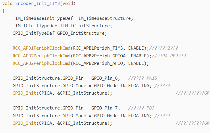

初始化代码
4 h; N" V) {5 g2 P# S
  1. void Encoder_Init_TIM3(void)
    & P, V# @, F$ X8 \# w
  2. {# b2 ^2 O* K% W5 Q3 y
  3.         TIM_TimeBaseInitTypeDef TIM_TimeBaseStructure;  4 n8 n: p- N$ i9 E
  4.         TIM_ICInitTypeDef TIM_ICInitStructure;
    0 \5 K) c- X6 R( l8 l* }- ^& Z  m; J
  5.         GPIO_InitTypeDef GPIO_InitStructure;
    2 H: e7 R0 i, Z8 C1 I6 C" X6 S
  6.
    " X$ y& M- K& ^
  7.         RCC_APB1PeriphClockCmd(RCC_APB1Periph_TIM3, ENABLE);//?????2???+ w/ W$ Z2 g# R" y
  8.         RCC_APB2PeriphClockCmd(RCC_APB2Periph_GPIOA, ENABLE);//??PA PB????- F; E( Y% G! F# M$ m! G' y
  9.         RCC_APB2PeriphClockCmd(RCC_APB2Periph_AFIO, ENABLE);+ c; n1 r  ?4 A4 J, ]: V
  10.         : I. r0 T& y' w# U: V9 N! }' F: C
  11.         GPIO_InitStructure.GPIO_Pin = GPIO_Pin_6;        //???? PA15$ I, d& u) N8 w
  12.         GPIO_InitStructure.GPIO_Mode = GPIO_Mode_IN_FLOATING; //????
    8 f2 o' x  _+ I* f! A+ n# d, o/ g6 I
  13.         GPIO_Init(GPIOA, &GPIO_InitStructure);                                              //?????????GPIOA7 v" z. r& J4 V8 I
  14.
    $ u, d7 L2 O4 p8 F
  15.         GPIO_InitStructure.GPIO_Pin = GPIO_Pin_7;        //???? PB3
    ) X: I) Z* f- k  M( C/ t
  16.         GPIO_InitStructure.GPIO_Mode = GPIO_Mode_IN_FLOATING; //????  y! e- a5 }4 h& n
  17.         GPIO_Init(GPIOA, &GPIO_InitStructure);                                              //?????????GPIOB
    $ }! M3 G: @& l( `1 ]1 ^. s) ~
  18.         : o# t* F0 B1 _' w4 d
  19.         TIM_TimeBaseStructInit(&TIM_TimeBaseStructure);6 L9 A+ F9 J/ r
  20.         TIM_TimeBaseStructure.TIM_Prescaler = 0x0; // ???? 8 ^* y, N4 b; T4 b4 n% f
  21.         TIM_TimeBaseStructure.TIM_Period = 65535; //??????????
    5 B: s: R: l8 X0 ?6 @+ B
  22.         TIM_TimeBaseStructure.TIM_ClockDivision = TIM_CKD_DIV1;//??????:???1 G4 M8 x5 h' w% H# |8 A& ]
  23.         TIM_TimeBaseStructure.TIM_CounterMode = TIM_CounterMode_Up;//??????
    6 {8 L; i# h5 W' N+ ?/ A- ^" ~+ x
  24.         TIM_TimeBaseInit(TIM3, &TIM_TimeBaseStructure);  //??????2
    5 a9 j' w! r! U  f, C  t
  25.         " E' W5 j4 B# T) O
  26.         TIM_EncoderInterfaceConfig(TIM3, TIM_EncoderMode_TI12, TIM_ICPolarity_Rising, TIM_ICPolarity_Rising);//???????37 @  c3 F' X5 l, k
  27.         , }# A$ Z6 ~4 X) m! t& J
  28.         TIM_ICStructInit(&TIM_ICInitStructure); //?TIM_ICInitStruct ?????????????7 @1 l! r4 \& X, \0 e
  29.         TIM_ICInitStructure.TIM_ICFilter = 10;  //???????7 z1 Q. N. D7 U  D3 f3 Q- \* b
  30.         TIM_ICInit(TIM3, &TIM_ICInitStructure);//?? TIM_ICInitStruct ????????        TIMx1 ]- I- e" @# N7 Y, J( F
  31. ( Z" a5 |* @$ O' B4 z# T1 ~  s& s; U
  32.         TIM_ClearFlag(TIM3, TIM_FLAG_Update);//??TIM??????' C- I2 v! G" E8 @( x0 V
  33.         TIM_ITConfig(TIM3, TIM_IT_Update, ENABLE);//???????
    4 K& [$ I4 C, u5 b, F5 D8 m' S  {
  34.         7 w* q$ v" c- }8 k* g1 r8 K$ g
  35.         TIM_SetCounter(TIM3,0);4 J5 y4 @; ^" c0 ]: c
  36.         TIM_Cmd(TIM3, ENABLE); //?????2" |  M/ I9 \: Z+ w% _* G
  37. }- P; E$ L' Y- k" F& B9 n
