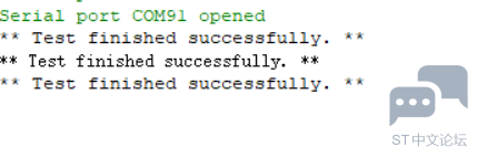

我这里使用的是UART3.
PUTCHAR_PROTOTYPE
HAL_UART_Transmit(&huart3, (uint8_t *)&ch, 1, 0xFFFF);
return ch;
printf("** Test finished successfully. ** \n\r");
