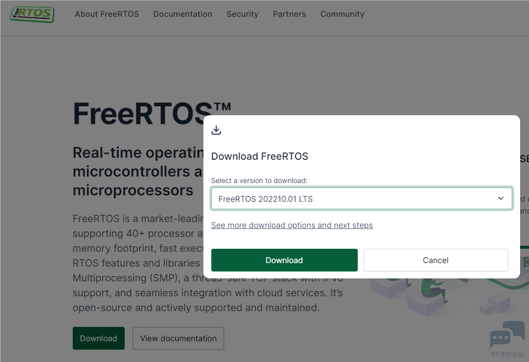

一、下载FreeRTOS源码" W! b: j4 @' _) }
& \+ K* n  d* E$ e, r下载地址:https://www.freertos.org/
3 A* q; c2 w9 C4 D

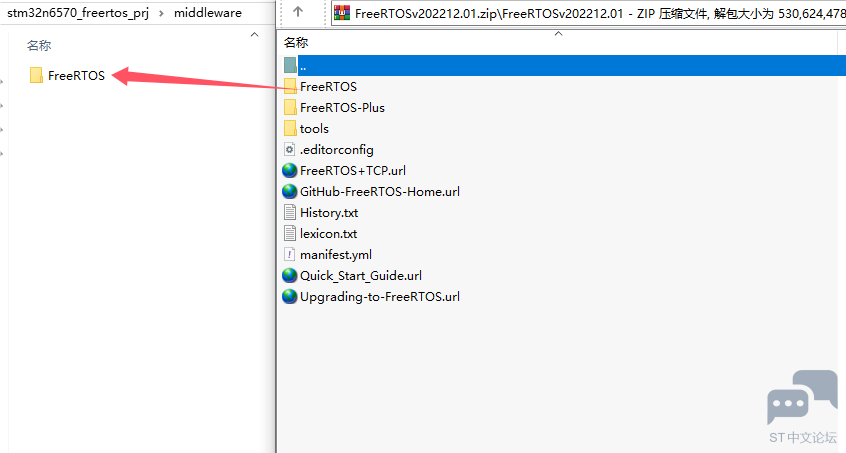

二、添加文件
% b$ w5 m/ m7 P( t, O: ~; q  t  G1 `: z  U4 I, G( U
2.1、复制文件到项目下的middleware
& m# N/ v+ P1 W" u; U$ E 004.png

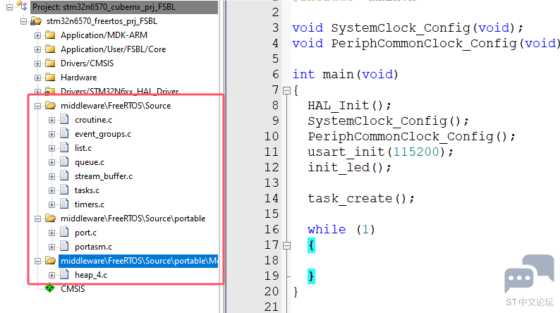

/ i# I5 u; d1 y+ h2.2、在工程中添加FreeRTOS源码3 W5 A+ T" D$ E4 R% Y" J) ]" i  U  O
4 Q4 A8 x5 B  U, E$ b0 u

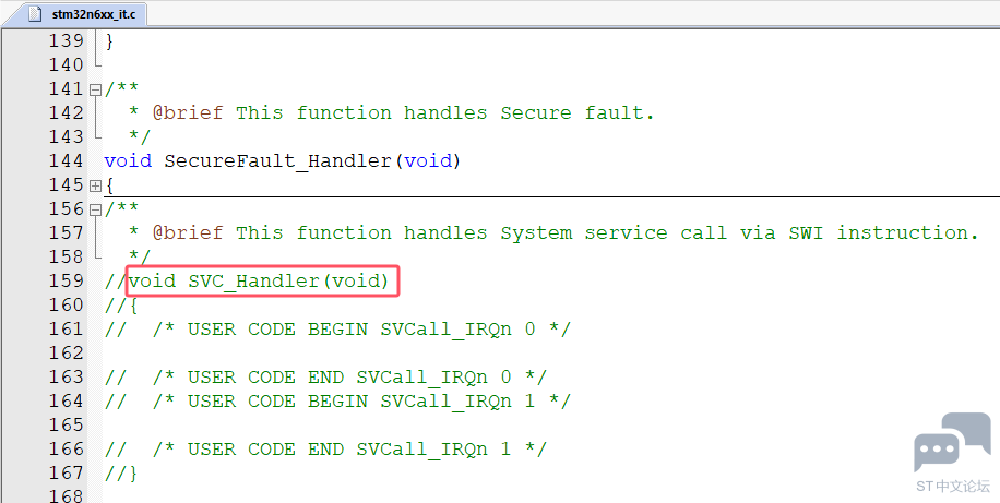

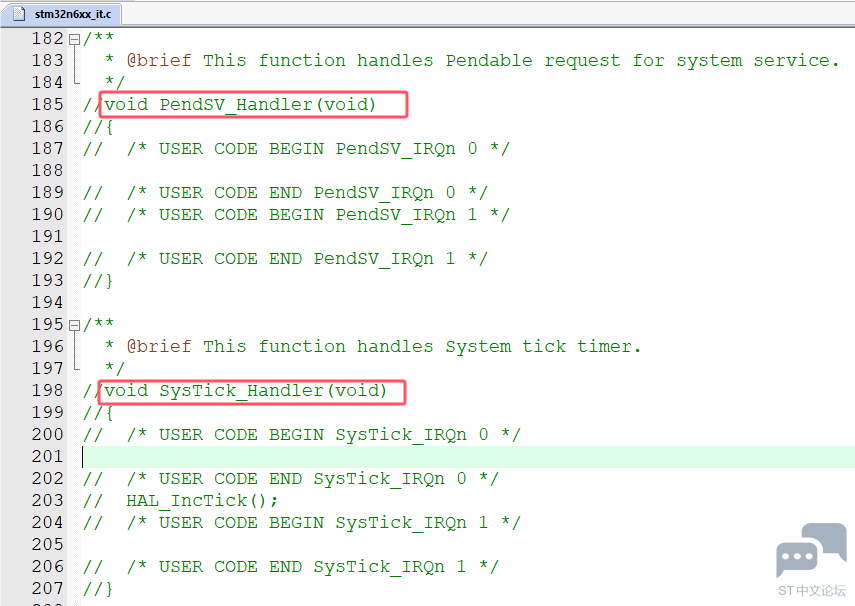

三、程序代码5 I. Y7 L3 P. a4 a
8 l1 Y0 U6 p/ b, E) r4 S5 q
. ^$ R$ w$ C" [" B) y( O& ^- K" b
3.1、FreeRTOSConfig.h
7 v" k1 h' }. [: ]

3.2、屏蔽函数, f, A6 J' P9 Q
9 E5 `- ~; q: O3 Y4 D2 }) [! S
' z( w) }3 k( M- j8 [) U8 c# t* f+ f在stm32n6xx_it.c
/ ^0 o% X  C- Z  v 005.png
2 y' l& T# f3 }

3.4、fun_task.c/ r! r: G; _5 o$ t3 s% t
  1. #include "main.h"6 t; G+ i& A9 y3 |  s/ F
  2. 6 G7 O% }4 N4 V8 ^" W* |4 J
  3. #define START_TASK_PRO                1                                ! a, |. N( m! O' Q8 r9 Q
  4. #define START_STK_SIZE                1289 s" ?5 N0 P( Q8 x
  5. TaskHandle_t StartTask_Handler;$ V! u/ u0 L  @
  6. 3 W/ ?5 q  u+ Y) v8 h
  7. #define TASK1_PRIO              2
    8 J4 c. k$ y2 p' m
  8. #define TASK1_STK_SIZE          128
    . G# M, G7 }# h5 A
  9. static TaskHandle_t                    Task1Task_Handler = NULL;  2 x- K* B0 E. d+ W0 ^5 N% t
  10.            : [4 e5 e9 G  a; U! q3 e
  11. #define TASK2_PRIO              3                   % A9 q# ~6 C0 V9 R1 t# y
  12. #define TASK2_STK_SIZE          128                 + m: G) {' ?. q! V8 E/ i8 _
  13. static TaskHandle_t                    Task2Task_Handler = NULL;
    # r& D' |" U7 M, S; J: h% i. D' u
  14. . u4 W# L: j5 R5 y; c. v
  15. #define TASK3_PRIO              4                   & C- n( m' H; j  N& J5 _' E
  16. #define TASK3_STK_SIZE          128
    ; S% c# V* Q1 Z' M
  17. static TaskHandle_t                    Task3Task_Handler = NULL;  0 W. A& G6 k$ m: h* b7 d0 V
  18. ' O5 ]% R# x2 l% F
  19. 8 B* R. f9 L8 X
  20. void start_task(void *pvParameters);
    - m6 O1 r! K# m) N1 x! H
  21. void gui_task(void *pvParameters);: ?2 d/ i* V8 E2 o. k
  22.   M1 X  K' J! |! A  b2 Q
  23. void task1(void *pvParameters);
    ( D) p. q, e2 |# S/ D+ ^- p
  24. void task2(void *pvParameters);/ ^  [/ k9 d8 Z7 O& p& g) m4 Y6 h
  25. void task3(void *pvParameters);
    % q. s( s5 a$ J! B! x
  26. 1 y: h6 M+ u+ }% S1 I) r
  27. ! n6 _. h! }- v
  28. - q: s/ Z/ b8 t, F0 B: Q5 h' T
  29. void task_create(void)- `8 D& s; H  f3 c" }4 C; q
  30. {9 O, F" O/ N8 ^+ u3 T  q. r7 w
  31.
    , T1 ~) u; s0 a) [% O
  32.         //start_task8 E4 v, T% s- ^1 z: u# P5 s
  33.         xTaskCreate((TaskFunction_t )start_task,
    2 A5 N( f9 v% b1 ?( L1 I
  34.                                                         (const char*    )"start_task",
    2 E7 [5 M6 g9 X' e9 U
  35.                                                         (uint16_t       )START_STK_SIZE,
      i2 L; E" o( Z% p1 R% Z8 q
  36.                                                         (void*          )NULL,
    $ R# ?2 Y  l& s: y6 T; l5 ]0 e
  37.                                                         (UBaseType_t    )START_TASK_PRO,             $ M0 X9 Z8 a& ~; n( `" a
  38.                                                         (TaskHandle_t*  )&StartTask_Handler);
    ( \$ g* H- X) n" o
  39. 3 r" ~3 x" d% I7 {. B" Q" @
  40.         vTaskStartScheduler();
    & f  d/ J/ c5 U3 u
  41. }% O# ?1 ~* E3 K- N
  42. 9 W4 S  Z( e3 C* q: \+ s: k
  43. void start_task(void *pvParameters)$ V' k, }6 A) w+ q/ o# d
  44. {% @6 l( Y( w: m8 c; F  k, Z' J) O
  45.         taskENTER_CRITICAL(); % _! |+ x9 M& i* b3 {) j
  46.         //task1
      g7 t2 S  _4 I  D6 E
  47.         xTaskCreate((TaskFunction_t )task1,                  0 z6 q0 R: |  \
  48.                                                         (const char*    )"task1",
    ( Q: c- U/ x- \' ]4 g3 |, g3 P6 \
  49.                                                         (uint16_t       )TASK1_STK_SIZE,           e1 \- d) e% o7 `" y4 S% d% \7 \0 ~
  50.                                                         (void*          )NULL,                   + q5 R9 e# e  G- @: b3 U; p
  51.                                                         (UBaseType_t    )TASK1_PRIO,             " M7 p: t2 N7 d7 p- w" w3 y
  52.                                                         (TaskHandle_t*  )&Task1Task_Handler);
    3 s& g% T6 x, b( h  r" `
  53.         //task2) r/ b: @- H5 R, E8 L( s7 P
  54.         xTaskCreate((TaskFunction_t )task2,
    , c) h  `; v1 u* C/ T4 f
  55.                                                         (const char*    )"task2",
    0 l, s  E) }: Y1 q& d
  56.                                                         (uint16_t       )TASK2_STK_SIZE,
    3 j! [- `# T, K/ X% X" I7 A8 e
  57.                                                         (void*          )NULL,                  0 [# e9 q  D4 Y/ k2 d% m  p! ~
  58.                                                         (UBaseType_t    )TASK2_PRIO,
    2 d' t9 e5 b7 E% k% f8 J1 m( q* l
  59.                                                         (TaskHandle_t*  )&Task2Task_Handler);
    * M6 w/ h3 s9 J( o5 f+ B7 g
  60.         //taskEXIT_CRITICAL();
    ( l! g# z; _" t4 B6 O# g3 [
  61.
    ( P. I% Z9 A# K) a; T  f: e* _* G
  62.         //task3
    ! s0 T% `2 C; Q$ ^
  63.         xTaskCreate((TaskFunction_t )task3,
    " a' P8 F" r! t5 z2 B; x, V' b6 G' F- Z8 ^
  64.                                                         (const char*    )"task3",                7 x) b. T* ]4 w) `: p
  65.                                                         (uint16_t       )TASK3_STK_SIZE,
    3 l6 l* d! P% y; N% s" ?$ s
  66.                                                         (void*          )NULL,                  . F+ S5 y# P8 ~/ _' W3 @
  67.                                                         (UBaseType_t    )TASK3_PRIO,
    5 l, s9 F' f# b( B' [; k9 b
  68.                                                         (TaskHandle_t*  )&Task3Task_Handler);
    . L5 N' a6 s9 t* [* f) C8 o
  69.         taskEXIT_CRITICAL();
    4 A1 [6 Z9 h) A1 V9 c6 @
  70.                                                         $ ]/ x6 f  g2 W2 Y3 Q
  71.         vTaskDelete(StartTask_Handler);                                                ! Y& E1 R/ e; j+ K4 @+ g& j
  72. }0 Q% V! h4 R, T' y: U
  73.   X& s; F3 m5 H5 G; ~9 X
  74. //task1
    ! d3 I+ ?  K  [3 e4 T1 {8 O
  75. void task1(void *pvParameters)% G, C* [, v6 Q- J/ z  S( \2 X
  76. {
    1 \6 p* i% H7 m4 E; w$ `
  77.                 __IO uint32_t index = 0;. L6 P# H0 e$ R4 O  M5 ?
  78.                 __IO uint32_t flash_id_index = 0;
    7 U  P" j/ E7 x) Y$ b. p$ H! h
  79.
    $ v: O) L, B) i0 t) w
  80.     while (1)# y( [1 ]7 w5 t
  81.     {
    / u1 q! b' T( M
  82.                                 led1_tog();
    - J8 @' u1 V/ q7 G$ s
  83.         printf("task1 run ...\r\n");
      c8 t( L1 i/ B  {+ y, c
  84.         vTaskDelay(200);
    + o* I$ F$ z$ @
  85.     }' b4 q6 `! ?- S$ Y' U
  86. }
    7 ?& b6 P4 W* k* m9 Z  S
  87. ! _; R5 {/ h- B3 P- a" b, b
  88. //task27 ~3 m& i% m% a# A3 Z, m
  89. void task2(void *pvParameters)- t- F6 N2 [$ W
  90. {
    + w) B' U% [6 y; l  J
  91.     while (1)' E! b, |$ Q( b% V. X
  92.     {        1 L1 U2 I8 d+ h
  93.                                 led2_tog();
    ) i% p6 j) ]# u
  94.         printf("task2 run ...\r\n");# I/ g- }% H# A! W7 N4 G: C: V" _
  95.         vTaskDelay(100);1 w. M/ x8 _$ O" `. n3 u& }# q( v% N
  96.     }, `, x6 c; W; a/ G1 w2 u' B
  97. }# O4 l& k8 i) i# G- |5 Q9 n
  98. ; @/ s3 y1 X) Q( f
  99. //task34 ?6 M: D0 A1 `1 E4 Y; c& E0 ^6 P+ O
  100. void task3(void *pvParameters)  Q  _# p/ W: o) p
  101. { + d( w# T, j) ~& _
  102.     while (1)
    3 e6 e: I0 s) p$ V2 _1 m
  103.     {
    " M8 |! F/ m/ A: ~- f
  104.         printf("task3 run ...\r\n");2 A/ n0 v% J7 ?& p
  105.         vTaskDelay(100);
    & X% o' ]% ?5 ^% J* w  j* _& V
  106.     }6 J+ F7 N1 S9 A$ ~- Y2 q& l
  107. }
' [. R6 [$ A0 W) m
- z7 y# w8 N+ ]$ J( S

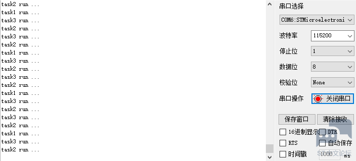

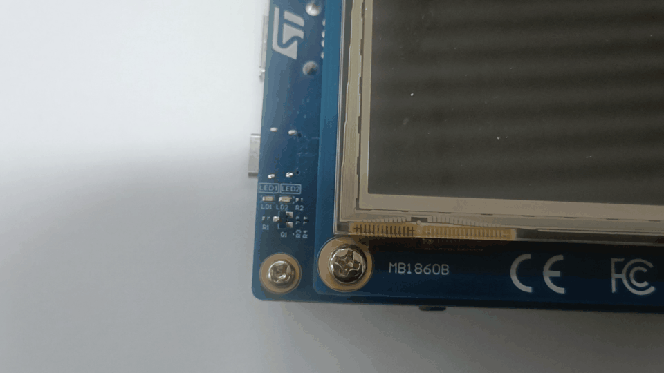

四、运行结果
; C4 O( }  p- |! `2 g
' N) g" I, V  P* I! u' J9 w% f4.1、仿真运行后,串口输出
4 c: y0 ~- ^, P0 f3 f4 c. F3 n/ `& H6 q4 P: J* C, ]% _7 _
* x! R/ b" R/ R$ Q2 E* k6 s: M
# P/ i7 m' V; B/ n+ H8 p& p
8 v# ]/ e( s8 b; ?% |
4 x! ]8 B0 t0 h: A: v4.2、LED灯运行
  }3 b8 N" S+ g5 {  H- f2 X. K+ [) j$ U
' \: V' N/ T( W6 `5 V$ r3 H2 X3 H6 N" n1 {) q9 ~6 `
( ?) |5 K2 _' i* T  R8 y; e
2 D9 t* P6 J7 i0 ?# u) @3 w
