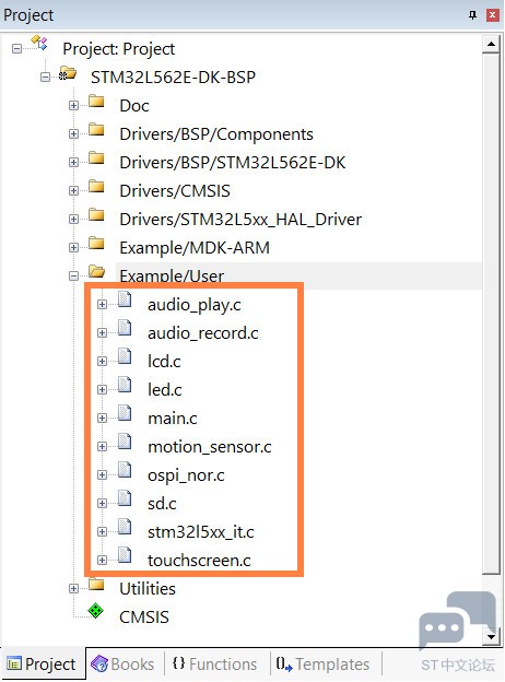

工程介绍
打开 ST 官网提供的例程 STM32Cube_FW_L5_V1.5.0\Projects\STM32L562E-DK\Examples\BSP (Board Support Package,BSP),测试内容包括(详见 Doc/readme.txt)
main 函数
代码

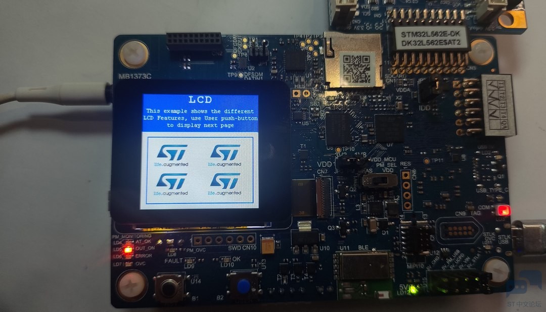

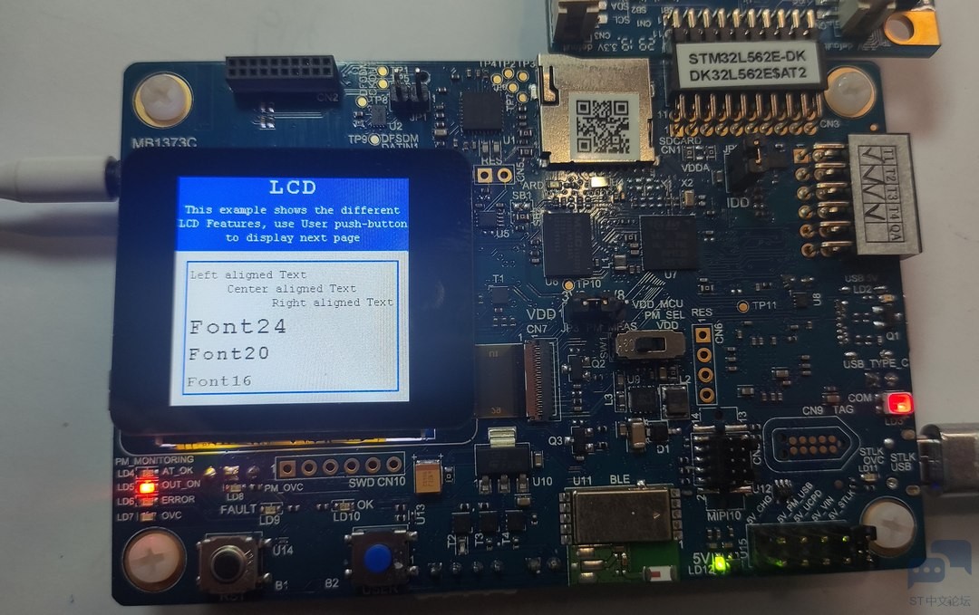

LCD
该项目展示了如何使用LCD的不同功能来显示不同字体的字符串、显示不同形状以及绘制位图。
void LCD_demo(void)
  LCD_SetHint();
  LCD_Feature = 0;
  LCD_Show_Feature (LCD_Feature);
  while (1)
    if (UserButtonPressed == SET)
      /* Add delay to avoid rebound and reset it status */
      HAL_Delay(500);
      UserButtonPressed = RESET;
      if (++LCD_Feature < LCD_FEATURES_NUM)
        LCD_Show_Feature(LCD_Feature);
      else
        return;

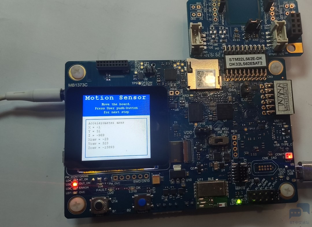

SD 卡
该项目展示了如何擦除、写入和读取SD卡,以及如何检测 SD 卡的存在。

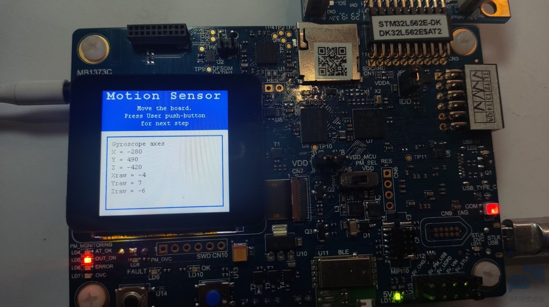

运动传感器
该项目展示了如何使用板上的运动传感器(加速度计和陀螺仪功能)。
void MotionSensor_demo(void)
  BSP_MOTION_SENSOR_Axes_t         axes;
  BSP_MOTION_SENSOR_AxesRaw_t      axesRaw;
  uint8_t string[50] = {0};
  MotionSensor_SetHint();
  /* Test of Accelerometer */
  /* Initialize function */
  if (BSP_MOTION_SENSOR_Init(0, MOTION_ACCELERO) != BSP_ERROR_NONE)
    Error_Handler();
  /* Enable function */
  if (BSP_MOTION_SENSOR_Enable(0, MOTION_ACCELERO) != BSP_ERROR_NONE)
    Error_Handler();
  /* GetAxes function */
  UTIL_LCD_DisplayStringAt(20, 100, (uint8_t*) "Accelerometer axes", LEFT_MODE);
  while (UserButtonPressed == RESET)
    if (BSP_MOTION_SENSOR_GetAxes(0, MOTION_ACCELERO, &axes) != BSP_ERROR_NONE)
      Error_Handler();
    if (BSP_MOTION_SENSOR_GetAxesRaw(0, MOTION_ACCELERO, &axesRaw) != BSP_ERROR_NONE)
      Error_Handler();
    sprintf((char*)string, "X = %ld      ", (signed long)axes.x);
    UTIL_LCD_DisplayStringAt(20, 115, string, LEFT_MODE);
    sprintf((char*)string, "Y = %ld      ", (signed long)axes.y);
    UTIL_LCD_DisplayStringAt(20, 130, string, LEFT_MODE);
    sprintf((char*)string, "Z = %ld      ", (signed long)axes.z);
    UTIL_LCD_DisplayStringAt(20, 145, string, LEFT_MODE);
    sprintf((char*)string, "Xraw = %d      ", axesRaw.x);
    UTIL_LCD_DisplayStringAt(20, 160, string, LEFT_MODE);

加速度计
陀螺仪
LCD 显示测试
