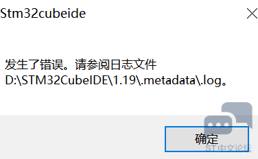

IDE软件更新后,提示log报错,有人遇到过吗
从1.17版本,更新到1.19 然后就报错了,现在1.17也打不开了 这什么原因 日志内容如下: !SESSION 2025-07-17 09:39:07.879 ----------------------------------------------- eclipse.buildId=Version 1.19.0 java.version=21.0.3 java.vendor=Eclipse Adoptium BootLoader constants: OS=win32, ARCH=x86_64, WS=win32, NL=zh_CN Command-line arguments: -os win32 -ws win32 -arch x86_64 !ENTRY org.eclipse.osgi 4 0 2025-07-17 09:39:10.876 !MESSAGE 应用程序错误 !STACK 1 java.lang.LinkageError: loader constraint violation: when resolving method 'void org.eclipse.e4.ui.bindings.internal.BindingTable.addBinding(org.eclipse.jface.bindings.Binding)' the class loader org.eclipse.osgi.internal.loader.EquinoxClassLoader @2e62ead7 of the current class, org/eclipse/e4/ui/workbench/swt/util/BindingProcessingAddon, and the class loader org.eclipse.osgi.internal.loader.EquinoxClassLoader @7bdf61ad for the method's defining class, org/eclipse/e4/ui/bindings/internal/BindingTable, have different Class objects for the type org/eclipse/jface/bindings/Binding used in the signature (org.eclipse.e4.ui.workbench.swt.util.BindingProcessingAddon is in unnamed module of loader org.eclipse.osgi.internal.loader.EquinoxClassLoader @2e62ead7, parent loader 'platform'; org.eclipse.e4.ui.bindings.internal.BindingTable is in unnamed module of loader org.eclipse.osgi.internal.loader.EquinoxClassLoader @7bdf61ad, parent loader 'platform') at org.eclipse.e4.ui.workbench.swt.util.BindingProcessingAddon.defineBinding(BindingProcessingAddon.java:174) at org.eclipse.e4.ui.workbench.swt.util.BindingProcessingAddon.defineBindingTable(BindingProcessingAddon.java:165) at org.eclipse.e4.ui.workbench.swt.util.BindingProcessingAddon.defineBindingTables(BindingProcessingAddon.java:148) at org.eclipse.e4.ui.workbench.swt.util.BindingProcessingAddon.init(BindingProcessingAddon.java:96) at java.base/jdk.internal.reflect.DirectMethodHandleAccessor.invoke(DirectMethodHandleAccessor.java:103) at java.base/java.lang.reflect.Method.invoke(Method.java:580) at org.eclipse.e4.core.internal.di.MethodRequestor.execute(MethodRequestor.java:56) at org.eclipse.e4.core.internal.di.InjectorImpl.processAnnotated(InjectorImpl.java:977) at org.eclipse.e4.core.internal.di.InjectorImpl.internalInject(InjectorImpl.java:139) at org.eclipse.e4.core.internal.di.InjectorImpl.internalMake(InjectorImpl.java:386) at org.eclipse.e4.core.internal.di.InjectorImpl.make(InjectorImpl.java:326) at org.eclipse.e4.core.contexts.ContextInjectionFactory.make(ContextInjectionFactory.java:228) at org.eclipse.e4.ui.internal.workbench.ReflectionContributionFactory.createFromBundle(ReflectionContributionFactory.java:93) at org.eclipse.e4.ui.internal.workbench.ReflectionContributionFactory.doCreate(ReflectionContributionFactory.java:59) at org.eclipse.e4.ui.internal.workbench.ReflectionContributionFactory.create(ReflectionContributionFactory.java:37) at org.eclipse.e4.ui.internal.workbench.swt.E4Application.createE4Workbench(E4Application.java:273) at org.eclipse.ui.internal.Workbench.lambda$3(Workbench.java:568) at org.eclipse.core.databinding.observable.Realm.runWithDefault(Realm.java:339) at org.eclipse.ui.internal.Workbench.createAndRunWorkbench(Workbench.java:546) at org.eclipse.ui.PlatformUI.createAndRunWorkbench(PlatformUI.java:173) at org.eclipse.ui.internal.ide.application.IDEApplication.start(IDEApplication.java:152) at org.eclipse.equinox.internal.app.EclipseAppHandle.run(EclipseAppHandle.java:208) at org.eclipse.core.runtime.internal.adaptor.EclipseAppLauncher.runApplication(EclipseAppLauncher.java:143) at org.eclipse.core.runtime.internal.adaptor.EclipseAppLauncher.start(EclipseAppLauncher.java:109) at org.eclipse.core.runtime.adaptor.EclipseStarter.run(EclipseStarter.java:439) at org.eclipse.core.runtime.adaptor.EclipseStarter.run(EclipseStarter.java:271) at java.base/jdk.internal.reflect.DirectMethodHandleAccessor.invoke(DirectMethodHandleAccessor.java:103) at java.base/java.lang.reflect.Method.invoke(Method.java:580) at org.eclipse.equinox.launcher.Main.invokeFramework(Main.java:668) at org.eclipse.equinox.launcher.Main.basicRun(Main.java:605) at org.eclipse.equinox.launcher.Main.run(Main.java:1481) !SESSION 2025-07-17 09:43:33.567 ----------------------------------------------- eclipse.buildId=Version 1.19.0 java.version=21.0.3 java.vendor=Eclipse Adoptium BootLoader constants: OS=win32, ARCH=x86_64, WS=win32, NL=zh_CN Command-line arguments: -os win32 -ws win32 -arch x86_64 !ENTRY org.eclipse.osgi 4 0 2025-07-17 09:43:36.919 !MESSAGE 应用程序错误 !STACK 1 java.lang.LinkageError: loader constraint violation: when resolving method 'void org.eclipse.e4.ui.bindings.internal.BindingTable.addBinding(org.eclipse.jface.bindings.Binding)' the class loader org.eclipse.osgi.internal.loader.EquinoxClassLoader @2e62ead7 of the current class, org/eclipse/e4/ui/workbench/swt/util/BindingProcessingAddon, and the class loader org.eclipse.osgi.internal.loader.EquinoxClassLoader @7bdf61ad for the method's defining class, org/eclipse/e4/ui/bindings/internal/BindingTable, have different Class objects for the type org/eclipse/jface/bindings/Binding used in the signature (org.eclipse.e4.ui.workbench.swt.util.BindingProcessingAddon is in unnamed module of loader org.eclipse.osgi.internal.loader.EquinoxClassLoader @2e62ead7, parent loader 'platform'; org.eclipse.e4.ui.bindings.internal.BindingTable is in unnamed module of loader org.eclipse.osgi.internal.loader.EquinoxClassLoader @7bdf61ad, parent loader 'platform') at org.eclipse.e4.ui.workbench.swt.util.BindingProcessingAddon.defineBinding(BindingProcessingAddon.java:174) at org.eclipse.e4.ui.workbench.swt.util.BindingProcessingAddon.defineBindingTable(BindingProcessingAddon.java:165) at org.eclipse.e4.ui.workbench.swt.util.BindingProcessingAddon.defineBindingTables(BindingProcessingAddon.java:148) at org.eclipse.e4.ui.workbench.swt.util.BindingProcessingAddon.init(BindingProcessingAddon.java:96) at java.base/jdk.internal.reflect.DirectMethodHandleAccessor.invoke(DirectMethodHandleAccessor.java:103) at java.base/java.lang.reflect.Method.invoke(Method.java:580) at org.eclipse.e4.core.internal.di.MethodRequestor.execute(MethodRequestor.java:56) at org.eclipse.e4.core.internal.di.InjectorImpl.processAnnotated(InjectorImpl.java:977) at org.eclipse.e4.core.internal.di.InjectorImpl.internalInject(InjectorImpl.java:139) at org.eclipse.e4.core.internal.di.InjectorImpl.internalMake(InjectorImpl.java:386) at org.eclipse.e4.core.internal.di.InjectorImpl.make(InjectorImpl.java:326) at org.eclipse.e4.core.contexts.ContextInjectionFactory.make(ContextInjectionFactory.java:228) at org.eclipse.e4.ui.internal.workbench.ReflectionContributionFactory.createFromBundle(ReflectionContributionFactory.java:93) at org.eclipse.e4.ui.internal.workbench.ReflectionContributionFactory.doCreate(ReflectionContributionFactory.java:59) at org.eclipse.e4.ui.internal.workbench.ReflectionContributionFactory.create(ReflectionContributionFactory.java:37) at org.eclipse.e4.ui.internal.workbench.swt.E4Application.createE4Workbench(E4Application.java:273) at org.eclipse.ui.internal.Workbench.lambda$3(Workbench.java:568) at org.eclipse.core.databinding.observable.Realm.runWithDefault(Realm.java:339) at org.eclipse.ui.internal.Workbench.createAndRunWorkbench(Workbench.java:546) at org.eclipse.ui.PlatformUI.createAndRunWorkbench(PlatformUI.java:173) at org.eclipse.ui.internal.ide.application.IDEApplication.start(IDEApplication.java:152) at org.eclipse.equinox.internal.app.EclipseAppHandle.run(EclipseAppHandle.java:208) at org.eclipse.core.runtime.internal.adaptor.EclipseAppLauncher.runApplication(EclipseAppLauncher.java:143) at org.eclipse.core.runtime.internal.adaptor.EclipseAppLauncher.start(EclipseAppLauncher.java:109) at org.eclipse.core.runtime.adaptor.EclipseStarter.run(EclipseStarter.java:439) at org.eclipse.core.runtime.adaptor.EclipseStarter.run(EclipseStarter.java:271) at java.base/jdk.internal.reflect.DirectMethodHandleAccessor.invoke(DirectMethodHandleAccessor.java:103) at java.base/java.lang.reflect.Method.invoke(Method.java:580) at org.eclipse.equinox.launcher.Main.invokeFramework(Main.java:668) at org.eclipse.equinox.launcher.Main.basicRun(Main.java:605) at org.eclipse.equinox.launcher.Main.run(Main.java:1481) |

重啓解決不了問題的話
那麽就可以重裝 效率嘎嘎高😄
[md]已经重装了
看了一堆帖子 在綫更新後各種問題
還是淘寶20塊重裝方便
