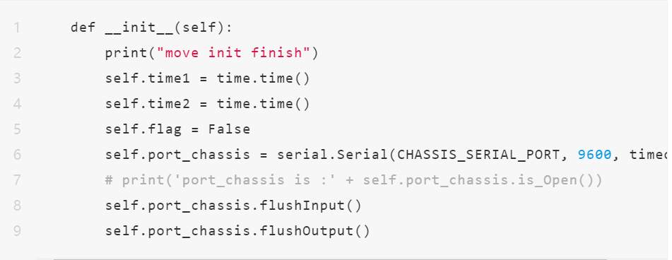

有了上面几个函数之后,就可以开始写python脚本啦,结合代码来进行分析
. g. ~8 V* u! W) I1 m7 U4 z首先是类的初始化函数,目的主要是初始化USART(UART)的波特率" ~$ a) O2 z  |2 ~( i0 A
  1. <font face="微软雅黑" size="3">def __init__(self):& P2 z/ `) I6 \  Q& j; ~: H
  2.         print("move init finish"), L5 A& x  _3 n$ m) R
  3.         self.time1 = time.time()
    + H& L" p2 U: J: v" c
  4.         self.time2 = time.time()
    $ V1 w, D" T9 v2 d; q
  5.         self.flag = False& a( g0 V$ T! X% X, M
  6.         self.port_chassis = serial.Serial(CHASSIS_SERIAL_PORT, 9600, timeout=1)4 ?- ^" f( ?- j4 Z9 j0 ^9 M& o
  7.         # print('port_chassis is :' + self.port_chassis.is_Open())2 S  h# @7 q. a7 ^
  8.         self.port_chassis.flushInput()
    5 i* Y; B% D6 \$ o* ]& ]7 j
  9.         self.port_chassis.flushOutput()</font>
