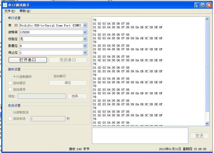

本程序利用STM32F4的硬件IIC实现对AT24C02的任何操作!!

   GPIO_ResetBits(GPIOE,(GPIO_Pin_0|GPIO_Pin_1|GPIO_Pin_2|GPIO_Pin_3));  //可以通过观察LED的状态判断写入和读取的数值相等不
  Bsp_Init();
 //单字节的读与写
  IIC_Write_AT24C02_OneByte(200,0x78);
  IIC_Waite_AT24C02_Standby();
  I2C_Data=IIC_Read_AT24C02_OneByte(200);
  if(I2C_Data==0x78)
   GPIO_SetBits(GPIOE,(GPIO_Pin_0));
 //页写和连续读取
  IIC_AT24C02_PageWrite(p,2,8);
  IIC_AT24C02_PageRead(q,2,8);
  if(PageRead[1]==2)
   GPIO_SetBits(GPIOE,(GPIO_Pin_1));
 //连续写与读
  IIC_AT24C02_BufferWrite(r,15,15);
  IIC_AT24C02_PageRead(s,15,15);
  WriteSum=SequenceWrite_Checksum();
  ReadSum=SequenceRead_Checksum();
  if(WriteSum==ReadSum)
    GPIO_SetBits(GPIOE,(GPIO_Pin_2));
 while(1)
   USART_SendData(USART3,I2C_Data);
     while (USART_GetFlagStatus(USART3, USART_FLAG_TC) == RESET);
     Delay(10000000);
   for(i=0;i
