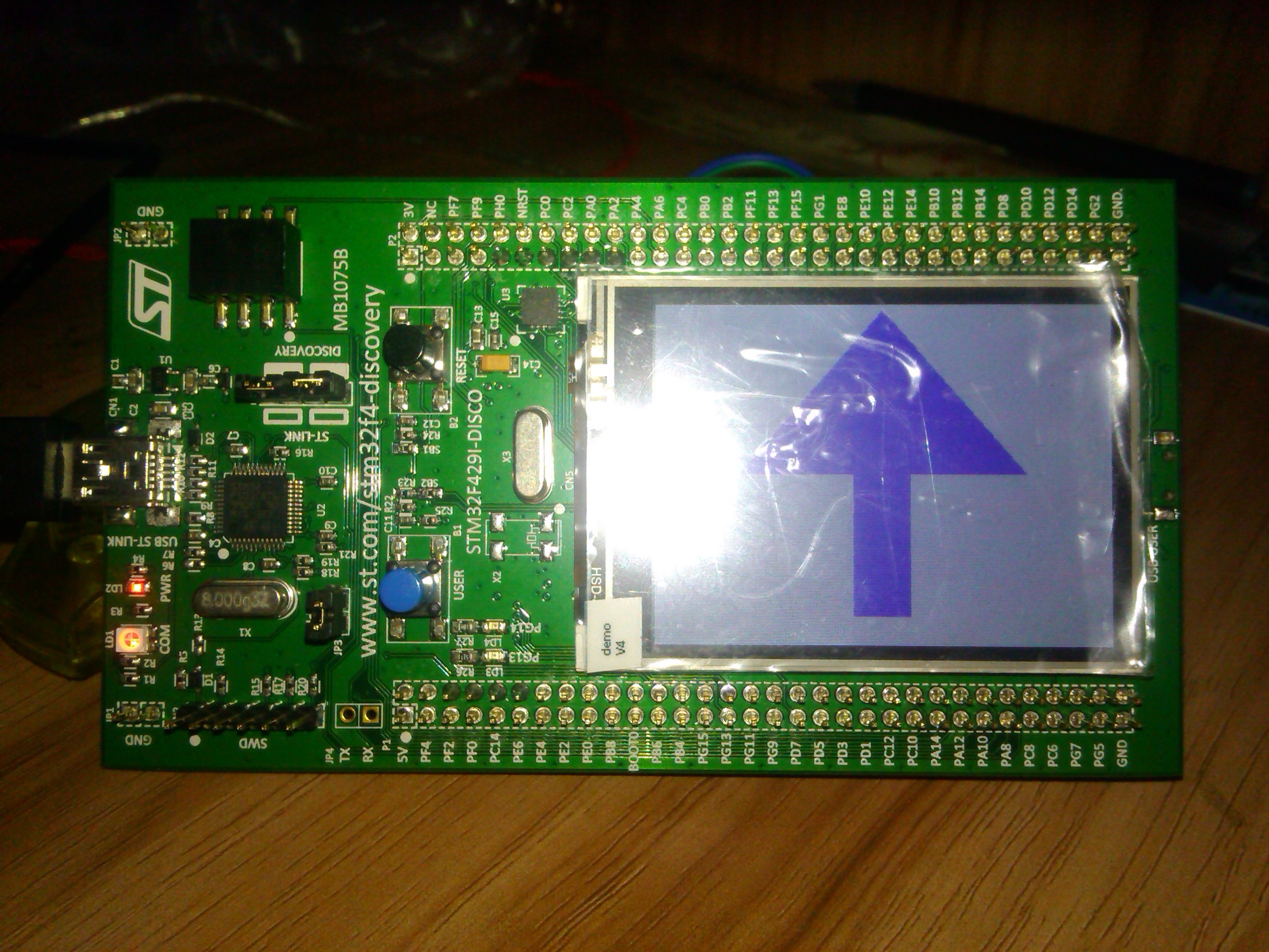

【STM32F429开发日志】3.板载mems测试,三轴角加速度Printf输出
caizhiwei 提问时间:2014-5-30 23:09 /
 硬件平台:STM32F429I-DISCORVERY

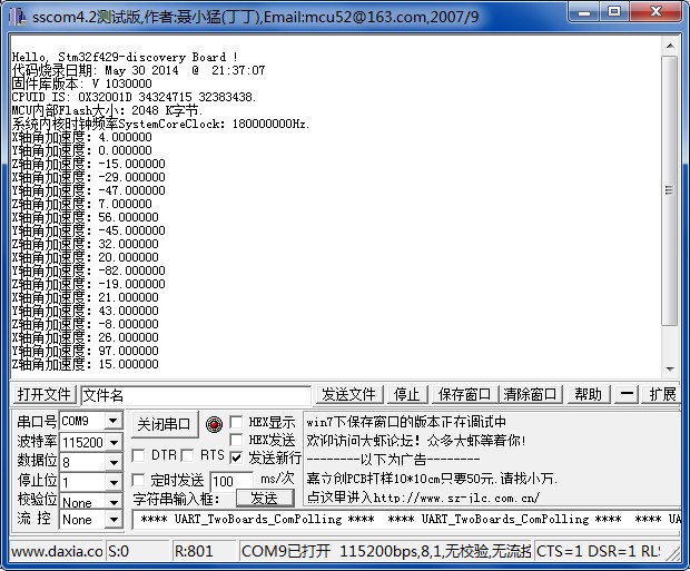

        printf("\n\rHello, Stm32f429-discovery Board ! \n\r");
        printf("\n\r代码烧录日期: "__DATE__"  @  "__TIME__"\n\r");
        printf("\n\r固件库版本: V %x \n\r",__STM32F4XX_STDPERIPH_VERSION);
        printf("\n\rCPUID IS: 0X%X %X %X.\n\r", *(__IO u32*)(0x1FFF7A10),*(__IO u32*)(0x1FFF7A14),*(__IO u32*)(0x1FFF7A18));
        printf("\n\rMCU内部Flash大小:%d K字节.\n\r", *(uint16_t*)(0x1FFF7A22));
        printf("\n\r系统内核时钟频率SystemCoreClock:%dHz.\n\r",SystemCoreClock);

  Demo_GyroConfig();   /* Gyroscope configuration */
  Gyro_SimpleCalibration(Gyro);  /* Gyroscope 校准*/
  printf("\n\r陀螺仪L3GD20 ID :0x%x \n\r",L3GD20_ReadID());
  while (1)
                        /* Read Gyro Angular data ,to save in Buffer[6]*/
                        Demo_GyroReadAngRate(Buffer);
                        Buffer[0] = (int8_t)Buffer[0] - (int8_t)Gyro[0];  //x
                        Buffer[1] = (int8_t)Buffer[1] - (int8_t)Gyro[1];  //Y
                        Buffer[2] = (int8_t)Buffer[2] - (int8_t)Gyro[2];  //Z
                        /* Update autoreload and capture compare registers value*/
                        Xval = ABS((int8_t)(Buffer[0]));
                        Yval = ABS((int8_t)(Buffer[1]));
                        if ( Xval>Yval)
                                if ((int16_t)Buffer[0] > 40)
                                        /* Clear the LCD */
                                        LCD_Clear(LCD_COLOR_WHITE);
                                        LCD_SetTextColor(LCD_COLOR_MAGENTA);
                                        LCD_DrawFullRect(100, 40, 40, 120);
                                        LCD_FillTriangle(50, 190, 120, 160, 160, 310);
                                        Delay(50);
                                if ((int16_t)Buffer[0] < -40)
                                        /* Clear the LCD */
                                        LCD_SetTextColor(LCD_COLOR_RED);
                                        LCD_DrawFullRect(100, 160, 40, 120);
                                        LCD_FillTriangle(50, 190, 120, 160, 160, 10);
                                        Delay(50);
                        else
                                if ((int16_t)Buffer[1] < -40)
                                        /* Clear the LCD */
                                        LCD_SetTextColor(LCD_COLOR_GREEN);
                                        LCD_DrawFullRect(120, 140, 100, 40);
                                        LCD_FillTriangle(120, 120, 5, 60, 260, 160);
                                        Delay(50);
                                if ((int16_t)Buffer[1] > 40)
                                        /* Clear the LCD */
                                        LCD_SetTextColor(LCD_COLOR_BLUE);
                                        LCD_DrawFullRect(20, 140, 100, 40);
                                        LCD_FillTriangle(120, 120, 235, 60, 260, 160);
                                        Delay(50);

caizhiwei 回答时间:2014-5-30 23:12:43
RE:【STM32F429开发日志】3.板载mems测试,三轴角加速度Printf输出
沙发!呵呵,串口可以输出三轴的
