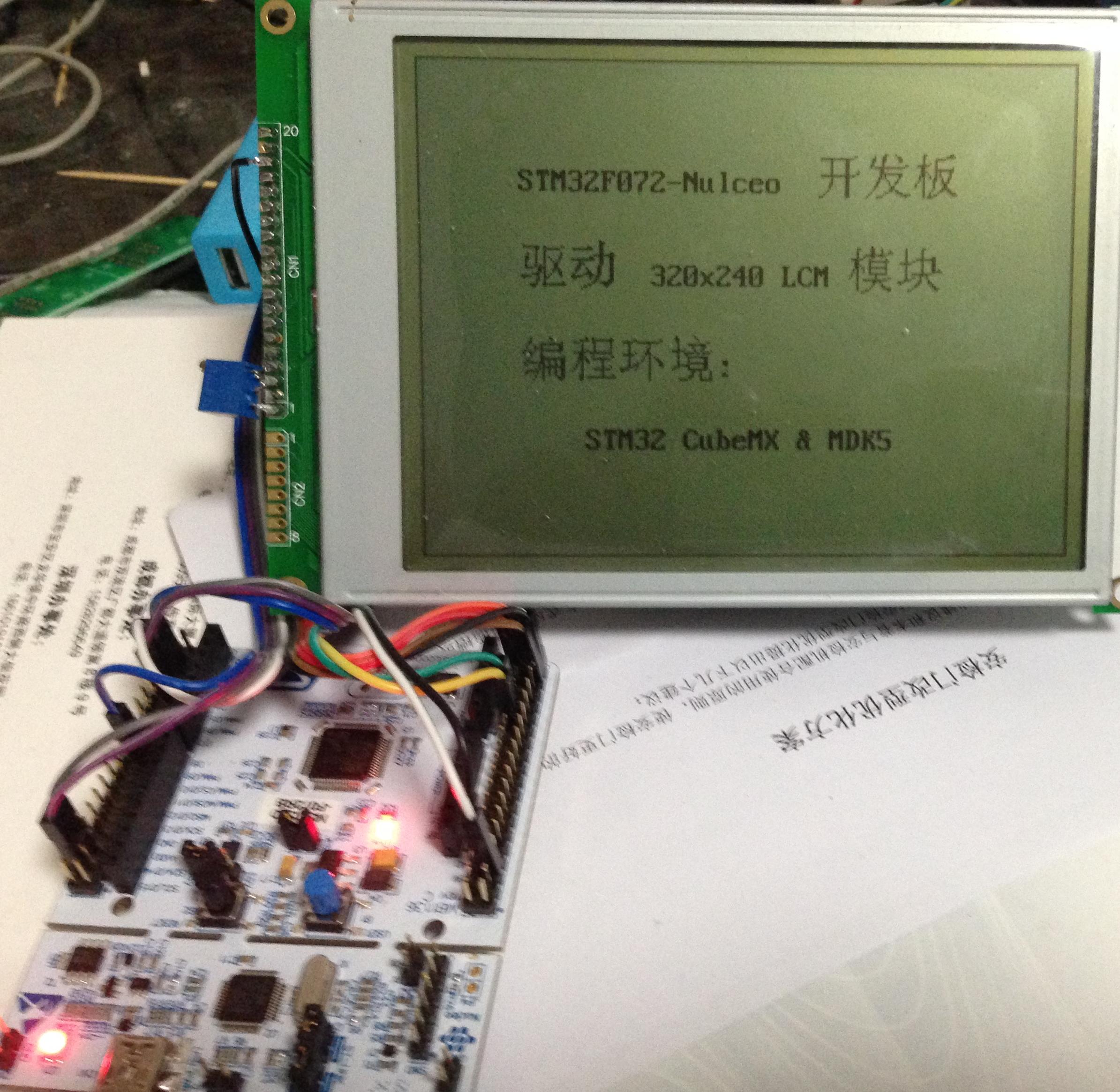

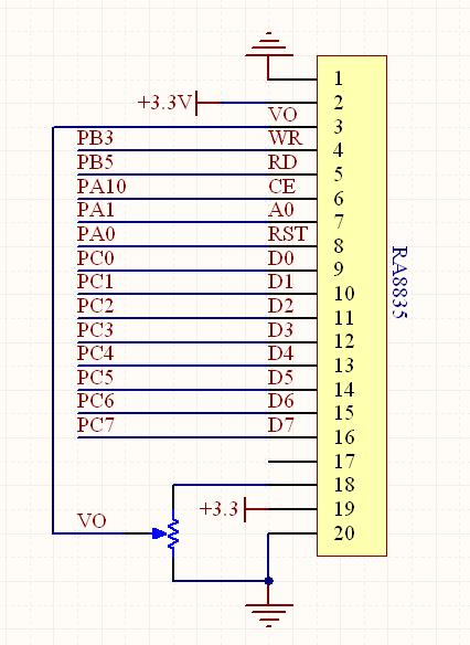

    手头有1片RA8835主控芯片的320X240图形液晶模块,决定拿它在STM32F072 Nucleo 开发板上试用看看。使用杜邦连接线进行连接,见下图:
    进入STM32CubeMX 花费2分钟简单配置了相关GPIO口为推挽输出,导入MDK5。在MDK5中添加驱动RA8835的相关函数,,并为要显示的汉字提取了字模。显示效果见下图:
    控制RA8835的GPIO口的位操作采用以下预定义:
#define        cs_H HAL_GPIO_WritePin(GPIOA,GPIO_PIN_10,GPIO_PIN_SET)
#define        cs_L HAL_GPIO_WritePin(GPIOA,GPIO_PIN_10,GPIO_PIN_RESET)
#define        a0_H HAL_GPIO_WritePin(GPIOA,GPIO_PIN_1,GPIO_PIN_SET)
#define        a0_L HAL_GPIO_WritePin(GPIOA,GPIO_PIN_1,GPIO_PIN_RESET)
#define        wr_H HAL_GPIO_WritePin(GPIOB,GPIO_PIN_3,GPIO_PIN_SET)
#define        wr_L HAL_GPIO_WritePin(GPIOB,GPIO_PIN_3,GPIO_PIN_RESET)
#define        rst_H HAL_GPIO_WritePin(GPIOA,GPIO_PIN_0,GPIO_PIN_SET)
#define        rst_L HAL_GPIO_WritePin(GPIOA,GPIO_PIN_0,GPIO_PIN_RESET)
#define        rd_H HAL_GPIO_WritePin(GPIOB,GPIO_PIN_5,GPIO_PIN_SET)
#define        rd_L HAL_GPIO_WritePin(GPIOB,GPIO_PIN_5,GPIO_PIN_RESET)
