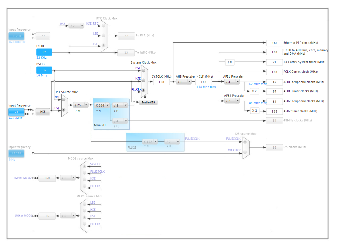

基于cube的stm32f407定时器应用,125ms定时,晶振25M
stm32_beginner 发布时间:2015-1-8 09:14
本帖最后由 stm32_beginner 于 2015-1-8 09:20 编辑 + A& J+ W8 B$ c. `
0 x( L1 t, e8 F: O3 x* J3 r基于cube的stm32f407定时器应用,125ms定时,晶振25M( }0 N- e! e; x7 N8 f- n
' E' U! V$ |7 X. F$ o- K时钟配置:

定时器初始化:
+ }7 K1 R! p: @, K  Q6 m  R/* TIM6 init function */
: ?- U6 w& N/ p4 |4 rvoid MX_TIM6_Init(void)+ l" X) X/ T6 j9 I6 r0 L
6 i! y. G) |0 R, i/ [        ; F4 u% Q& @0 T7 B6 m" r- b6 w  {
        /* -----------------------------------------------------------------------8 D2 r6 \1 P6 I+ P# O" l8 Q# I4 C
    In this example TIM3 input clock (TIM3CLK) is set to 2 * APB1 clock (PCLK1), 6 }/ X. q4 y/ }- D; @5 Q' ]3 I3 ~1 Z* E
    since APB1 prescaler is different from 1.   9 f9 U; C, }6 x( \, b& F! n+ h8 E
      TIM3CLK = 2 * PCLK1  ; F. f- }% `" T  C
      PCLK1 = HCLK / 4 3 x# O: F2 Z6 }1 U+ S' l. E, k
      => TIM3CLK = HCLK / 2 = SystemCoreClock /2 =84
9 r6 m! a; i8 w/ q0 {9 Z- N  U: ]    To get TIM3 counter clock at 10 KHz, the Prescaler is computed as following:
  h9 w5 Q$ j; Y/ h* P/ [  O5 ?    Prescaler = (TIM3CLK / TIM3 counter clock) - 1
& f" V7 x" p; D1 |3 j6 {9 y9 B) N    Prescaler = ((SystemCoreClock /2) /10 KHz) - 1

2 t! U) l; i1 c" j% ~- I* @. L% ]) `  /* Compute the prescaler value to have TIM3 counter clock equal to 10 KHz */, h/ U& Y: R3 f& t  a# b$ \# \8 `5 T2 |
  uwPrescalerValue = (uint32_t) ((SystemCoreClock /2) / 10000) - 1;                        //10KHz·ÖƵ 1ÃëÖÓ10000´Î
  [$ b# \/ l/ @  F  j: g. w% c1 c0 B
