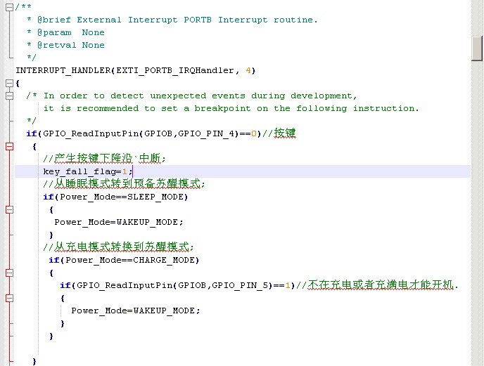

  * @brief External Interrupt PORTB Interrupt routine.
  * @param  None
  * @retval None
INTERRUPT_HANDLER(EXTI_PORTB_IRQHandler, 4)
是不是这里问题?
中断入口错了?
