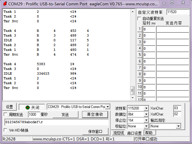

caizhiwei 发布时间:2015-3-13 13:56
       根据ARMFlY的STM32F4的例程修改而来,本来想搞搞V820版本的移植的,发现移植之后编译出现一大堆错误,很是郁闷。  z8 Y& R" N& B: N# Z
      不过总算是修改成功了,一共有四个任务,包括点灯和串口Printf输出,接下来就可以好好研究了,庖丁解牛之,嘿嘿~
' {$ S! j6 C6 S/ L. N3 ~3 ~  X QQ截图20150313134946.jpg
, {# _& ?! h6 }( l5 ~# U# A9 V" a1 t附件请稍等~正在整理压缩~, T. O9 W( y* X; I" m

caizhiwei 回答时间:2015-4-27 13:05:57
通过任务参数传入需要打印输出的文本:+ R5 w# A) [3 N5 E2 Y! a

    ( v' S+ ^$ ~0 x
  176.                     (void*)pcTextForTask1,       /*通过任务参数传入需要打印输出的文本. */
    / }% ~) j3 I3 m6 F
  177.                     1,          /* This task will run at priority 1.                              */
    ( a6 E8 j. O- X
  178.                     NULL );     /* We are not using the task handle.                              */
    / b8 Z0 h: v- s( M9 ~: E, ^
  179. , N1 x5 F- R% B3 o" {
  180.     /* Create one task. */1 v( ~5 ]' w; w/ x! {& M4 C: ]
  181.     xTaskCreate(    vTask2,     /* Pointer to the function that implements the task. */
    ' Q+ o- p" H4 p0 s6 I
  182.                     "Task 2",   /* Text name for the task.  This is to facilitate debugging only. */% Z: I# Q+ \7 V$ S" e
  183.                     500,        /* Stack depth in words.                                          */
    6 e1 W' _% ]( ^* p% ~- h
  184.                     NULL,       /* We are not using the task parameter.                           */# Z/ A* v9 Z- z! j
  185.                     2,          /* This task will run at priority 2.                              */
      Z% o$ g( Q) D# W2 ]" I/ |1 M
  186.                     NULL );     /* We are not using the task handle.                              */
    % [+ H0 l) h: ^8 h; G" m% k
  187.         ; o( B& z; a# e" V% F+ B' X
  188.          /* Create one task. */( {& b- `! t. p1 v# W) {0 T" C; |
  189.     xTaskCreate(    vTask3,     /* Pointer to the function that implements the task. */
    / A+ }; |! @- r: L, f' p
  190.                     "Task 3",   /* Text name for the task.  This is to facilitate debugging only. */- D2 |: }+ v- _7 ?' K' k3 H; |
  191.                     500,        /* Stack depth in words.                                          */+ T. |5 g: h" H2 d
  192.                     NULL,       /* We are not using the task parameter.                           */* b  y. a/ S$ P
  193.                     3,          /* This task will run at priority 2.                              */7 z1 V2 z4 t: \; l1 W# s
  194.                     &xHandleTask3 );    1 n# f. l+ I, R! Z$ x' S# C
  195.         " f9 {% f; n% u4 ?; Z5 O: N( S
  196.         /* Create one task. */2 J5 }# h1 y& [* A6 n! g4 N
  197.     xTaskCreate(    vTask4,     /* Pointer to the function that implements the task. */
    % D7 ^3 S3 Y: }3 d
  198.                     "Task 4",   /* Text name for the task.  This is to facilitate debugging only. */; G9 U- _) l  f
  199.                     500,        /* Stack depth in words.                                          */
    $ G" S. R7 C5 a% R- S  t5 Y& A
  200.                     NULL,       /* We are not using the task parameter.                           */
    & |* t, |  @2 T* E. }
  201.                     4,          /* This task will run at priority 2.                              */
    8 @2 @) o3 z4 L& i% O
  202.                     NULL );     /* We are not using the task handle.                              */                                5 w) U6 ]% f; p$ y% C* b
  203. }
