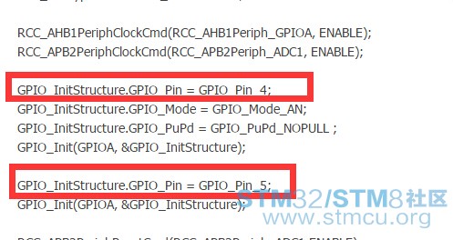

ADC程序如下:
void ADCInit(void)
  GPIO_InitTypeDef  GPIO_InitStructure;
  ADC_CommonInitTypeDef ADC_CommonInitStructure;
  ADC_InitTypeDef       ADC_InitStructure;
  RCC_AHB1PeriphClockCmd(RCC_AHB1Periph_GPIOA, ENABLE);
  RCC_APB2PeriphClockCmd(RCC_APB2Periph_ADC1, ENABLE);
  GPIO_InitStructure.GPIO_Pin = GPIO_Pin_4;
  GPIO_InitStructure.GPIO_Mode = GPIO_Mode_AN;
  GPIO_InitStructure.GPIO_PuPd = GPIO_PuPd_NOPULL ;
  GPIO_Init(GPIOA, &GPIO_InitStructure);
  GPIO_InitStructure.GPIO_Pin = GPIO_Pin_5;
  RCC_APB2PeriphResetCmd(RCC_APB2Periph_ADC1,ENABLE);
  RCC_APB2PeriphResetCmd(RCC_APB2Periph_ADC1,DISABLE);
  ADC_CommonInitStructure.ADC_Mode = ADC_Mode_Independent;
  ADC_CommonInitStructure.ADC_TwoSamplingDelay = ADC_TwoSamplingDelay_5Cycles;
  ADC_CommonInitStructure.ADC_DMAAccessMode = ADC_DMAAccessMode_Disabled;
  ADC_CommonInitStructure.ADC_Prescaler = ADC_Prescaler_Div4;
  ADC_CommonInit(&ADC_CommonInitStructure);
  ADC_InitStructure.ADC_Resolution = ADC_Resolution_12b;
  ADC_InitStructure.ADC_ScanConvMode = DISABLE;
  ADC_InitStructure.ADC_ContinuousConvMode = DISABLE;
  ADC_InitStructure.ADC_ExternalTrigConvEdge = ADC_ExternalTrigConvEdge_None;
  ADC_InitStructure.ADC_DataAlign = ADC_DataAlign_Right;
  ADC_InitStructure.ADC_NbrOfConversion = 1;
  ADC_Init(ADC1, &ADC_InitStructure);
  ADC_Cmd(ADC1, ENABLE);
u16 Get_Adc(u8 ch)
        ADC_RegularChannelConfig(ADC1, ch, 1, ADC_SampleTime_480Cycles );
        ADC_SoftwareStartConv(ADC1);
        while(!ADC_GetFlagStatus(ADC1, ADC_FLAG_EOC ));
        return (ADC_GetConversionValue(ADC1));
程序有时会死在while(!ADC_GetFlagStatus(ADC1, ADC_FLAG_EOC ))中,大家有没有遇到这个问题。通过仿真看到ADC_SR值为0x00000030,表示发生溢出。

用这个标志位判断没问题,多做个处理,如果发生了溢出,清除一下溢出错误,再进行数据采集。
可能是没有及时读取完成数据导致的。
huaiqiao 回答时间:2015-12-24 00:23:04
楼主这个地方,您到底是用ADC1的那个引脚呢?
