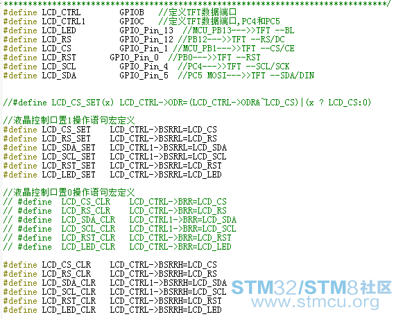

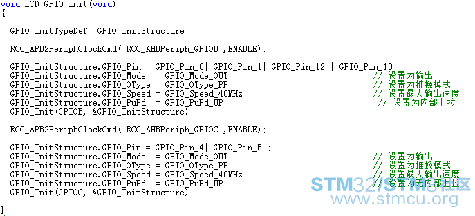

TFT屏幕为2.8寸屏幕,SPI接口,采用GPIO模拟。想请教下端口配置是否正确? |

应改为RCC_AHBPeriphClockCmd( RCC_AHBPeriph_GPIOC ,ENABLE);
