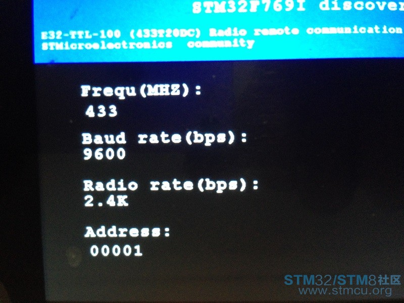

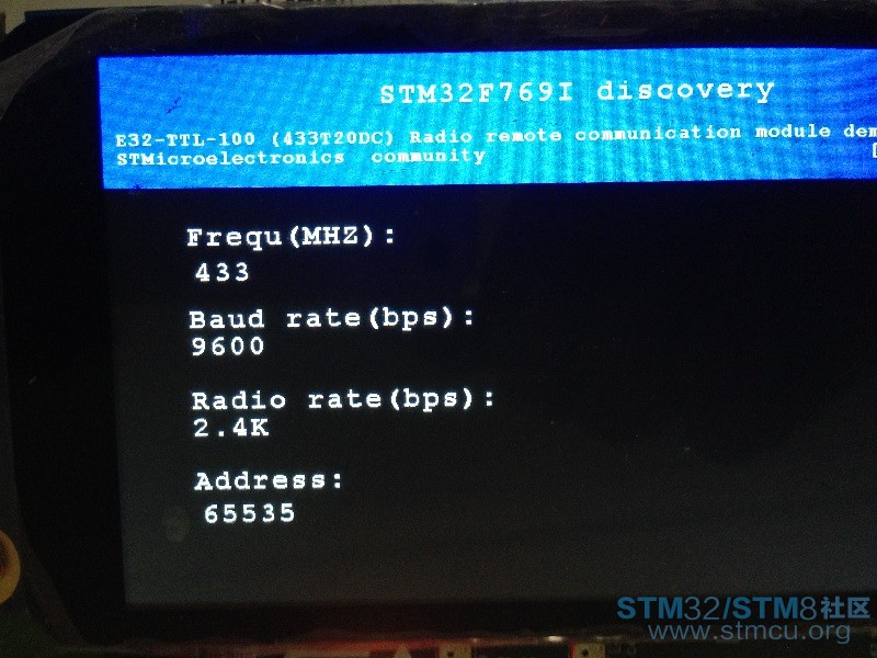

本例:Write_SX1276(0xffff,0x17);运行结果如下:
Write_SX1276(0x01,0x17);
  1. void Write_SX1276(uint16_t address,uint8_t frequ)
  2. {
  3.         Get_SX1276();
  4.         Tx_buffer[0]=0xc0;
  5.         Tx_buffer[1]=(address>>8)&0xff;
  6.         Tx_buffer[2]=address&0xff;
  7.         Tx_buffer[3]=Rx_buffer[3];
  8.         Tx_buffer[4]=frequ;
  9.         Tx_buffer[5]=Rx_buffer[5];
  10.
  11.         M0_H;
  12.         M1_H;
  13.         HAL_Delay(200);
  14.         RxCount=0;
  15.         HAL_UART_Transmit(&UartHandle, (uint8_t*)Tx_buffer, 0X06,5000);
  16.         while(Rx_Ok==0x00);
  17.         Rx_Ok=0x00;
  18.         Get_SX1276();
  19. }
