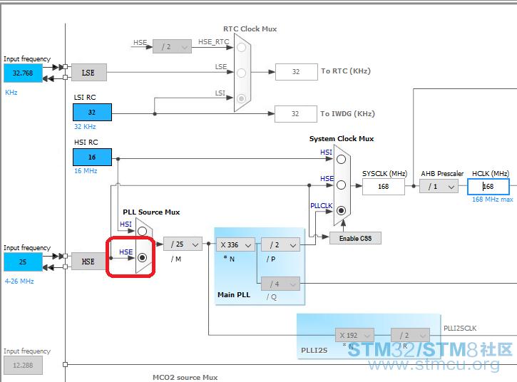

HSE如果没有使能当然不起振了:
不过这个F405的LSE在CubeMX中好像使能不了,选项是灰色的。
  1. void SystemClock_Config(void)
  2. {
  3.   RCC_OscInitTypeDef RCC_OscInitStruct;
  4.   RCC_ClkInitTypeDef RCC_ClkInitStruct;
  5.     /**Configure the main internal regulator output voltage
  6.     */
  7.   __HAL_RCC_PWR_CLK_ENABLE();
  8.   __HAL_PWR_VOLTAGESCALING_CONFIG(PWR_REGULATOR_VOLTAGE_SCALE1);
  9.     /**Initializes the CPU, AHB and APB busses clocks
  10.     */
  11.   RCC_OscInitStruct.OscillatorType = RCC_OSCILLATORTYPE_HSE;
  12.   RCC_OscInitStruct.HSEState = RCC_HSE_ON;
  13.   RCC_OscInitStruct.PLL.PLLState = RCC_PLL_ON;
  14.   RCC_OscInitStruct.PLL.PLLSource = RCC_PLLSOURCE_HSE;
  15.   RCC_OscInitStruct.PLL.PLLM = 25;
  16.   RCC_OscInitStruct.PLL.PLLN = 336;
  17.   RCC_OscInitStruct.PLL.PLLP = RCC_PLLP_DIV2;
  18.   RCC_OscInitStruct.PLL.PLLQ = 4;
  19.   if (HAL_RCC_OscConfig(&RCC_OscInitStruct) != HAL_OK)
  20.   {
  21.     _Error_Handler(__FILE__, __LINE__);
  22.   }
  23.     /**Initializes the CPU, AHB and APB busses clocks
  24.     */
  25.   RCC_ClkInitStruct.ClockType = RCC_CLOCKTYPE_HCLK|RCC_CLOCKTYPE_SYSCLK
  26.                               |RCC_CLOCKTYPE_PCLK1|RCC_CLOCKTYPE_PCLK2;
  27.   RCC_ClkInitStruct.SYSCLKSource = RCC_SYSCLKSOURCE_PLLCLK;
  28.   RCC_ClkInitStruct.AHBCLKDivider = RCC_SYSCLK_DIV1;
  29.   RCC_ClkInitStruct.APB1CLKDivider = RCC_HCLK_DIV4;
  30.   RCC_ClkInitStruct.APB2CLKDivider = RCC_HCLK_DIV2;
  31.   if (HAL_RCC_ClockConfig(&RCC_ClkInitStruct, FLASH_LATENCY_5) != HAL_OK)
  32.   {
  33.     _Error_Handler(__FILE__, __LINE__);
  34.   }
  35.     /**Configure the Systick interrupt time
  36.     */
  37.   HAL_SYSTICK_Config(HAL_RCC_GetHCLKFreq()/1000);
  38.     /**Configure the Systick
  39.     */
  40.   HAL_SYSTICK_CLKSourceConfig(SYSTICK_CLKSOURCE_HCLK);
  41.   /* SysTick_IRQn interrupt configuration */
  42.   HAL_NVIC_SetPriority(SysTick_IRQn, 0, 0);
  43. }
