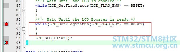

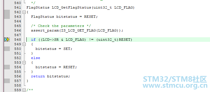

确认过板子的硬件没有问题,能用IO口直接驱动点亮。用芯片内部驱动就会出问题。以下是我的初始化代码: void LCD_GLASS_Init(void) { LCD_InitTypeDef LCD_InitStructure; LCD_GPIOConfig(); /*!< Configure the LCD Glass GPIO pins */ /*!< Configure the LCD interface -------------------------------------------*/ RCC_APB1PeriphClockCmd(RCC_APB1Periph_LCD, ENABLE); /*!< Enable LCD APB1 Clock */ LCD_InitStructure.LCD_Prescaler = LCD_Prescaler_8; LCD_InitStructure.LCD_Divider = LCD_Divider_16; LCD_InitStructure.LCD_Duty = LCD_Duty_1_8; LCD_InitStructure.LCD_Bias = LCD_Bias_1_4; LCD_InitStructure.LCD_VoltageSource = LCD_VoltageSource_Internal; LCD_Init(&LCD_InitStructure); //LCD_HighDriveCmd(ENABLE); /*!< Configure the Pulse On Duration*/ LCD_PulseOnDurationConfig(LCD_PulseOnDuration_2); /*!< Configure the LCD Contrast (3.51V) */ LCD_ContrastConfig(LCD_Contrast_Level_4); /*!< Wait Until the LCD FCR register is synchronized */ LCD_WaitForSynchro(); /*!< Enable LCD peripheral */ LCD_Cmd(ENABLE); /*!< Wait Until the LCD is enabled */ while(LCD_GetFlagStatus(LCD_FLAG_ENS) == RESET) { } /*!< Wait Until the LCD Booster is ready */ while(LCD_GetFlagStatus(LCD_FLAG_RDY) == RESET) { } } |

卡在那一步,从手册看是没有同步,在我加入RTC时钟之后就不会卡在那里了。
那应该是时钟源选择了。谢谢!
