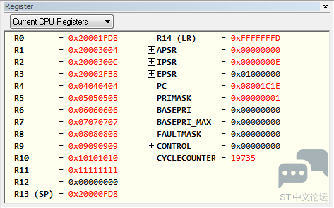

然后就是PendSV上下文切换中的堆栈操作了,如果不使用FPU,则进入异常自动压栈xPSR,PC,LR,R12,R0-R3,我们还要把R4-R11入栈。如果开启了FPU,自动压栈的寄存器还有S0-S15,还需吧S16-S31压栈。
  1. MRS     R0, PSP
    1 v) m. Y! {1 D+ M4 q( W/ @
  2.     SUBS   R0, R0, #0x20        ;压入R4-R11
    4 L% f2 C% L+ b! K
  3.     STM     R0, {R4-R11}" n# E# D7 m! L! ]7 J+ t
  4. * ?7 A7 v4 P4 A9 g2 \: I8 Y9 K
  5.     LDR     R1, =Cur_TCB_Point    ;当前任务的指针5 p3 [1 }: f* J, s3 p, v4 R6 M$ [% q3 Y
  6.     LDR     R1, [R1]! m, h, F. Y* ]2 Q0 V
  7.     STR     R0, [R1]            ; 更新任务堆栈指针
' c5 O# Z/ M' L  W* I- a, h" w
出栈类似,但要注意顺序
  1. LDR     R1, =TCB_Point    ;要切换的任务指针
    0 J3 Q7 [$ I3 R' h' p
  2.     LDR     R2, [R1]* z0 h; P- n0 G; g) `* ^+ ]
  3.     LDR     R0, [R2]          ; R0为要切换的任务堆栈地址
    3 v( L8 _. ^7 j$ s
  4.
    - C# i  v  H) `1 a$ F( C  X
  5.     LDM     R0, {R4-R11}     ; 弹出R4-R118 R% U. U: A" }. A  Y7 U
  6.     ADDS    R0, R0, #0x20" _' K' K% x% \
  7. 6 g8 N4 d. c- g
  8.     MSR     PSP, R0        ;更新PSP
5 n  `1 \/ ]! F' z

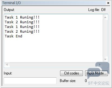

三、OS实战
新建os_port.asm文件,内容如下:
  1. NVIC_INT_CTRL   EQU     0xE000ED04                              ; Interrupt control state register.( ^! z1 G6 t2 R5 a9 R# Z" x
  2. NVIC_SYSPRI14   EQU     0xE000ED22                              ; System priority register (priority 14).
    + [4 g( C' J9 e5 }
  3. NVIC_PENDSV_PRI EQU           0xFF                              ; PendSV priority value (lowest).
    / P9 d) A8 @( j% @; O
  4. NVIC_PENDSVSET  EQU     0x10000000                              ; Value to trigger PendSV exception.
    # A7 f- h0 m: @  s2 h5 s
  5. 2 b: O( E/ E( T7 P! ~2 k
  6.   RSEG CODE:CODE:NOROOT(2)
    $ c' u3 e$ a4 ~5 o* L+ s
  7.   THUMB. g% b6 U3 Q& `3 H
  8. ' u- P0 Y0 ]/ C
  9. ( [8 y+ @. s4 C
  10.   EXTERN  g_OS_CPU_ExceptStkBase7 U% {) C+ B6 F0 b
  11.   , _* |0 F. A: n4 D" ?/ K
  12.   EXTERN  g_OS_Tcb_CurP
    $ W; e$ e/ a. S* O
  13.   EXTERN  g_OS_Tcb_HighRdyP% X) d1 ~" ]' T  z/ @; V5 o
  14. / l- S3 q3 z9 q' }$ t$ ^
  15.   PUBLIC OSStart_Asm
    " s7 }. _, ]3 J4 I7 _6 m: X
  16.   PUBLIC PendSV_Handler) f- u$ |7 g; Q: c# V9 ]
  17.   PUBLIC OSCtxSw# p  b, v- _9 _, \4 [, s
  18. + u! E! J/ w; `( q& m  V) T" a6 i
  19. OSCtxSw
    + S3 t! S; y8 o& l
  20.     LDR     R0, =NVIC_INT_CTRL
    , q1 X, R3 A1 p  x# h
  21.     LDR     R1, =NVIC_PENDSVSET
    # d4 F+ R& G' A2 z7 F
  22.     STR     R1, [R0]- d' g6 @- }+ e4 {
  23.     BX      LR                                                ; Enable interrupts at processor level
    9 `; x( \6 \" D/ i
  24. 8 |9 N9 {8 n. i, d: T8 ]! j
  25. OSStart_Asm- Q3 T- l% p. ?! n/ |* T
  26.     LDR     R0, =NVIC_SYSPRI14                                  ; Set the PendSV exception priority4 s3 V; Z4 ^: C3 L! n# w8 E. K; C
  27.     LDR     R1, =NVIC_PENDSV_PRI
    1 R8 _# |) d- P$ J$ c* A
  28.     STRB    R1, [R0]
    * x' w  Q1 _3 b! S1 n
  29. ( f1 h0 C$ Z! P: s% H
  30.     MOVS    R0, #0                                              ; Set the PSP to 0 for initial context switch call! y6 K" |% E- A
  31.     MSR     PSP, R0
    " E' C2 M1 `% E3 @/ I: Q0 M
  32. ' h$ _2 b2 w  [: \5 r8 q
  33.     LDR     R0, =g_OS_CPU_ExceptStkBase                           ; Initialize the MSP to the OS_CPU_ExceptStkBase
    / K0 I" X  S1 x9 j2 t7 q; |
  34.     LDR     R1, [R0]
    ' k; w( i1 V7 B3 c/ {, x6 B
  35.     MSR     MSP, R1
    ; ~& h4 m' c* r/ ?) K. S2 G
  36. ( a$ v, B& m; I) M2 _* W. X/ l. \
  37.     LDR     R0, =NVIC_INT_CTRL                                  ; Trigger the PendSV exception (causes context switch)
    4 y, U2 L( i2 D7 W4 m, q9 F
  38.     LDR     R1, =NVIC_PENDSVSET
    2 L8 p. q6 G! q  g8 q- l9 c
  39.     STR     R1, [R0]
    + H; I" U  B8 b- f1 l% z. A6 c
  40. , y) H! I( U" [! ?$ ?
  41.     CPSIE   I                                                   ; Enable interrupts at processor level
    , S- s  R3 C& n: _* O* `5 B
  42. % B% Z; w# c7 x6 v
  43. OSStartHang
    ' e3 x* G; x# `- Y
  44.     B       OSStartHang                                         ; Should never get here& q9 u6 ~" u. W8 c
  45.     5 F- S8 a, f+ b
  46.     7 k) b( W. o/ G1 F2 n( `- c) E
  47. - P5 K$ |  Y# e1 [1 g9 c
  48. PendSV_Handler' P5 _& C, q% a' M7 v% g
  49.     CPSID   I                                                   ; Prevent interruption during context switch
    7 H* q8 Y  e# N3 N# f& q
  50.     MRS     R0, PSP                                             ; PSP is process stack pointer
    ! j5 y+ p9 c% B7 ^, N$ k
  51.     CBZ     R0, OS_CPU_PendSVHandler_nosave                     ; Skip register save the first time
    2 A% X' ?  I& U" n) ]5 i
  52.
    + D6 ~3 F% U) [$ r2 U
  53.     SUBS    R0, R0, #0x20                                       ; Save remaining regs r4-11 on process stack3 \5 ^" j+ m1 U/ J
  54.     STM     R0, {R4-R11}* w1 A( m$ _. m+ R$ b$ E
  55. 3 J: y! k! g0 x: {
  56.     LDR     R1, =g_OS_Tcb_CurP                                       ; OSTCBCur->OSTCBStkPtr = SP;5 N, n; D. l1 ~5 y
  57.     LDR     R1, [R1]
    , ?8 s4 Q( Y2 n9 N1 }' }9 W
  58.     STR     R0, [R1]                                            ; R0 is SP of process being switched out
    0 L* j6 Y2 \' b
  59. & q. {3 J) v) ]. l/ U$ `: L
  60.                                                                 ; At this point, entire context of process has been saved
    - ?2 n. @4 P7 O
  61. OS_CPU_PendSVHandler_nosave
      `: H) |2 q4 H2 O3 U2 v
  62.     LDR     R0, =g_OS_Tcb_CurP                                       ; OSTCBCur  = OSTCBHighRdy;3 @7 h; F# l1 p9 n( G( _0 W3 H) E, F5 _
  63.     LDR     R1, =g_OS_Tcb_HighRdyP4 X( v$ m5 c5 u% _  u& c6 X+ B; F
  64.     LDR     R2, [R1]2 v2 v! t% u3 a, o. ~% G
  65.     STR     R2, [R0]
      V8 ^- W( _+ C$ |  v
  66. 7 \% K2 w# z) @5 D1 W
  67.     LDR     R0, [R2]                                       ; R0 is new process SP; SP = OSTCBHighRdy->OSTCBStkPtr;2 h  R4 {3 C) B- `3 `% T
  68.   ( [! D5 e4 b$ z) X) G' P
  69.     LDM     R0, {R4-R11}                                        ; Restore r4-11 from new process stack
    ) k8 J( W0 ~- W0 G: m. c) @* v
  70.     ADDS    R0, R0, #0x20
    , C, B, s  D% Z( D' U% y
  71.             5 Y- i7 n4 q8 L9 T: D* ^, w
  72.     MSR     PSP, R0                                             ; Load PSP with new process SP+ f+ ]4 s( ]+ C
  73.     ORR     LR, LR, #0x04                                       ; Ensure exception return uses process stack" C6 H% [4 X0 b
  74.
    5 B' V9 u0 k/ ?! y
  75.     CPSIE   I% d: S( ~$ x9 G& b' f9 n1 \6 g! S8 w
  76.     BX      LR                                                  ; Exception return will restore remaining context
    / k, F( j6 M5 W1 x" M* j' z* T
  77.
    1 L, S4 K; h  G+ |
  78.     END
6 W& h% Q) v0 x9 f
main.c内容如下:
  1. #include "stdio.h") y/ o2 Q) T& \8 [$ l" X2 [$ b
  2. #define OS_EXCEPT_STK_SIZE 10248 m2 U1 q: p. C1 z# `: d% _! l5 a
  3. #define TASK_1_STK_SIZE 1024
    * Y, u' X+ B7 z1 v" h
  4. #define TASK_2_STK_SIZE 10248 A6 R( e. {+ t; h# l
  5. - P; r- N( y6 f% H+ x
  6. typedef unsigned int OS_STK;, b& l  ]+ k$ f' G: e# L5 R9 J
  7. typedef void (*OS_TASK)(void);2 [3 H; R- X7 s
  8. 3 d8 s& C# z* \$ R% r7 B1 X
  9. typedef struct OS_TCB
    . R: \( n8 X( K7 L  H% t- V" B
  10. {: T; U+ }' h& q7 ]: b3 {
  11.   OS_STK *StkAddr;
    * e2 W  b' T  \" ?
  12. }OS_TCB,*OS_TCBP;2 T! e% C  k- y% `. R0 \) O
  13. 1 L% [2 t7 g( X" X- Z6 X* q
  14. ! _% }9 d! ?5 H& N7 n
  15. OS_TCBP g_OS_Tcb_CurP; # p0 P& ?/ @5 M
  16. OS_TCBP g_OS_Tcb_HighRdyP;
    9 k9 P3 d4 P( C% f. V
  17. 1 m) e$ H. O# u- S/ z# h' s
  18. static OS_STK OS_CPU_ExceptStk[OS_EXCEPT_STK_SIZE];
    2 V* D! d+ q4 a4 I$ x
  19. OS_STK *g_OS_CPU_ExceptStkBase;
    2 m1 l5 w% X8 `  o
  20. ) k6 }. O# j: ?! _
  21. static OS_TCB TCB_1;+ e+ ?  N) n) Z7 V. z
  22. static OS_TCB TCB_2;; M# S  b- _: s0 B
  23. static OS_STK TASK_1_STK[TASK_1_STK_SIZE];, W1 m% I. {5 q) r4 m: ~# P
  24. static OS_STK TASK_2_STK[TASK_2_STK_SIZE];
    ( _1 X+ s3 \7 o8 P, X6 |/ ^" [( I. ?$ ^
  25. # o8 C) O" d' {
  26. extern void OSStart_Asm(void);
    : p( o- E( l# ~/ {3 F/ t
  27. extern void OSCtxSw(void);4 Q& d2 ?% ~( w+ r  [8 H+ T% Q, b+ E
  28. 8 D$ m3 V4 p1 x$ g
  29. void Task_Switch()
    + ^/ j$ L2 l; n$ @6 T% X7 U
  30. {; N( p% M4 p9 F3 h3 h2 L" R
  31.   if(g_OS_Tcb_CurP == &TCB_1)
    & ?9 Z# A0 F, V! Y
  32.     g_OS_Tcb_HighRdyP=&TCB_2;: Y. e) \) W0 h
  33.   else
    * x* o+ z7 [" l
  34.     g_OS_Tcb_HighRdyP=&TCB_1;8 M2 l4 S! c% V" X1 Y

编译下载并调试:
4 ]) f5 g/ U+ D
- g0 S$ u5 I& i5 w9 @. ]
在此处设置断点
此时寄存器的值,可以看到R4-R11正是我们给的值,单步运行几次,可以看到进入了我们的任务task_1或task_2,任务里打印信息,然后调用Task_Switch进行切换,OSCtxSw触发PendSV异常。
0 J# k: L* ?6 M  R) I& S
, r' ~8 @9 W) n$ B! f3 N6 |3 G* W& l$ z
IO输出如下:
% N5 Q$ P- V' T& z/ z6 Q
: u- o3 }7 ~: F1 T; Y& d; ]3 h8 Z0 i
至此我们成功实现了使用PenSV进行两个任务的互相切换。之后,我们使用使用SysTick实现比较完整的多任务切换。
