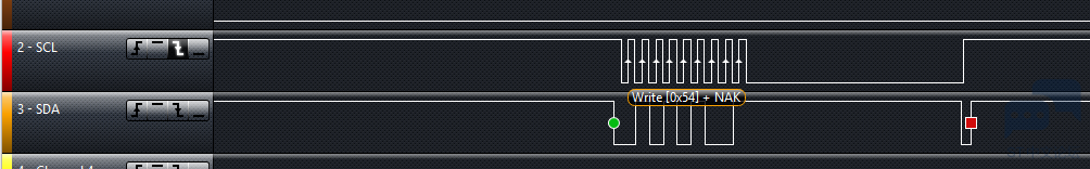

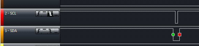

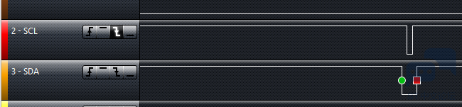

问题所在:主I2C在未收到ACK应答,会产生应答错误,SR1的AF位置1,在TIMEOUT时间后,上面的用户代码会调用I2C_GenerateSTOP(MASTER_I2C, ENABLE)函数,CR1的STOP为会被置位,导致出错

经验证,重新初始化I2C或复位CR1的STOP可以排除对下次发送数据的干扰,串口打印消息如下
  1. // Using mini_i2c_config()Program started!
    . M. R$ r4 K* s& L3 [, ^# N
  2. Master I2C SR1 is 400 and SR2 is 05 O" Y; |- z9 a' z: ]/ H
  3. Master I2C CR1 is 601 and CR2 is 24+ D2 C; v4 K% P% J; T1 X+ D) J
  4. Master I2C SR1 is 0 and SR2 is 0; \3 y2 c( Q+ J- x( ]2 g+ E0 P
  5. Master I2C CR1 is 401 and CR2 is 24// Using MASTER_I2C->CR1 ^= 0x0200. y) l. N1 U# n3 {/ \9 j$ H
  6. Program started!- e5 l" ^6 B  k+ d2 D) q( t6 s( g
  7. Master I2C SR1 is 400 and SR2 is 0
    & K' Z/ e0 ?1 P$ b
  8. Master I2C CR1 is 601 and CR2 is 24
    . B) y6 \' X6 u% f# U
  9. Master I2C SR1 is 400 and SR2 is 04 r* d: W- @3 `" O8 a- K: I
  10. Master I2C CR1 is 401 and CR2 is 24
) G( l8 [4 f" G
