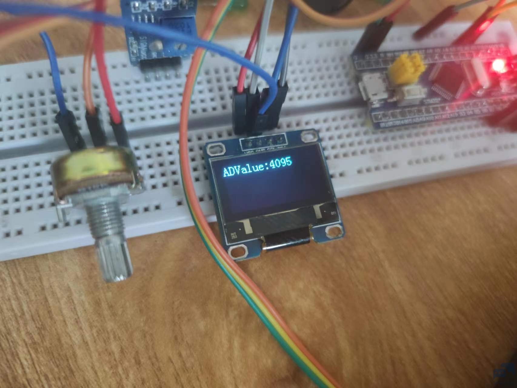

使用STM32F103C8T6 的PA0引脚为ADC采集脚位,一个10K的电位器输出电压。附上程序AD.c #include "stm32f10x.h" // Device header void AD_Init(void){ RCC_APB2PeriphClockCmd(RCC_APB2Periph_ADC1,ENABLE); RCC_APB2PeriphClockCmd(RCC_APB2Periph_GPIOA,ENABLE); RCC_ADCCLKConfig(RCC_PCLK2_Div6); GPIO_InitTypeDef GPIO_InitStructure; GPIO_InitStructure.GPIO_Mode = GPIO_Mode_AIN; GPIO_InitStructure.GPIO_Pin = GPIO_Pin_0; GPIO_InitStructure.GPIO_Speed = GPIO_Speed_50MHz; GPIO_Init(GPIOA, &GPIO_InitStructure); ADC_RegularChannelConfig(ADC1,ADC_Channel_0,1,ADC_SampleTime_55Cycles5); ADC_InitTypeDef ADC_InitStructure; ADC_InitStructure.ADC_ContinuousConvMode = DISABLE; ADC_InitStructure.ADC_DataAlign = ADC_DataAlign_Right; ADC_InitStructure.ADC_ExternalTrigConv = ADC_ExternalTrigConv_None; ADC_InitStructure.ADC_Mode = ADC_Mode_Independent; ADC_InitStructure.ADC_NbrOfChannel = 1; ADC_InitStructure.ADC_ScanConvMode = DISABLE; ADC_Init(ADC1,&ADC_InitStructure); ADC_Cmd(ADC1,ENABLE); ADC_ResetCalibration(ADC1); while(ADC_GetResetCalibrationStatus(ADC1) == SET); ADC_StartCalibration(ADC1); while(ADC_GetCalibrationStatus(ADC1) == SET); } uint16_t AD_GetValue(void){ ADC_SoftwareStartConvCmd(ADC1,ENABLE); while(ADC_GetFlagStatus(ADC1,ADC_FLAG_EOC)== RESET); return ADC_GetConversionValue(ADC1); } 还不知哪里有问题,请各位大佬指教一下。感谢! |

如果输入正常,检查下芯片电源,所有电源脚,尤其VDDA是否结好了。
你也可以对内部的Vrefint通道进行测量,它的电压一般在1.2V左右,看看能否的得到正常测量值。
这样可以检查你的配置及ADC模块是否正常工作。
感谢,本人用万用表打出来发现输入接地线坏了,导致电压一直被拉高,又发现一堆杜邦线内部断线坏了,是该换线了233
