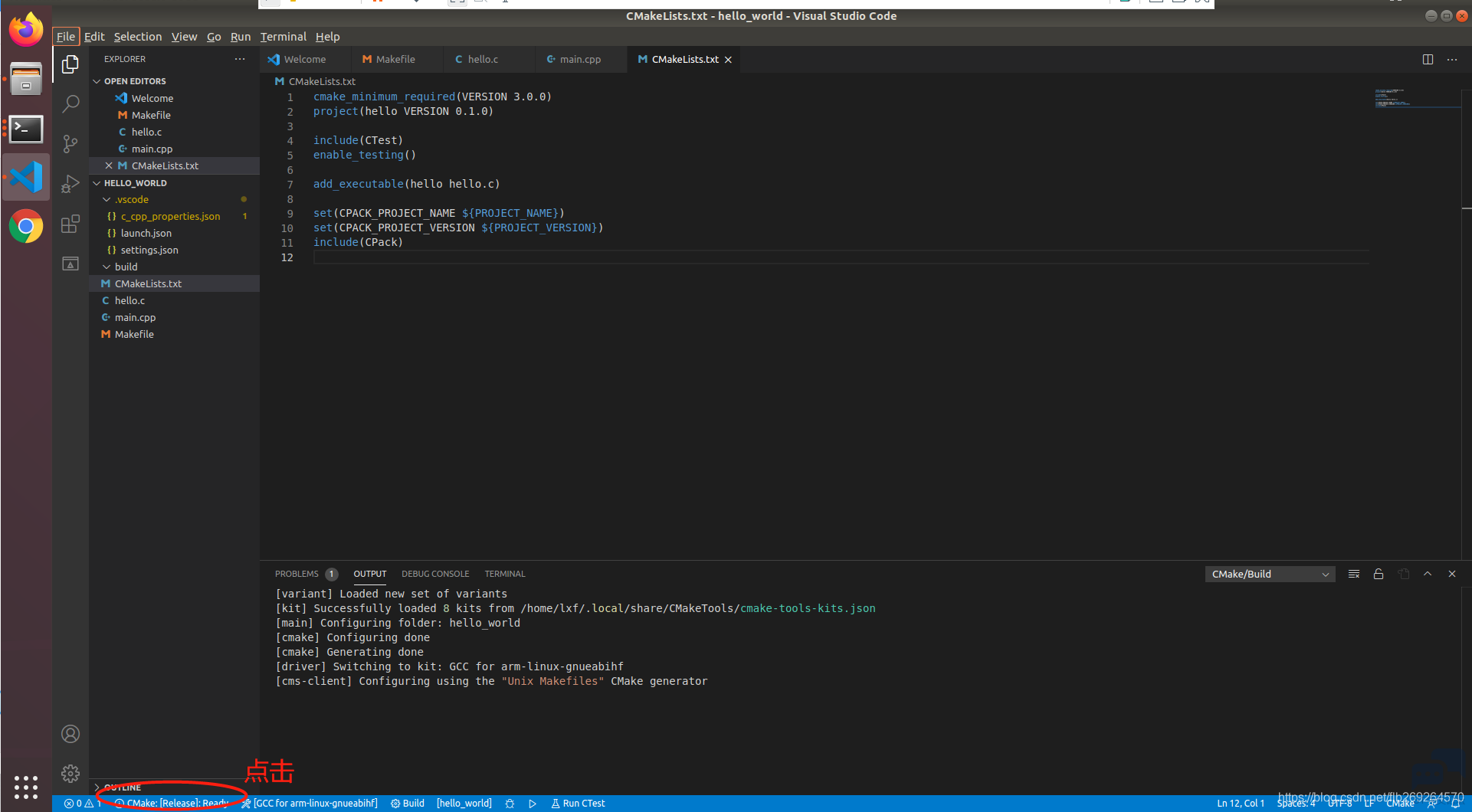

1.用vscode打开代码+ |' a% z5 G3 l8 {

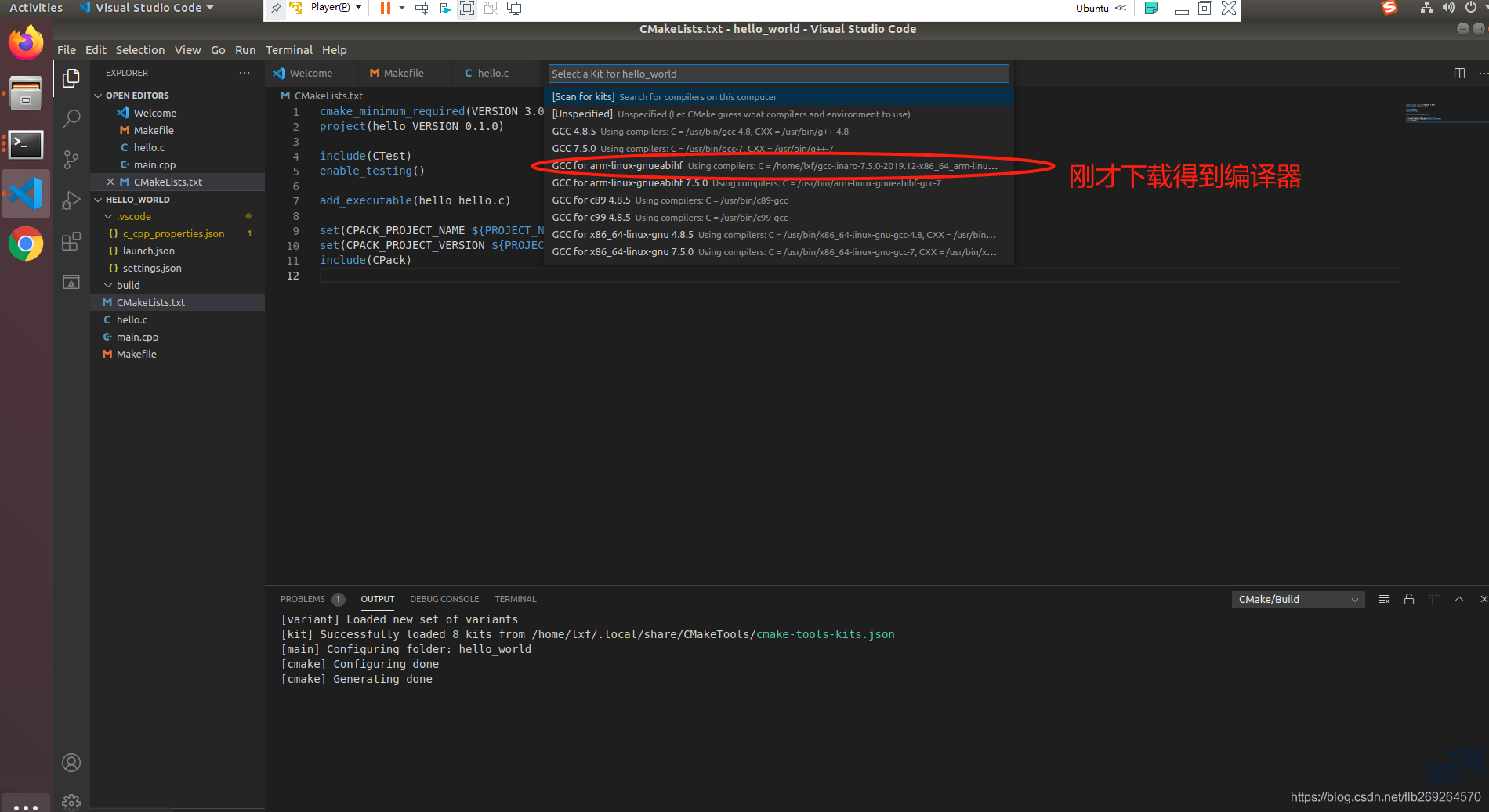

& V2 B$ D2 W6 K  g; A6 B. p% p2.指定编译工具! Y& P! x( \" f& B2 r5 y' t
" r2 i8 C! G: \
- O- @. C+ U( _3 M4 Q6 ]( X! [; b$ r) W( }0 f

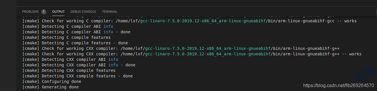

3.cmake" T1 R% }- _. k  K
2 w" V1 [% q) }5 }3 n
) }. z: K7 N* H
8 h/ P6 l' j% Z2 c! Q* v2 C

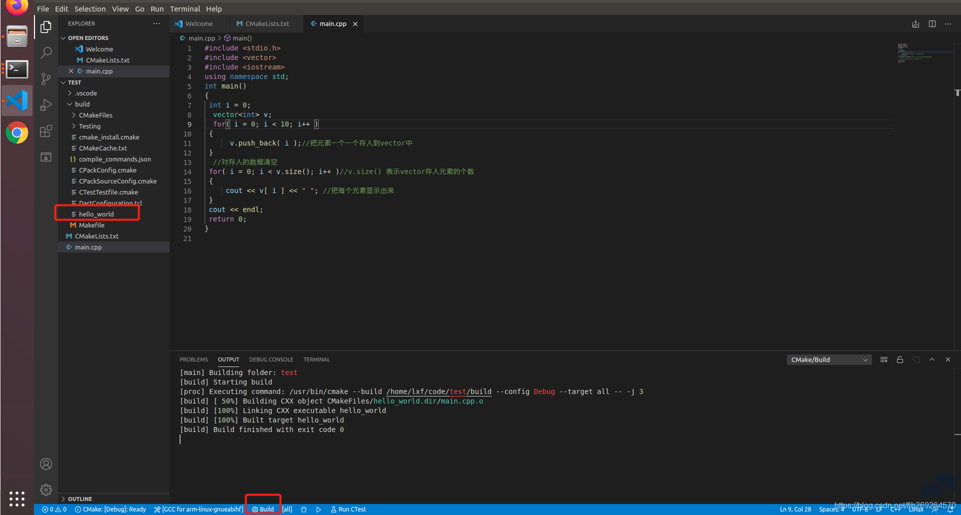

5 `0 a% [8 A' X7 r! S( G1 j. g4.build+ ^6 i3 a0 w" B7 }3 O
9 @9 N& ~9 {4 I% [
20210317151428624.png 1 G8 o1 q+ ~- j; v, z! w0 \8 D
2 H. i- ~; p! T" ?+ W" A
5.生成hello_world
4 H# V, ^; Z3 ?' e2 r3 d" h
; M: T" V; ]- Y( u, k8 o0 f$ q 202103171515232.png " ^5 R+ T' u" l

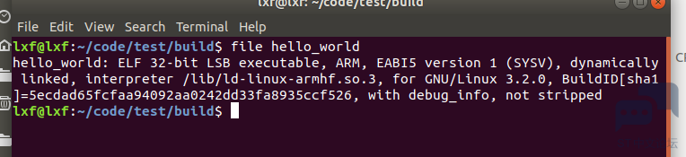

7.到STM32MP57里面跑hello_world程序
; I: Y4 e5 I$ V
4 l+ m( H+ e: O1 w& r 20210317151849895.png ) F4 U: h" I+ k: D- E. g
