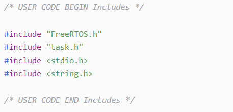

/* USER CODE BEGIN Includes */
( M, A  F7 {% x1 i
! S6 v/ `4 F2 W& @$ q1 U#include "FreeRTOS.h"
2 ]4 a( B9 x8 {. l; q4 Z) D! Z#include "task.h"" {/ y( \: K* k- l, x4 F6 d# d
#include <stdio.h>7 `) j$ ?; ~: N. x  l1 e
#include <string.h>
) I9 O" G) ~# p# ?4 `1 \+ E& {; A  e$ w
/* USER CODE END Includes *// K- A8 [9 N1 M) i

  1. /* USER CODE BEGIN Includes */
    % u& C: ]' |! d7 |: R5 ^
  2. 5 r3 A. H) L! r
  3. #include "FreeRTOS.h"
    , N. J- V: o4 {' P# S
  4. #include "task.h"
    $ E* {4 A+ K6 v
  5. " O# c0 I% V$ Q  [
  6. #include <stdio.h>
    6 m7 I7 t2 H, y, y5 l
  7. #include <string.h>
    ' _3 ?* Z0 H7 Q$ N3 z. ~3 P
  8. 5 L/ G5 J" {: ?
  9. /* USER CODE END Includes */
