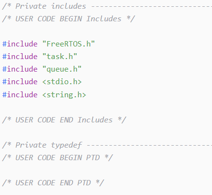

1.创建好带有printf-stdarg.c的FreeRTOS的工程6 W! z: X, D" i% @$ h
0 q& J* p- \+ Y7 c2.修改main.c文件9 v5 \& n! ]+ Z
$ w3 ]! G2 }1 ~8 J
  1. /* Private includes ----------------------------------------------------------*/6 i, A/ s, @9 n% O1 x  w7 R3 n
  2. /* USER CODE BEGIN Includes */
    3 ^8 f( s( g# m8 e& C$ q
  3. , B' L. @3 a5 a, z' g6 j+ x
  4. #include "FreeRTOS.h"& Q6 j' {1 s2 E; G" g
  5. #include "task.h"# f+ d8 ~( W2 N# ^2 \! ]' C( e
  6. #include "queue.h"
    9 k: T0 ]* T3 \! f1 c8 o
  7. #include <stdio.h>4 L/ I1 u6 \# p0 \
  8. #include <string.h>/ k1 ?4 R) ]# q2 a( h
  9. - e3 R; h: N  ^4 w4 n4 {
  10. /* USER CODE END Includes */- I! u: l3 }7 g2 b* h" ^2 R
  11. 4 m* R' O# L! ]. r- h+ M
  12. /* Private typedef -----------------------------------------------------------*/
