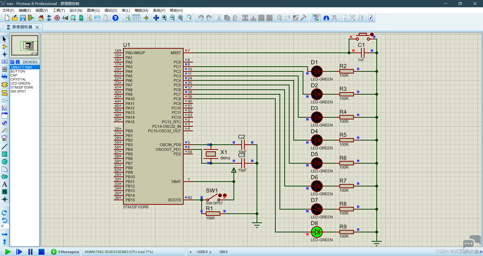

目标:使用STM32F103R6实现LED接地跑马灯- `# y# ]$ W( `" M5 f
) P% a- J, ], q. I# P# C( f接地跑马灯和上一篇接电源跑马灯只有很小的不同. r/ v* `7 r# g& Q
1 I; C* Z) o" F; P. l所以,先打开Proteus画个图
2 K" A+ z7 }9 T2 v2 v, S6 \: {/ h2 S; |/ p6 ^6 @  [+ Z: ?" J" n

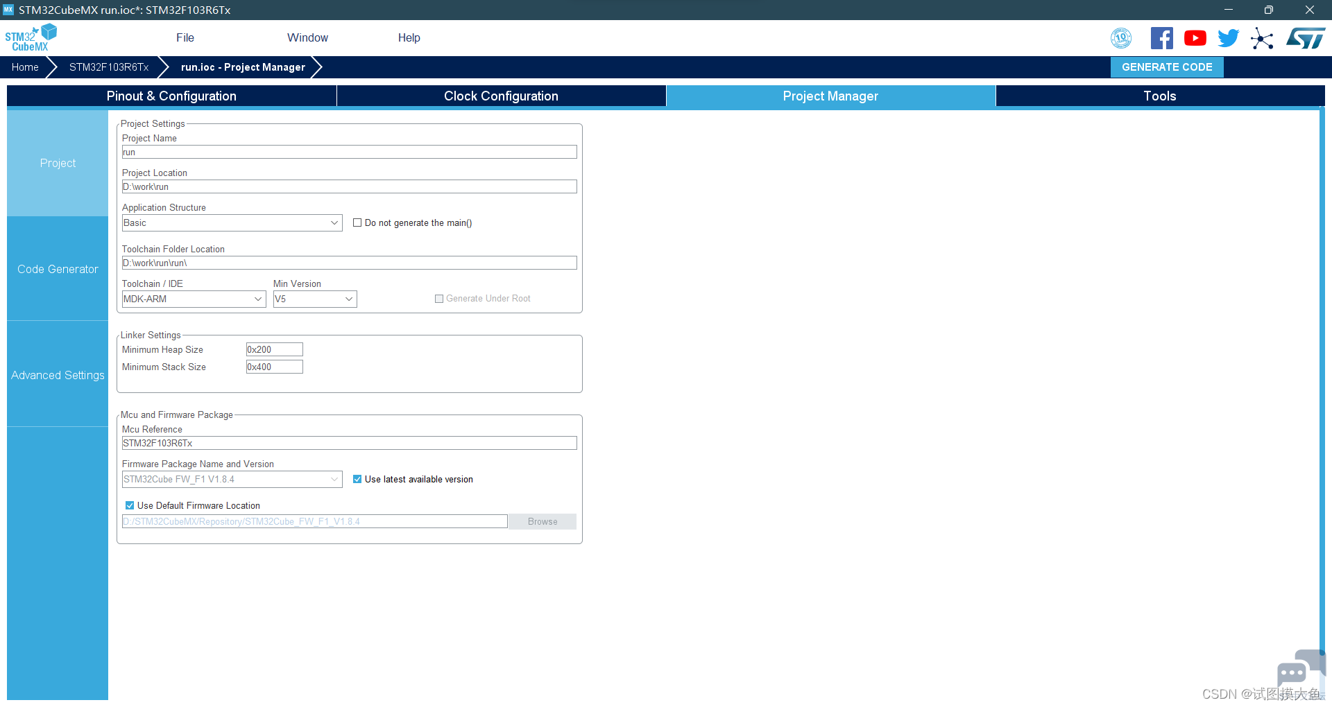

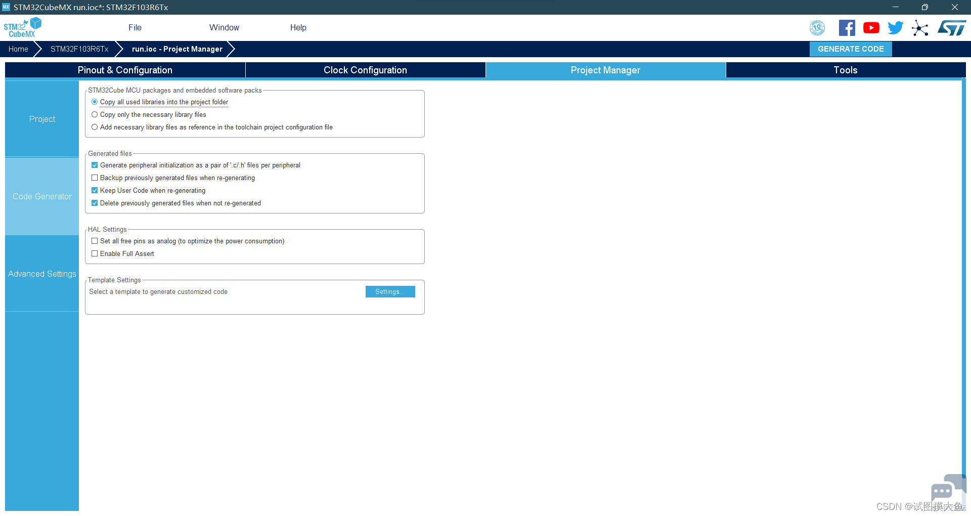

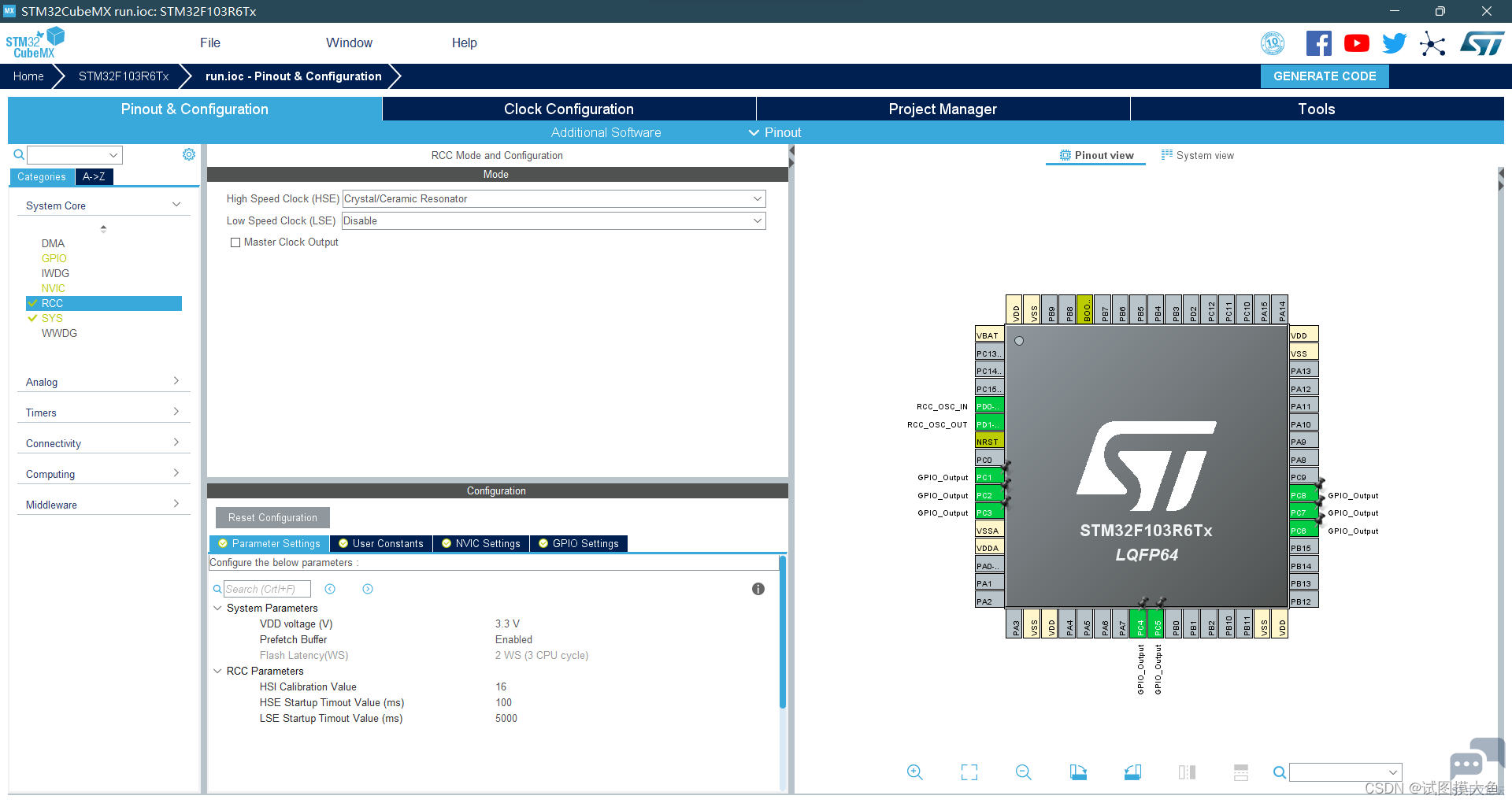

然后打开STM32CubeMX,和之前一样的设置,只放图不再具体描述
0 y/ ?$ s, `  ~$ E, z0 S1 Y% C1 l
3 }: Z. b9 w8 y% `1 W9 o2 U3 Q
81c8433a8efd4cb28ad033d9666ca1b8.png 3 C1 i) Z7 p% j: q

3e773d4361734303b6a629d9ba1bb8fa.png ' T4 E4 k- p8 @- q* B

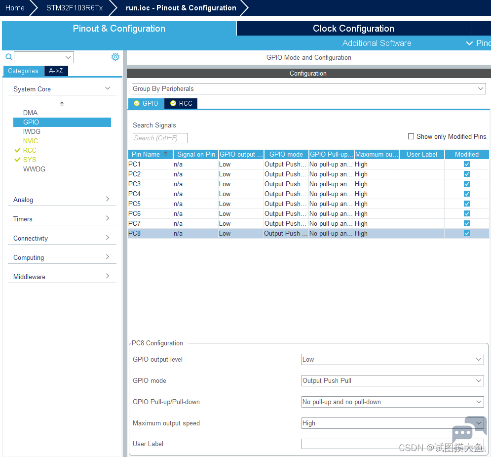

但是引脚的初始电平得改成low" F- L0 N( r8 q5 w
4 |* D: Z: V7 I, T+ _+ G
60f27620f6e6495581d8b3b896e8b74b.png 4 |5 T3 w# Z; |% Z6 N1 s

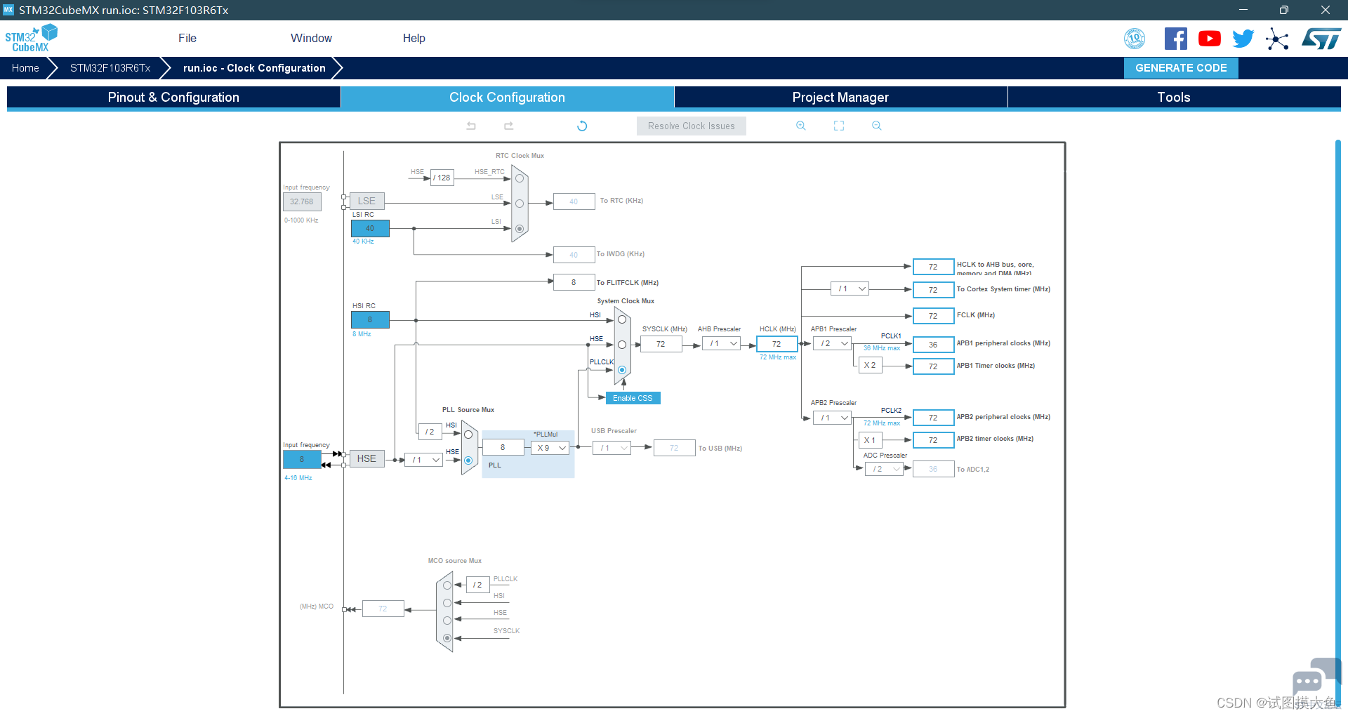

  S1 H8 B: o7 [$ j2 I" [7 y  Y. Y还是一样的配置
+ o' t9 N4 r# w* K% M3 o
$ c6 T% v: R* I" W& t/ g9 y

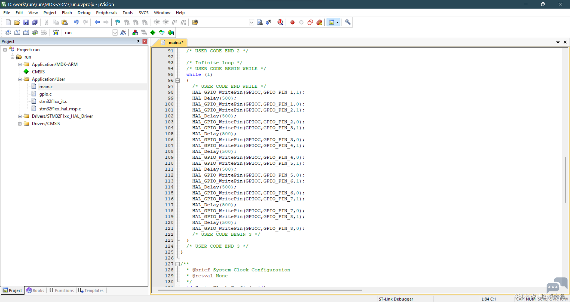

然后导出在Keil里编辑,还是打开main.c然后找到可编辑位置,写的和上一个略微不同,就0和1交换一下. g/ \& @/ w! k, _: \5 t0 E+ }
* M- W5 }  D" i* @5 v5 S
9424824ba5c04bcebf8c0cd32fe4993b.png 4 h4 T  |) v$ |: E* H

  1.   while (1)9 Z8 v! B; ~' u! h: g
  2.   {
    % q5 w) |' {9 k5 J# `$ w
  3.     /* USER CODE END WHILE */
    4 Q1 |; B. w( d8 \: N
  4.                 HAL_GPIO_WritePin(GPIOC,GPIO_PIN_1,1);: ]+ t9 n3 S4 U8 L
  5.                 HAL_Delay(500);
      T/ H# A$ i8 o
  6.                 HAL_GPIO_WritePin(GPIOC,GPIO_PIN_1,0);
    / K& U9 V! e& k/ `$ o
  7.                 HAL_GPIO_WritePin(GPIOC,GPIO_PIN_2,1);
    # I- A- i, J% b# L
  8.                 HAL_Delay(500);2 J5 X2 L/ t/ y" I9 c  l; E# Y
  9.                 HAL_GPIO_WritePin(GPIOC,GPIO_PIN_2,0);
    ) u( r0 B# b& F( S
  10.                 HAL_GPIO_WritePin(GPIOC,GPIO_PIN_3,1);
    6 \8 ]! S, ^4 G2 ]4 H/ x. Y: J7 j' \0 D* a
  11.                 HAL_Delay(500);
      ~; V+ Y0 e2 t0 `, ]8 ]: D* |. j
  12.                 HAL_GPIO_WritePin(GPIOC,GPIO_PIN_3,0);
    5 L" Q0 o, j7 S; c8 m
  13.                 HAL_GPIO_WritePin(GPIOC,GPIO_PIN_4,1);
    4 `* D. f6 \) ^. Y% G8 w
  14.                 HAL_Delay(500);
    / ]$ H$ c$ g( Q- u
  15.                 HAL_GPIO_WritePin(GPIOC,GPIO_PIN_4,0);
    7 J8 d" E- E! C3 S
  16.                 HAL_GPIO_WritePin(GPIOC,GPIO_PIN_5,1);
    / s/ H5 f7 ]! [6 v
  17.                 HAL_Delay(500);  @, |3 n, m( ~$ h
  18.                 HAL_GPIO_WritePin(GPIOC,GPIO_PIN_5,0);
    # Q9 k# Y$ }0 v2 r/ j* |
  19.                 HAL_GPIO_WritePin(GPIOC,GPIO_PIN_6,1);
    7 p) D# R$ T; e
  20.                 HAL_Delay(500);  k9 ^" U8 q# H1 N: p
  21.                 HAL_GPIO_WritePin(GPIOC,GPIO_PIN_6,0);8 t% }6 c  d3 B% _+ i
  22.                 HAL_GPIO_WritePin(GPIOC,GPIO_PIN_7,1);" M8 d! N0 V2 v" z
  23.                 HAL_Delay(500);
    - v( h9 Z$ f1 ]$ c# Y' c; q+ ]3 J; U
  24.                 HAL_GPIO_WritePin(GPIOC,GPIO_PIN_7,0);) {# ]3 y9 @0 z( H" ^' z" _. Y; q
  25.                 HAL_GPIO_WritePin(GPIOC,GPIO_PIN_8,1);" k/ |& r- g  p" \3 }
  26.                 HAL_Delay(500);
    / v& s4 n7 E$ {
  27.                 HAL_GPIO_WritePin(GPIOC,GPIO_PIN_8,0);: I  t* c" k5 `* Y3 f
  28.     /* USER CODE BEGIN 3 */6 R0 H* w2 O/ h0 W
  29.   }

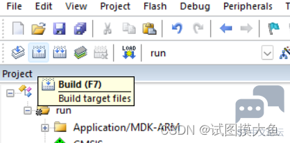

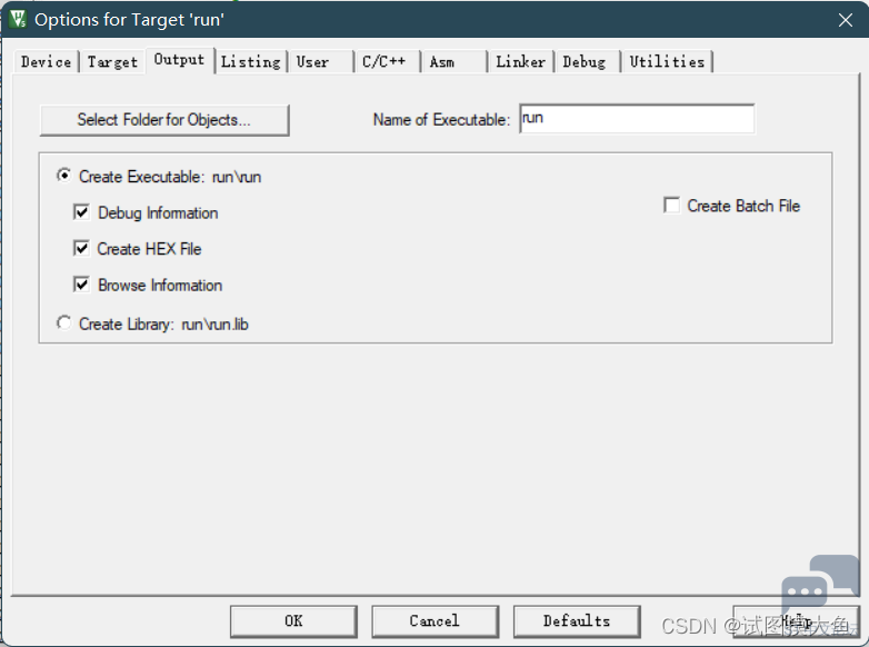

确认能输出HEX. C8 F: B6 V: x+ j; O" |+ @! L
6 v+ S& {$ o, |, a3 j/ D5 Q
7 O8 E6 ^6 A, g/ W
5 u% N4 \' V; B0 V: s# j
输出
7 ?" T, a: k, B; Y/ B
2 g5 S& a: u- l, D
268710528f654f748eca153b083d4df2.png % q/ _4 z# K3 @! |$ b  x

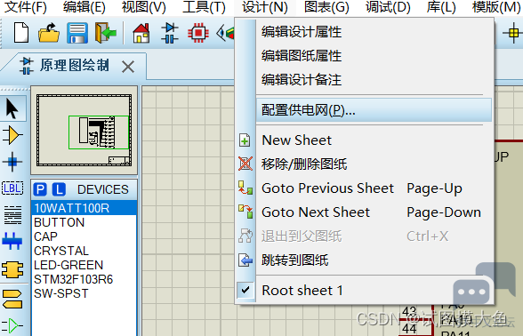

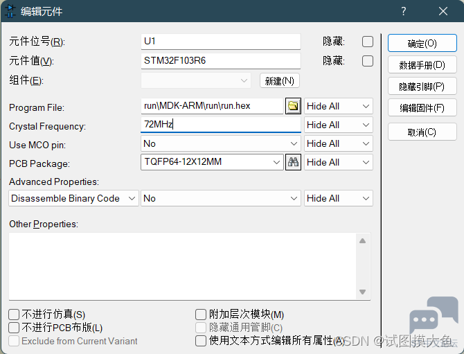

; C& e, Q5 b2 Q6 w. Q! D) h  c然后再打开Proteus,添加一下HEX文件
9 @+ w9 O6 j6 `( u! A' W4 ~% q& S
b00b693f19cc4ebb8776fd257fd45c1e.png / y. C  \9 s9 D; H) _! Y0 r% @/ u1 o
0 u4 p* ^7 n, H/ V
不要忘记配置供电网0 {4 ^% W; }1 Q" P
