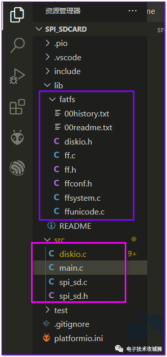

2 编写程序2.1 加入FATFS库
  • 工程目录lib下新建fatfs文件夹;
  • 然后将fatfs源码的source目录下所有文件放置到工程的lib\fatfs目录下;
  • 将diskio.c文件移动到src目录下,这个文件是需要我们实现的底层接口;
    0 s7 a) h! S- p
2.2 实现SPI接口的SD读写
在src目录下新建spi_sd.h 和 spi_sd.c 文件,现在目录结构如下:
6 t  H$ |, a  @2 x; q+ _- w
' K$ k* O* d$ b7 Y+ e; D' p0 J# {5 N7 o4 G: _
  • spi_sd.h 头文件

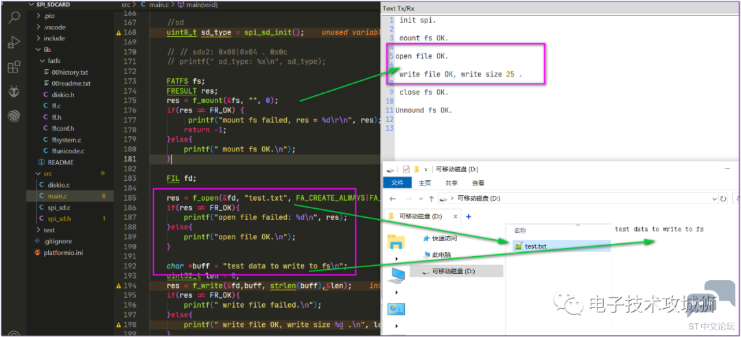

4 C! X6 u: P0 g( E; u  H: Y2.4 SD卡读写测试 4 L- |; L; v0 T
  1. 1printf(" init spi.\n");1 x, d! S# i) m7 a+ I+ ~- Z4 t, l
  2. 2
    , O9 |2 M2 k( W$ ?% @6 O
  3. 3//spi7 K' O$ y6 z& o9 G  m4 A) K
  4. 4spi1_init();
    ! z* s& u; u. ]  W) X7 y, U
  5. 57 S2 _" Z1 Q4 c
  6. 6//sd
    0 I2 T1 ^+ j2 l! n! U. |0 a
  7. 7uint8_t sd_type = spi_sd_init();5 S$ j1 F7 W0 k( z* _4 U# p
  8. 8
    ' ^& M3 Z+ r; W3 g( E9 w4 H1 h
  9. 9//sdv2: 0x08|0x04 . 0x0c" q& C( Z" t) u$ _& g
  10. 10// printf(" sd_type: %x\n", sd_type);
    ( q8 Z9 ]$ W; V0 Z
  11. 118 u( g1 p, P- p( w: o$ y  L5 v5 ]
  12. 12FATFS fs;
    1 d' w" o$ \. y# X7 i+ T
  13. 13FRESULT res;
    " S' I( n$ x( C
  14. 14res = f_mount(&fs, "", 0);
    $ g6 j2 w1 ]* c3 Z9 ~" E9 R' b. q
  15. 15if(res != FR_OK) {7 |0 p* J; f  O2 b
  16. 16    printf("mount fs failed, res = %d\r\n", res);0 F2 v! v  _% z$ K5 v2 E& h& \
  17. 17    return -1;3 ~# x, _6 U- Q
  18. 18}else{
    ! }5 h, U9 \9 u! I4 O1 `# V# S
  19. 19    printf(" mount fs OK.\n");
    # c' j7 v, p2 ?' F3 ~4 |# w
  20. 20}/ c7 T2 P. I$ |7 n) e
  21. 21
    7 t, l6 K% F( D: j; `3 ]( `
  22. 22FIL fd;
    5 K' C# n$ _; j& j3 f. F9 ~7 ]  E* c
  23. 23
    $ U. m( k8 g# o. X4 m& ?# f* w
  24. 24res = f_open(&fd, "test.txt", FA_CREATE_ALWAYS|FA_WRITE);/ R  {1 H  m" V1 P4 k% _
  25. 25if(res != FR_OK){: f" x# j5 @# I( l$ K! y  z% [
  26. 26    printf("open file failed: %d\n", res);
    ; R) P0 z8 z4 v4 L' ~
  27. 27}else{, i9 f9 n4 ?3 ?5 e- f8 `0 R: u
  28. 28    printf("open file OK.\n");
    9 W6 B7 c$ T. ^& T- ~! g9 f
  29. 29}
    ' m5 N- T5 z, e) o8 B$ Y
  30. 30
    # i" `+ B% b& u+ D% k
  31. 31char *buff = "test data to write to fs\n";
    1 y8 F* y% s+ q4 }/ `! a. I, m; k5 o+ T! E5 }
  32. 32uint32_t len = 0;
    " n- u$ S. h: j, R7 \5 ]
  33. 33res = f_write(&fd,buff, strlen(buff),&len);/ g+ B# R5 ~4 p7 J
  34. 34if(res != FR_OK){, M- c* u) m" Y
  35. 35    printf(" write file failed.\n");
    . F! c' ]5 q; U) B4 W0 n
  36. 36}else{
    * h( [* s: z1 a: }' a5 @; q% e
  37. 37    printf(" write file OK, write size %d .\n", len);
    " m% _5 m) |, M
  38. 38}5 h# [4 g: ^1 c
  39. 39
    ' c! s. H7 G' _1 ^
  40. 40res = f_close(&fd);
    1 G7 @* _5 {+ i7 H/ P2 G& a( W
  41. 41if(res != FR_OK){
    1 D2 d+ I8 l# J! f7 Z
  42. 42    printf(" close fs failed.\n");( p& J5 p; _% b- w0 [5 @2 b
  43. 43}else{# S3 v1 ]% r/ I0 y* w4 P
  44. 44    printf(" close fs OK.\n");5 a/ X3 p! J9 o# {
  45. 45}! U, U3 v; L' g2 M1 R  p! j" v
  46. 46
    ; u3 C3 x4 }: `" X$ x
  47. 47res = f_unmount("");
    6 y4 o: ]; `0 a  V; W1 E- ?
  48. 48if(res != FR_OK) {  i1 x* t0 {, m  I
  49. 49    printf("Unmount fs failed, res = %d\r\n", res);4 g( T* b9 [0 M' T$ T9 j2 J4 R! c
  50. 50    return -1;0 S: _- t- m  n( _
  51. 51}else{
    7 _1 M; j- F$ H( Q5 c: x& v
  52. 52    printf("Unmound fs OK.\n");
    4 r% q+ V' |# v& y' g3 Z- u
  53. 53}
8 U# P; ?, @! a: j9 }6 s( {8 D' }. a4 d/ R% F
main中测试SD卡挂载、读写;

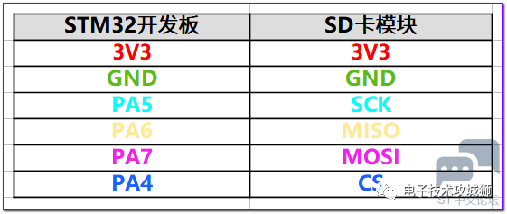

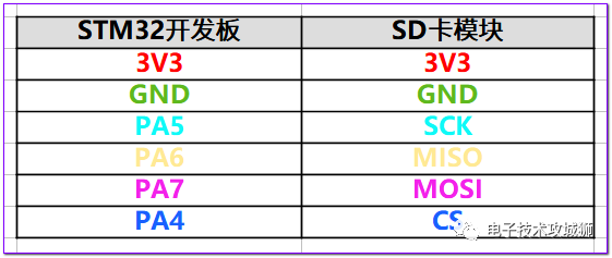

3 硬件连接
硬件引脚按如下方式连接到SPI1

; A7 h* h& {6 F# i2 @, ^: u7 ~$ J4 烧写测试
将程序烧写到开发板后,打开串口,可以看到测试成功,卡中写入文件在电脑显示正确:
