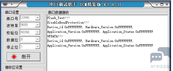

写入数据不正常
[md]![VVV.png](data/attachment/forum/202303/07/155243hxl8qsuym5rmygy1.png?imageMogr2/auto-orient/strip%7CimageView2/2/w/300 "VVV.png")
写入数据不正常
立码赚 回答时间:2023-3-7 16:02:36
串口打印结果: Flash_Test!!! DisableReadProtection!!! Device_id:0xFFFFFFFF, Hardware_Version:0xFFFFFFFF, Application_Version:0xFFFFFFFF, Application_Status:0xFFFFFFFF UPDATA!!!
