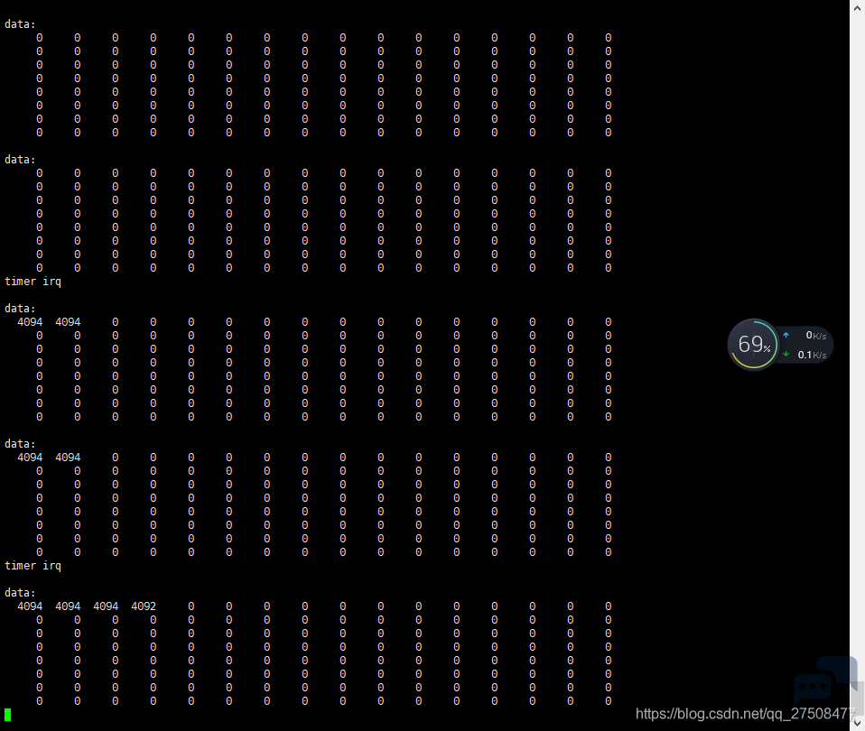

实现基于STM32F7中周期采集
STMCU小助手 发布时间:2023-3-13 22:32
实现了定时器加DMA的等周期采集。; p; \4 G3 A& f" z. N
adc.c:& Q2 ~! p* ~9 B$ r8 l

  12. static void MX_TIM2_Init(void)3 A- r5 z  Y9 m2 m5 h$ Z6 I' @
  13. {
      D0 Z, E* b7 k3 G
  14.     __HAL_RCC_TIM2_CLK_ENABLE();
    9 ]. D! Z/ D6 ]- f8 ~+ g0 F, \
  15.         1 T/ d7 i9 D6 J1 }/ k0 p. J4 T  l
  16.     HAL_NVIC_SetPriority(TIM2_IRQn, 1, 3);
    0 N( d8 m8 s* O5 t6 h7 J
  17.     HAL_NVIC_EnableIRQ(TIM2_IRQn);
    3 S. X4 E  F0 E% L& D
  18. " ^5 K2 c* t3 G* C9 ~- h) o
  19.     TIM2_Handler.Instance = TIM2;% c" o- A  l5 Z3 a2 S$ }9 x0 ^
  20.     TIM2_Handler.Init.Prescaler = 10800;
    0 w5 L/ X* N) w5 L
  21.     TIM2_Handler.Init.CounterMode = TIM_COUNTERMODE_UP;
    / n% r, m, h6 g* z
  22.     TIM2_Handler.Init.Period = 20000;/ U; q; Z+ _% z; q. i
  23.     TIM2_Handler.Init.ClockDivision = TIM_CLOCKDIVISION_DIV1;! A/ p! V5 z, c
  24. 1 @1 {: m, }& V0 A5 g7 s3 ~
  25.     HAL_TIM_PWM_Init(&TIM2_Handler);
    $ B5 R" k) V* a6 v* o, B9 |
  26. ) p: j+ r/ h) I3 R; e- G2 s
  27.   y  E: A$ ^7 @/ d: L
  28.     TIM2_CH2Handler.OCMode = TIM_OCMODE_PWM1;
    2 t2 g0 D7 y& G  V9 E4 l5 J6 ^
  29.     TIM2_CH2Handler.Pulse = 10000;
    & U( @$ c# v: Y; S% u
  30.     TIM2_CH2Handler.OCPolarity = TIM_OCPOLARITY_HIGH;# I/ s6 \1 i% E  v* u- [9 O
  31.     TIM2_CH2Handler.OCFastMode = TIM_OCFAST_DISABLE;$ e* P6 @' W9 p
  32.     HAL_TIM_PWM_ConfigChannel(&TIM2_Handler, &TIM2_CH2Handler, TIM_CHANNEL_2) ;
    0 \* S( B4 h+ C3 ^  u9 F
  33. / `+ K, V. J/ N
  34. 7 P* C' A* L2 ^3 I8 D2 J% `
  35.     __HAL_TIM_ENABLE_IT(&TIM2_Handler, TIM_IT_UPDATE);
    + y6 O; F4 t4 O# g4 ]' x3 ^; }% ?
  36.     TIM_CCxChannelCmd(TIM2_Handler.Instance, TIM_CHANNEL_2, TIM_CCx_ENABLE);
    9 x9 K/ J' y- z' i( a* L2 C
  37.     __HAL_TIM_ENABLE(&TIM2_Handler);
    3 x0 A5 n0 w  r+ F2 R; j7 z- {
  38. }

  72. //初始化ADC
    . v; K: D; ]; u  ~' N4 a7 ^
  73. //ch: ADC_channels8 D6 w! \, S% r- g8 b  y2 p- y6 R& I
  74. //通道值 0~16取值范围为:ADC_CHANNEL_0~ADC_CHANNEL_16
    , f; p( w( L- R& B! o
  75. void MY_ADC_Init(void)% }) M) v" H: H/ H5 V  l# X
  76. {+ h6 |! Z5 b( J3 }
  77.     __HAL_RCC_DMA2_CLK_ENABLE();
    / o. P6 y* Z# ]. N! e9 _, P
  78.     HAL_NVIC_SetPriority(DMA2_Stream0_IRQn, 0, 0);* `2 ]; t- Z3 H+ h, l
  79.     HAL_NVIC_EnableIRQ(DMA2_Stream0_IRQn);
    9 l( Y' B& w' Y7 k
  80. $ l' ?$ Y9 k5 S) c- q/ L. `
  81.     ADC1DMA_Handler.Instance = DMA2_Stream0;3 ?/ Z- P9 P* s% W; N
  82.     ADC1DMA_Handler.Init.Channel = DMA_CHANNEL_0;
    : t! n; @) ~1 s
  83.     ADC1DMA_Handler.Init.Direction = DMA_PERIPH_TO_MEMORY;: c2 M4 e; d" C% F  N6 K& G; ~
  84.     ADC1DMA_Handler.Init.PeriphInc = DMA_PINC_DISABLE;               //外设非增量模式
    8 F. O2 N$ x6 h# M4 T8 d# a2 B
  85.     ADC1DMA_Handler.Init.MemInc = DMA_MINC_ENABLE;                   //存储器增量模式! k2 m9 D* W3 ]3 f% F
  86.     ADC1DMA_Handler.Init.PeriphDataAlignment = DMA_PDATAALIGN_HALFWORD;  //外设数据长度:16位
    2 o" c6 ^/ L2 T( w* l# G
  87.     ADC1DMA_Handler.Init.MemDataAlignment = DMA_MDATAALIGN_HALFWORD;     //存储器数据长度:16位' ?% b4 g: W' y3 c9 E) N% t& s
  88.     ADC1DMA_Handler.Init.Mode = DMA_CIRCULAR;                          //传输一次就结束
    2 P: Y* Z$ P. }; Y6 q
  89.     ADC1DMA_Handler.Init.Priority = DMA_PRIORITY_LOW;             //中等优先级3 I2 P; O/ P" O7 q# x9 {- M: v5 h' N, t
  90.     ADC1DMA_Handler.Init.FIFOMode = DMA_FIFOMODE_DISABLE;            /* 禁止FIFO*/
    % l; j' L0 p) g6 ?; t0 d* F
  91. 0 O; y2 p( ?7 |* ]$ o
  92.     HAL_DMA_Init(&ADC1DMA_Handler);
    . E- @) ?* \; ?$ q/ P5 x5 [7 N
  93. * O. v' K4 l  W. a2 s% `0 r) w
  94.     __HAL_LINKDMA(&ADC1_Handler, DMA_Handle, ADC1DMA_Handler);                //将DMA与ADC联系起来
    / D' h$ }) _' {/ g3 y
  95. 4 [7 s$ W: H& p, f6 m: l
  96. / H: q- Y8 u% h& @
  97.     ADC1_Handler.Instance = ADC1;
    ; n- Y) H  f; ]* ]0 n! Y! ^
  98.     ADC1_Handler.Init.ClockPrescaler = ADC_CLOCK_SYNC_PCLK_DIV4; //4分频,ADCCLK=PCLK2/4=108/4=27MHZ
    . h) l7 M# ^) o9 q
  99.     ADC1_Handler.Init.Resolution = ADC_RESOLUTION_12B;           //12位模式
      O3 k* j8 b6 K. C) x' k! n0 a8 m
  100.     ADC1_Handler.Init.ScanConvMode = ENABLE;                    //非扫描模式! x, }# `3 |# \4 F1 L* j
  101.     ADC1_Handler.Init.ContinuousConvMode = DISABLE;              //关闭连续转换
      ~, F/ A- U0 {% z2 @: ]
  102.     ADC1_Handler.Init.DiscontinuousConvMode = DISABLE;           //禁止不连续采样模式$ T% l& w9 t) `+ Q$ w4 D3 O
  103.     ADC1_Handler.Init.ExternalTrigConvEdge = ADC_EXTERNALTRIGCONVEDGE_RISING; //使用软件触发
    , M6 Y1 A6 i3 _4 S) @- y; n& w) H
  104.     ADC1_Handler.Init.ExternalTrigConv = ADC_EXTERNALTRIGCONV_T2_CC2;     //软件触发* l/ Y' X8 [, C0 R
  105.     ADC1_Handler.Init.DataAlign = ADC_DATAALIGN_RIGHT;           //右对齐
    2 r$ k! b2 M! A) ~/ e. L
  106.     ADC1_Handler.Init.NbrOfConversion = 2;                       //1个转换在规则序列中 也就是只转换规则序列1! m  d1 D9 N5 f% k/ _
  107.     ADC1_Handler.Init.DMAContinuousRequests = ENABLE;           //关闭DMA请求; t( X9 U( ~+ ~: N
  108.     ADC1_Handler.Init.EOCSelection = ADC_EOC_SINGLE_CONV;
    1 Z) p; ~# d6 o$ E
  109.     HAL_ADC_Init(&ADC1_Handler);
    5 i, k: H! A2 [+ Q$ X5 c
  110. 2 o3 x) O- G2 s3 O
  111.     ADC1_ChanConf.Channel = ADC_CHANNEL_5;                                 //通道# y) a; j8 k8 I
  112.     ADC1_ChanConf.Rank = 1;                                     //序列1
    9 o/ g+ G' W$ V* O' I
  113.     ADC1_ChanConf.SamplingTime = ADC_SAMPLETIME_480CYCLES;      //采样时间7 o8 U9 K: o; E! I5 B7 Y) c" q
  114.     ADC1_ChanConf.Offset = 0;5 r  r4 ^) P8 c) x/ H
  115.     HAL_ADC_ConfigChannel(&ADC1_Handler, &ADC1_ChanConf);       //通道配置
    ( n, q4 W$ V; g0 e# J' T( [) Y- g
  116. ) z- h% K5 Z& R" J7 N2 V0 @/ S
  117.     ADC1_ChanConf.Channel = ADC_CHANNEL_6;                                 //通道7 x# V' w- D( M+ j& c/ w3 F% |8 h
  118.     ADC1_ChanConf.Rank = 2;                                     //序列2
    * `/ P0 Y5 _6 S7 V9 d5 m9 K
  119.     ADC1_ChanConf.SamplingTime = ADC_SAMPLETIME_480CYCLES;      //采样时间. o2 u; U9 v6 |. x# r7 _  z
  120.     ADC1_ChanConf.Offset = 0;
    ) K5 e9 U; [  |5 u: g
  121.     HAL_ADC_ConfigChannel(&ADC1_Handler, &ADC1_ChanConf);       //通道配置
    4 C5 G- _/ R1 q9 e7 o; m
  122. . }* a+ L5 c# H. U; _
  123.
      c: p! p  b. S0 U- B2 m  J) R: j
  124.     MX_TIM2_Init();$ y$ C, |5 v$ c$ j2 J* I
  125.                 HAL_ADC_Start_DMA(&ADC1_Handler, (uint32_t *)buffer, 128);
    9 @9 j6 |8 X5 y$ Z% J- ?
  126. }

  9. void show()5 L* g5 q  T0 e+ c4 N
  10. {
    ) V- t! b) O5 {7 Q0 ?
  11.     int i;  f* c3 A9 m$ A5 a- H+ t, \
  12.     printf("\r\ndata:");
    2 Z, V2 F* p# N
  13.     for (i = 0; i < 128; i++)) a" T; |% D5 H0 b
  14.     {
    # J) T4 p. J1 |, Z$ e  m, m
  15.         if (i % 16 == 0) printf("\r\n");' X7 G4 }) C/ r; N: s3 t5 u! Y
  16.         printf("%6d", buffer[i]);
    0 Q3 B1 G) i& R% s; Z( a9 E
  17.                         //buffer[i]=0;
    & W1 E. }& w2 ]: _) J" W
  18. 0 [& q- V; ]' ^
  19.     }
    % w" S7 e" M: T  L3 `( l2 `0 |
  20.     printf("\r\n");
    0 L' i! W, U4 y6 [; p" l7 @
  21. }
    7 y, o$ X- F$ c# W9 Q
  22. 9 x1 F; i' N: l6 M; \  x
  23. # |) F& R- {! ]6 R& ]1 E3 C
  24. int main(void)" W$ h4 v$ I# ^; F% v
  25. {
    ; L, t+ w" c5 y
  26.     //Cache_Enable();                 //打开L1-Cache; {4 k$ A  R" p( m5 B3 b
  27.     HAL_Init();                     //初始化HAL库: m4 Z# Y) ]) `! o* {
  28.     Stm32_Clock_Init(432, 8, 2, 9); //设置时钟,216Mhz4 h" I( J+ }/ ~9 q3 T
  29.     delay_init(216);                //延时初始化
    : ^+ B% x( K8 ~- \) U* |: n
  30.     uart_init(115200);              //串口初始化, n: N" ^1 h8 T- k2 t
  31. 2 k# M4 V$ F% G% b8 B" q
  32.     printf("\r\n\r\n\r\n---------------------------------------\r\nstart\r\n");8 ]  U! x9 H) r6 J7 c  d8 M
  33.     MY_ADC_Init();                  //初始化ADC1通道5
    6 H& f. V3 P( G3 C7 P+ f' E/ X7 |
  34.
      K$ m7 i- M  K/ c3 V( q; h8 M
  35.     while (1)9 t& G. Y4 g- a1 ~
  36.     {8 t4 U- C  S$ R
  37.         show();6 g$ m& U7 B' S0 ^% c9 Q
  38.                                 //printf("cnt:%d\r\n",TIM2->CNT);
    $ ?* q. c+ ~/ D; C& f* G
  39.         delay_ms(1000);
    ' [/ Y1 ?, x! O# @
  40.     }
    0 ^" E( d! L6 ?
  41. }
    3 S* n7 ?8 p6 |  Y
  42. + [# e9 D" h4 z( R4 d! Y/ C0 W
/ f6 a5 |* R" \3 e  p" M9 }0 V" R
因为定时器是2s采集一次,主函数是1s打印一次,所以显示结果如下:
) Y$ x4 v3 x# r" H% a' }2 k8 C) m; @( J' W, A6 G
20200421195242686.png ; {; c0 u, y  V1 I( P
