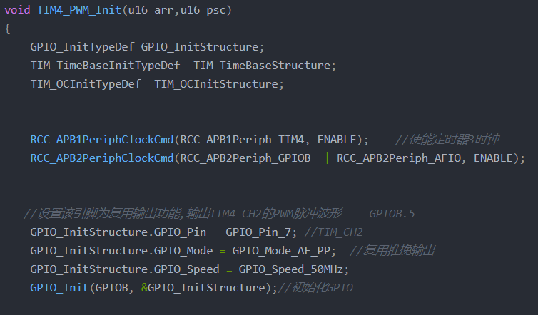

  1. //TIM4 PWM部分初始化
    6 J, n1 q) F% i0 T
  2. //PWM输出初始化7 V: a9 L( y. \2 u. y3 R3 o
  3. //arr:自动重装值/ a3 k! n$ T# R4 e# I: s
  4. //psc:时钟预分频数0 L+ D3 W/ H1 ^* T) p# z- G9 N
  5. void TIM4_PWM_Init(u16 arr,u16 psc)- g9 l2 |  N9 _3 x* }4 _' k% G3 Z
  6. {
    1 c; g6 W/ M' q$ {9 e3 i; I8 E
  7.         GPIO_InitTypeDef GPIO_InitStructure;$ G% Q- z7 H. l9 U
  8.         TIM_TimeBaseInitTypeDef  TIM_TimeBaseStructure;9 ]8 F$ a- K* O0 k) _' \; a2 h
  9.         TIM_OCInitTypeDef  TIM_OCInitStructure;! I2 N# P% T9 P  x3 F& t, q
  10.         & B$ `3 E2 ~9 z/ e6 `; k) n4 ~1 p
  11. 0 x' w" c* O* {+ H, S. G
  12.         RCC_APB1PeriphClockCmd(RCC_APB1Periph_TIM4, ENABLE);        //使能定时器3时钟
    " j5 o& _# J' Y  k( {
  13.          RCC_APB2PeriphClockCmd(RCC_APB2Periph_GPIOB  | RCC_APB2Periph_AFIO, ENABLE);  //使能GPIO外设和AFIO复用功能模块时钟- T# N9 l9 p# Z* l8 E
  14.
    * v% P  g' l  }7 Z
  15. - o9 z9 N5 @+ F* o* s, b
  16.    //设置该引脚为复用输出功能,输出TIM4 CH2的PWM脉冲波形        GPIOB.5
    3 c; d# f7 K2 F, ^2 q4 E
  17.         GPIO_InitStructure.GPIO_Pin = GPIO_Pin_7; //TIM_CH2
    3 k. J1 K# `: i
  18.         GPIO_InitStructure.GPIO_Mode = GPIO_Mode_AF_PP;  //复用推挽输出
    % T( q$ Y7 c5 W1 o
  19.         GPIO_InitStructure.GPIO_Speed = GPIO_Speed_50MHz;
    9 h" D2 [' \7 C# p
  20.         GPIO_Init(GPIOB, &GPIO_InitStructure);//初始化GPIO
    6 m( z7 A# V6 w* D: O+ ^
  21. ! l' @9 z& ?5 v+ ?* ^
  22.    //初始化TIM4
    % M$ }4 u% V# Z6 W0 m* x3 Q' I
  23.         TIM_TimeBaseStructure.TIM_Period = arr; //设置在下一个更新事件装入活动的自动重装载寄存器周期的值8 P- z& Z- ?) z
  24.         TIM_TimeBaseStructure.TIM_Prescaler =psc; //设置用来作为TIMx时钟频率除数的预分频值 3 \, {1 `3 C+ T* \
  25.         TIM_TimeBaseStructure.TIM_ClockDivision = 0; //设置时钟分割:TDTS = Tck_tim, ^- D1 z4 @3 L$ ]4 o/ |& M
  26.         TIM_TimeBaseStructure.TIM_CounterMode = TIM_CounterMode_Up;  //TIM向上计数模式6 g8 |9 ~3 w; d5 X$ `' a" r
  27.         TIM_TimeBaseInit(TIM4, &TIM_TimeBaseStructure); //根据TIM_TimeBaseInitStruct中指定的参数初始化TIMx的时间基数单位# H2 A5 @* }  e  ]
  28.         4 U, p) @9 z' ^$ f* T' L+ M$ {1 \
  29.         //初始化TIM4 Channel2 PWM模式         ) C* n8 X3 z* t& X
  30.         TIM_OCInitStructure.TIM_OCMode = TIM_OCMode_PWM2; //选择定时器模式:TIM脉冲宽度调制模式2
    " q2 P/ F; i- k) a
  31.          TIM_OCInitStructure.TIM_OutputState = TIM_OutputState_Enable; //比较输出使能$ H; v- E4 J1 w* v3 {
  32.         TIM_OCInitStructure.TIM_OCPolarity = TIM_OCPolarity_High; //输出极性:TIM输出比较极性高
    + E- o% }: }! K8 @3 H7 w  j, \2 |
  33.         TIM_OC2Init(TIM4, &TIM_OCInitStructure);  //根据T指定的参数初始化外设TIM4 OC21 g0 Z- }  |1 F& @% B. ^
  34. ) K2 s% S! o& I) g
  35.         TIM_OC2PreloadConfig(TIM4, TIM_OCPreload_Enable);  //使能TIM4在CCR2上的预装载寄存器
    9 t5 j7 o$ @( Y6 w! O
  36. " ]/ ~3 Y% _) k
  37.         TIM_Cmd(TIM4, ENABLE);  //使能TIM4: h: @, K2 J  J0 K& v5 R
  38.         & T' e; j$ x: U" w
  39. # D" d9 z# e0 r3 _6 P# x
  40. }* L4 u6 V5 }! d% Q+ ^: s: |
