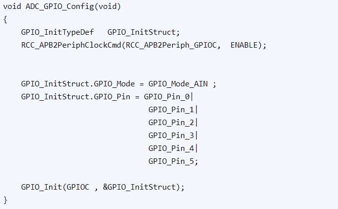

' V6 k! ?5 N( z1 W引脚配置9 ]7 }$ F% N; P- H( z9 B
引脚配置的时候,将所有引脚一次性配置好,过于简单,不作详细说明。
1 S5 A: @% w3 ], S" M
  1. void ADC_GPIO_Config(void)
    / C. ^9 d, L+ \9 v
  2. {. k4 T0 w/ R- }1 o
  3.         GPIO_InitTypeDef   GPIO_InitStruct;
    " Z! {' Y( D/ F/ ^" L3 ?/ X
  4.         RCC_APB2PeriphClockCmd(RCC_APB2Periph_GPIOC,  ENABLE);( M  ^. J" I, {. Z2 b1 _1 S5 n/ B
  5.
    + ^) @1 W2 G4 y: i& K
  6.
    $ |7 a# R/ U  I. _0 Q) F
  7.         GPIO_InitStruct.GPIO_Mode = GPIO_Mode_AIN ;- a( D5 L$ o6 G( {7 H
  8.         GPIO_InitStruct.GPIO_Pin = GPIO_Pin_0|
    " q3 {9 X7 z, k5 y- @: w
  9.                                                                 GPIO_Pin_1|8 {0 E* X7 Q5 u/ m5 P, [
  10.                                                                 GPIO_Pin_2|
      ~0 C, s% Y: p, I# Z! L; Y. q  Y# Z
  11.                                                                 GPIO_Pin_3|
    0 a. \0 Y' e  @) k
  12.                                                                 GPIO_Pin_4|
    2 p5 F  C' \1 V0 X+ m! T
  13.                                                                 GPIO_Pin_5;7 W" D  E; A$ [( \
  14.         " F5 Q- x/ P* |
  15.         GPIO_Init(GPIOC , &GPIO_InitStruct);" L# s/ B5 Q1 _* k, G8 B; K+ \
  16. }& {+ x0 j, R! \7 r# H9 G; J
