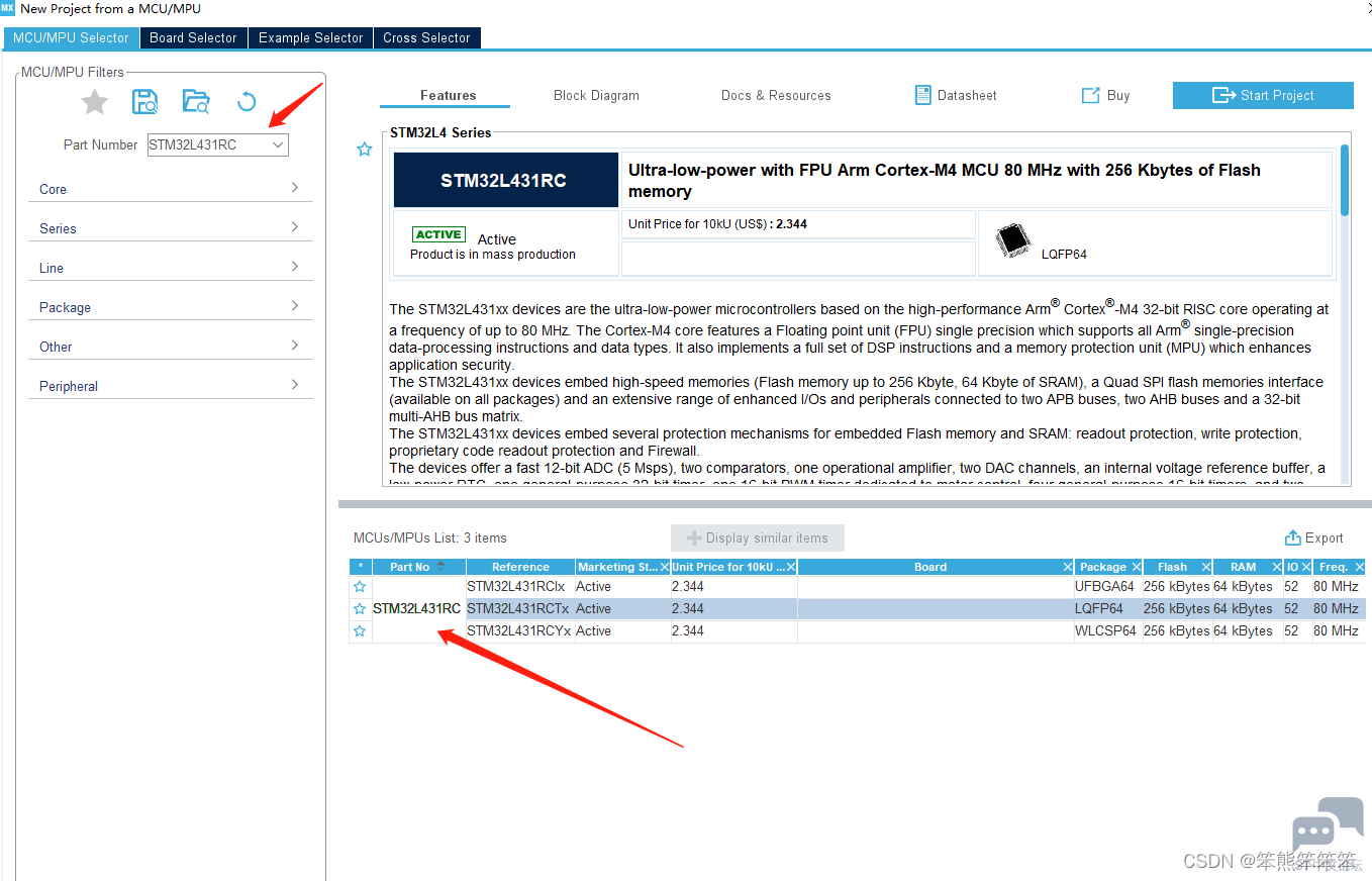

1.使用STM32CUBEMX创建工程
! @. d; f3 g8 Q( P7 t4 Z+ b挑选MCU:
" `; X3 r2 h# ?0 h/ ~& {& w5 X& v. f

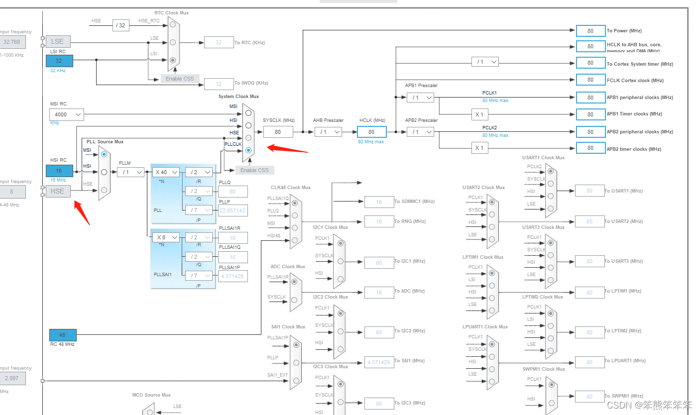

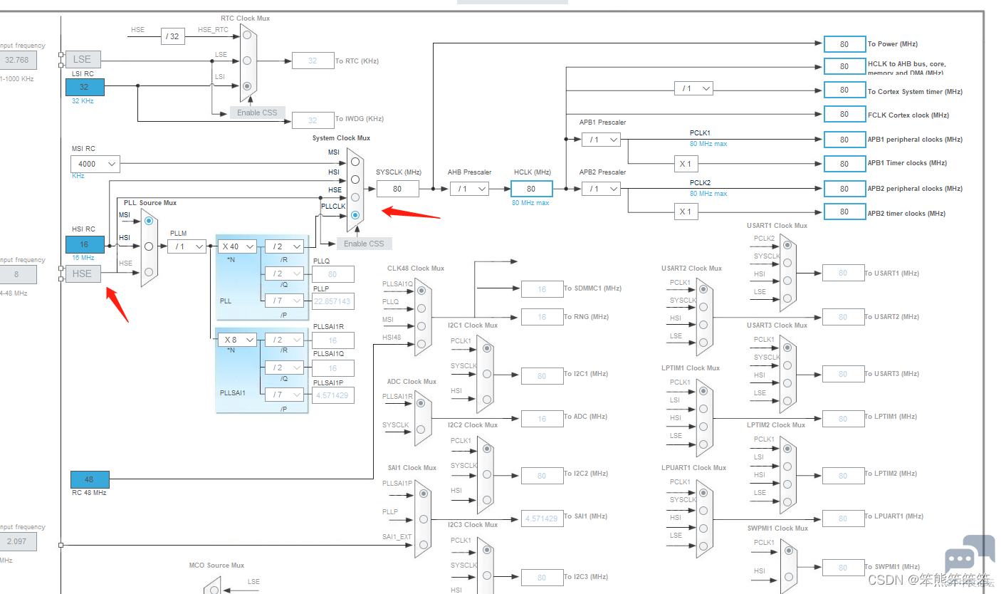

$ c/ E+ W" g8 `% G6 v7 f0 P配置时钟:& N! b4 j' z7 L
9 V3 z- F2 ?) g5 v0 C
! N! Q/ f# H4 d% q& m( O& Y# D' E. r8 d' d

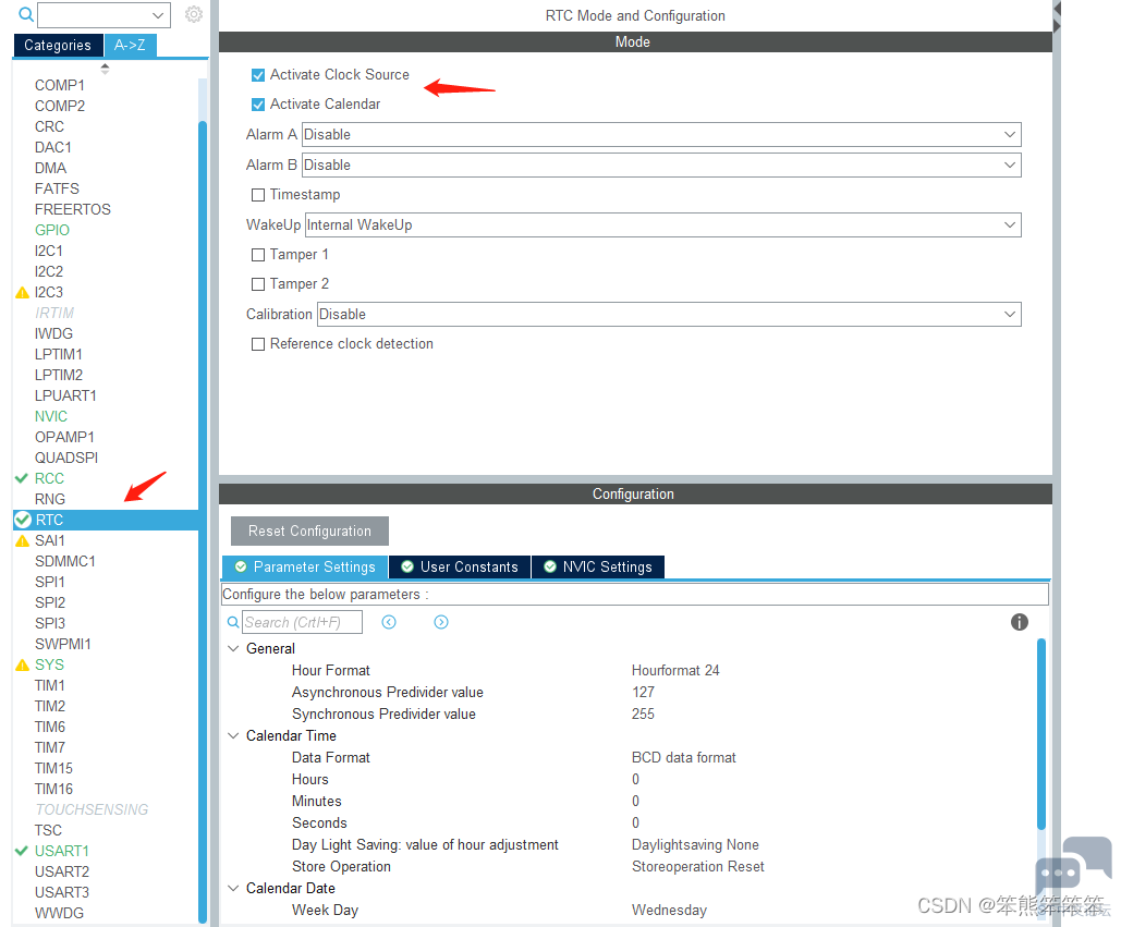

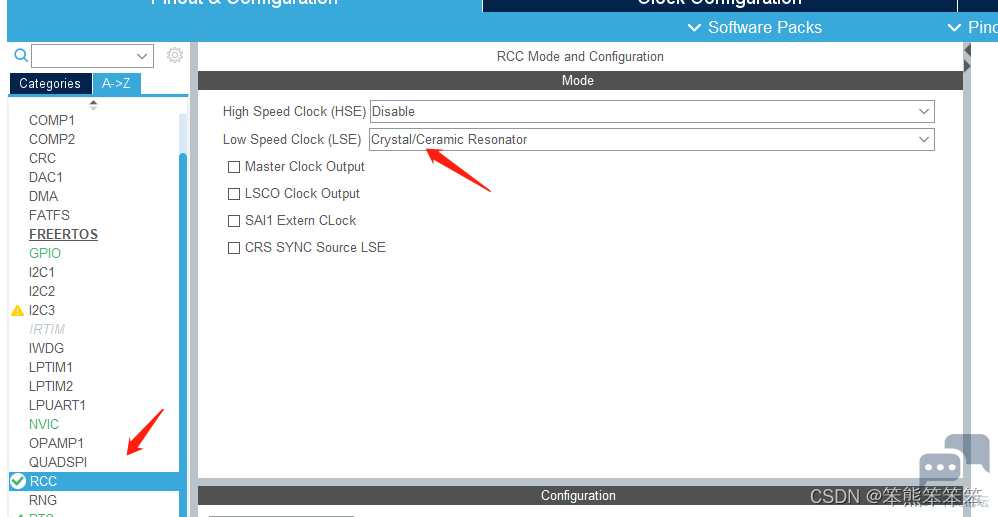

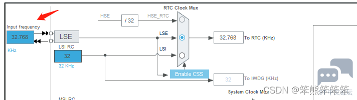

使能并配置RTC时钟:
# _) b; F4 B; }0 }' q6 q7 O* {' ^0 m1 N. c0 h' y3 w0 b3 q2 f
b5f54d9ee0ab419088f29461b4d609cf.png 7 b- C: N4 Y1 U5 P+ T& s
646822957cb54b8eab3b01147ec47218.png ! c  Y2 L9 _/ z/ W& _* J
- _( B" t, i) x8 Q+ r* B1 l% P

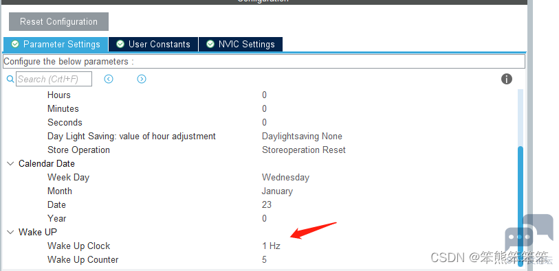

使能并配置RTC时钟:; S; o! _" |, g; B# h! u1 R# ~
6 n+ h: ?6 W% S7 q/ }. [$ R
5ba19984f0874bb3afcaf6d884e8948c.png * A/ s7 ]# @( T( M  V: a
6 D% b9 @" I6 g  O
abf351801a1b4922857cf765e5145d90.png ( ?' Q& X: q9 q, [- k% O

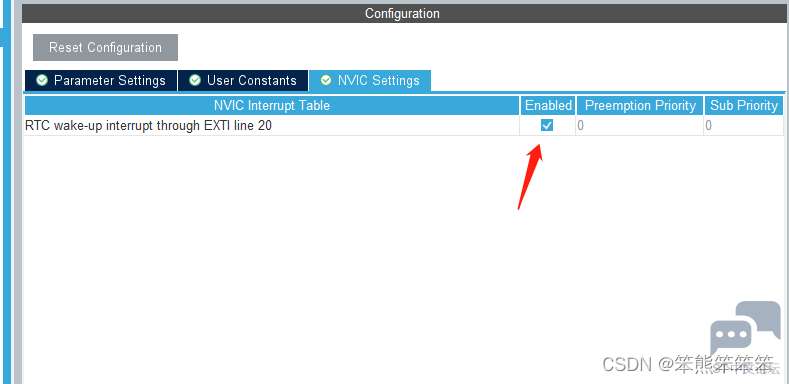

" S7 W+ A3 N% D这里是5s唤醒一次: q/ V" M3 M9 c
$ _- s" W( E% n9 e/ M; G6 Q
e3fbeb816e6c478cb262f79a2566f479.png 4 }0 w& {' o" ?' _
7 T0 T1 F3 a+ v$ I; x
3 t, `# o5 t- v) x使能中断: C0 k* C& n+ ?! R. {( E; _4 \; }

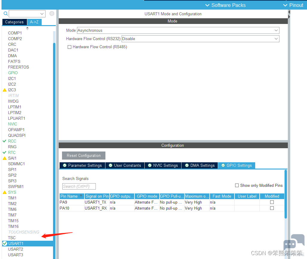

配置显示串口:
! q, [7 r" J( ?- X* m0 R: a8 z- q9 R  F# h, ?* E8 s
818c0943e43a4181b10c49d21b1e4628.png $ q- C$ Z! C" R7 y3 g( Q! |
" e: w9 m9 ?; k3 s- F! K: Z
% h; k7 S$ Y0 E! ^& \2 J
配置串口无中断" [; L) `' c& r2 C: Z

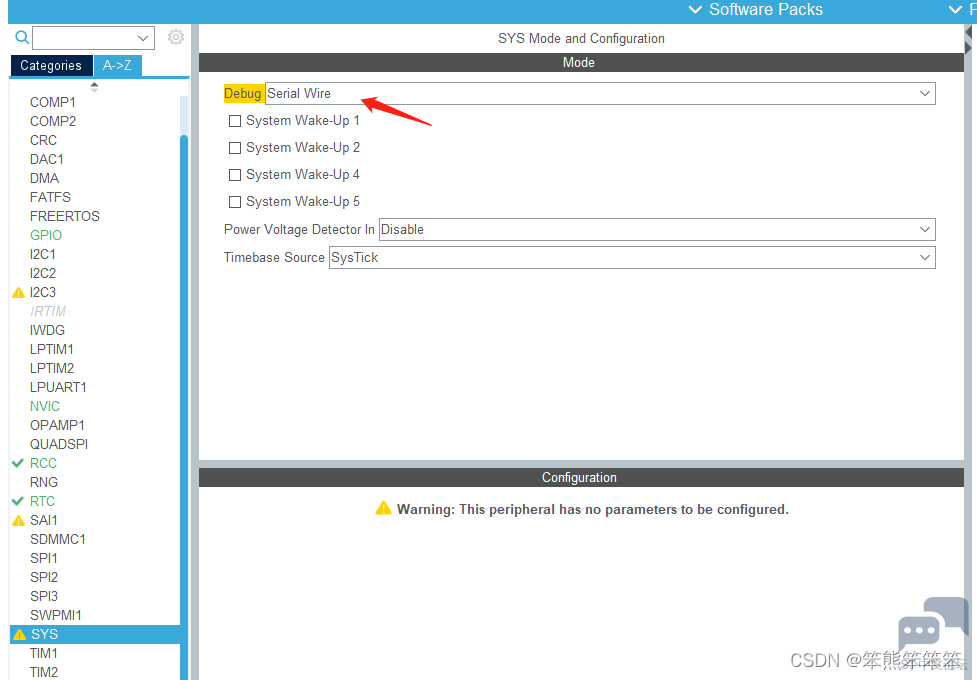

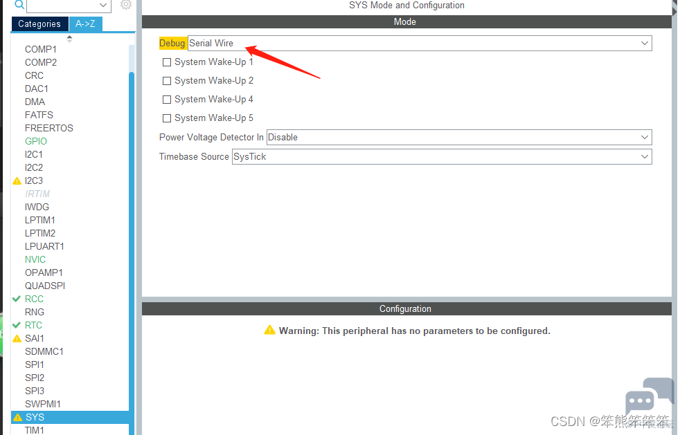

; a  o: X2 a( h  P配置下载口:
/ V) e$ b3 h! t0 D0 s5 R  V. Z- y+ b% h( \* @# P
  A$ X7 K/ A+ @  {' s/ q. {: T
; `' r& V) y/ z& |+ O! T9 e 111e52739da74b16819ac05cff75ebe6.png / J, q2 c1 Q/ P+ |0 D) y0 }
. U1 R4 J. d. ~: D

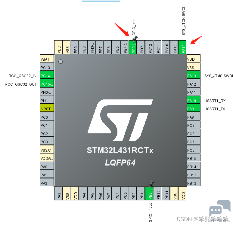

4 D( ~; X2 X5 Z& C0 ?: ]配置下载引脚,具体你要选那个视情况而定

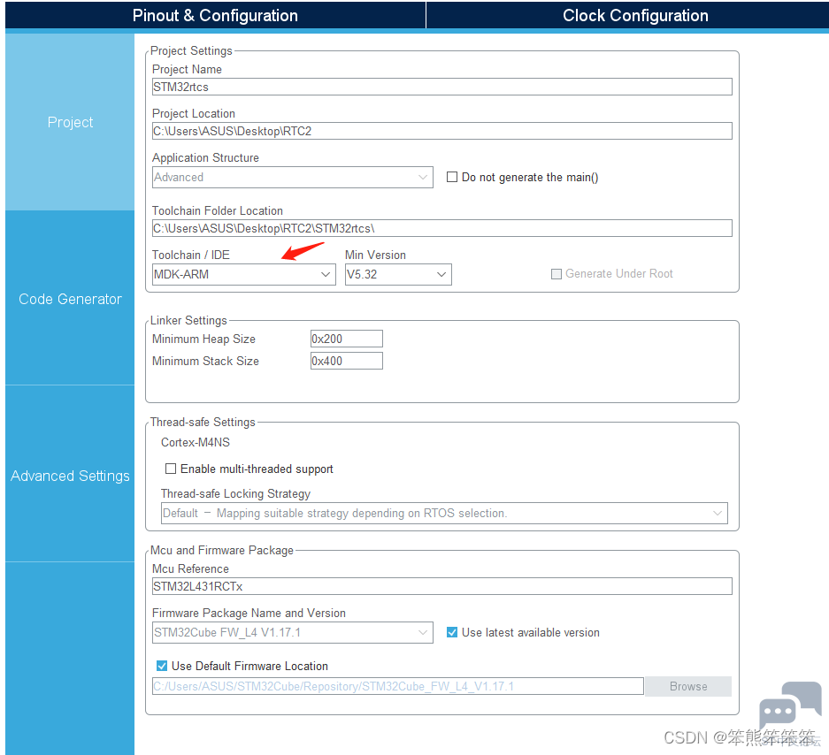

9 z/ y3 p+ _: n7 Z6 ~5 A+ E! X) h配置工程编译环境:
  d* O! v5 j# @: g! z+ N7 g6 T
% D# J1 h7 w: _1 q; Q( {% V' P
6983153a56894ec2bffaa7ccf152740a.png / R; c5 s% F. J# S5 L9 e& M
" U% p3 |! d5 R( o% n) b

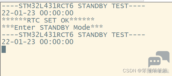

0 c: E3 o3 o; G3 ]6 b3.演示结果
  T+ N- M3 Q$ g4 _  O- H# x- E! h) ]3 u" Q上电正常现象
( ^( D" [. ^3 n
+ f& }( Z9 r/ V, g; F( ~4 P' N! r
, c' r. K# V9 B3 p3 M+ p2 R
/ h" |: g' a7 @2 o1 _# M! C- R

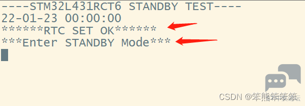

按下进入待机按键,5s出来- ^9 I! O& K: M! \8 H
% w+ `% \9 f5 r) a
2218de33f5594b94b864f17eab310ebc.png ) E% v( m0 ^  k: E, I- e! f/ \
' w5 h. t8 }% H4 ^" i( U* z" G; Q6 y5s后CPU唤醒,程序重新执行1 b1 V- e$ J' d3 m
3 b7 W& w" h- N) O; q
