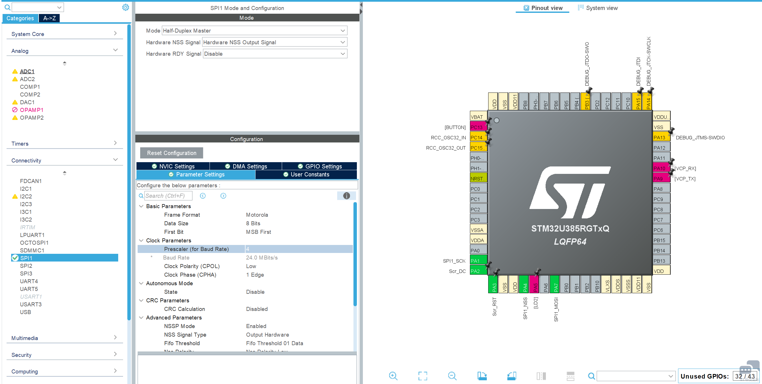

一、建立工程
通过Nucleo板建立工程,并打开SPI接口,设置硬件NSS(硬件CS)

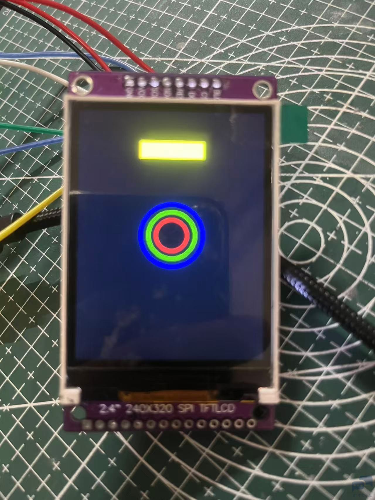

2、在main.c中加入简单代码
#include "ST7789.h"
int main(void)
  LCD_Init();
  LCD7789_Fill(BLACK);
  Fore_Color = BLUE;
  LCD7789_DrawCircle(120,160,20);
  Fore_Color = GREEN;
  LCD7789_DrawCircle(120,160,30);
  Fore_Color = RED;
  LCD7789_DrawCircle(120,160,40);
  Fore_Color = YELLOW;
  LCD7789_FillRectangle(80, 40, 160, 60);
三、效果
